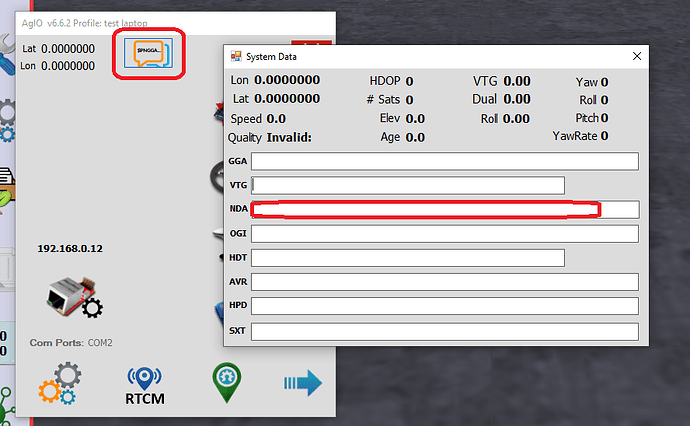

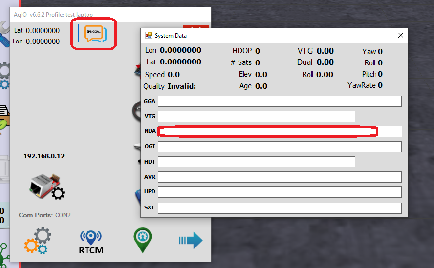

Yes, it should. You can see if you have PANDA the sentence here:
