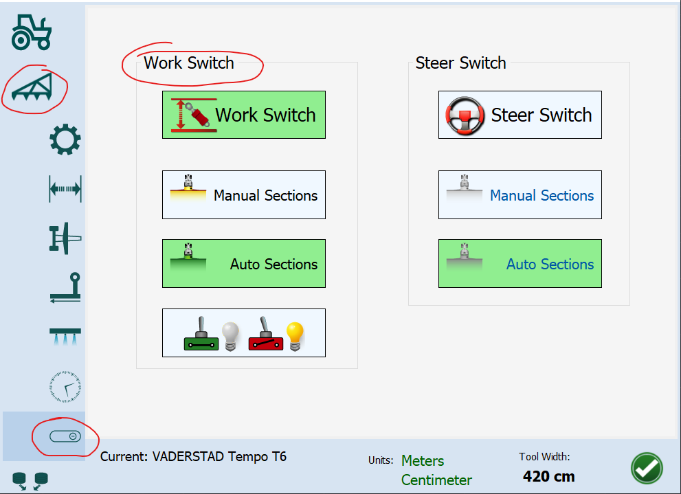

Is implement switch wired to AIO boards work switch?
If so, these settings you play with…
Yep! Those are the exact settings I have.

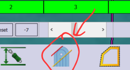

Or mark not to apply in headlands (i have not tried this yet, screen shot is applying in headland)
