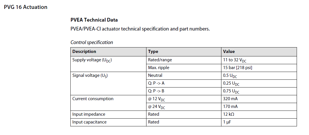

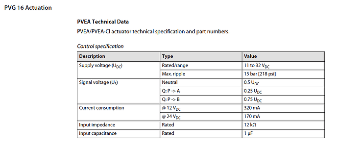

Ok this is the specs of the valve, can you tell me if this is going to work?
Looks the part. Any choice not to use a baraki valve? Works well.
Does baraki offer ls? I can’t get a hold of him.
This kind of valve is referred as “Danfoss” on the forum.
They can be controlled by the AiO board, without Cytron.
UDC will be around the tractor voltage (13-14v)
And I would add that this valve will probably give a better performance than a Baraki since it has onboard electronics.
