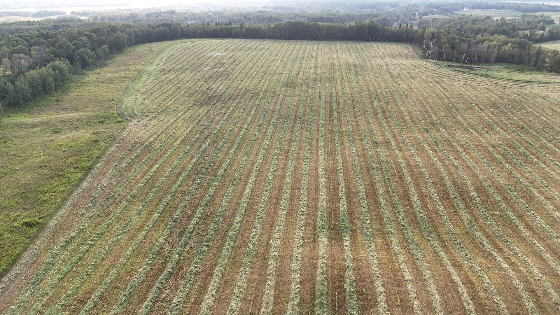

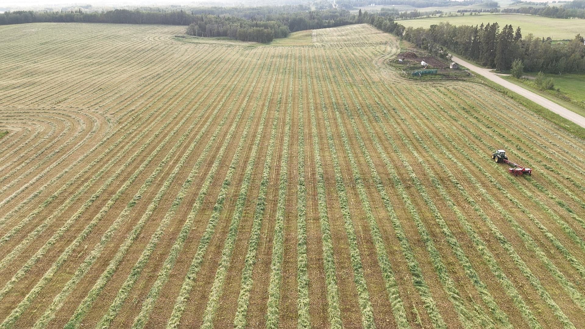

First field using my own RTK base for corrections and cutting with the Hydroswing. I couldn’t quite figure out the implement setup for proper painting on the screen as well as U-Turn lining up for the next pass properly. Does anyone have a good implement configuration for a Hydroswing? Overall very pleased. Yesterday I could cut at 13km/hr with no misses. Still some issues with the tractor not being right over the swath, not sure if its antenna offset or the discbine distance is different on the left or right side of the tractor
