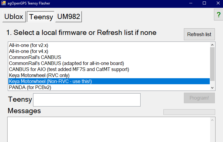

Before, the IMU worked perfectly, but after updating the Teensy software through AOGMATIC V2.0.0.14, the IMU stopped being recognised. I tried an older version of AOGMATIC that I had, and the IMU started working again. In case anyone else has this problem, I’m leaving it here.
The version I installed is this one.
