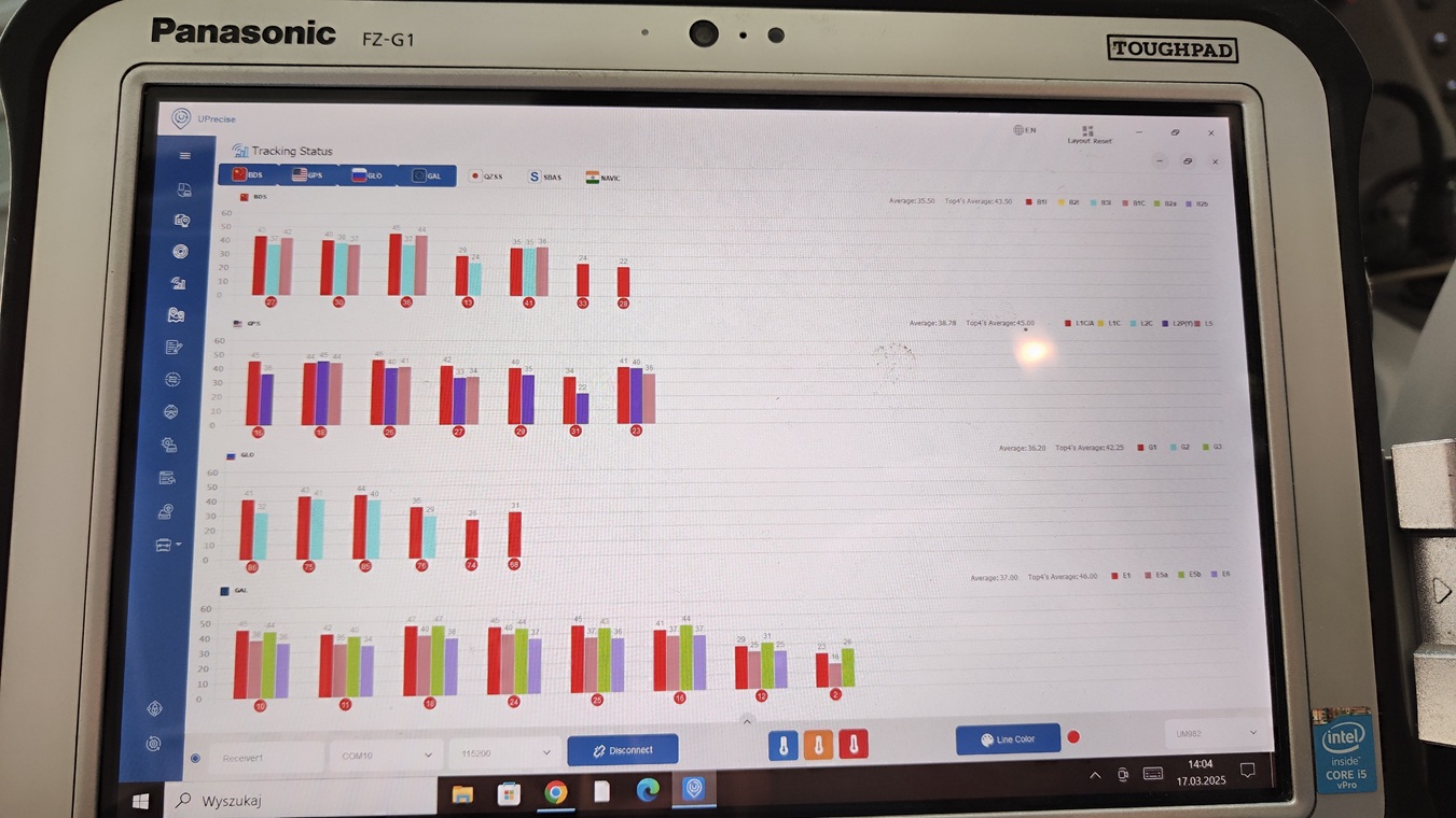

I have test it on um980, when i change from 4.1 to 3.1 all satellite work on one band only
They plan to release sometime in 2025, still several months of work!
Have you tried 4.11?
Yes, if i use 4.11 all work, all constellations and ppp

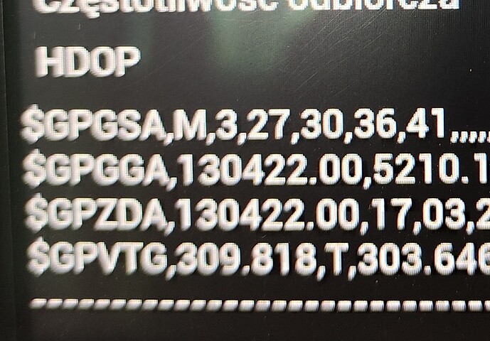

I’m sure the Tellus won’t be happy with GNVTG… it wants GPVTG
$command,CONFIG NMEA0183 V411,response: OK3B
$command,CONFIG NMEA0183 V410,response: OK
3A
$command,CONFIG NMEA0183 V31,response: OK0D
$command,SAVECONFIG,response: OK
55
$GPRMC,212256.20,A,4735.89061690,N,02003.60741944,E,0.007,119.2,060325,5.6,E,A3A
$GNVTG,119.205,T,113.648,M,0.00719,N,0.01332,K,A
36
$GPGGA,212256.40,4735.89061906,N,02003.60741399,E,1,21,0.6,103.9143,M,42.8411,M,60
$GNZDA,212256.40,06,03,2025,7C
$GNGSA,M,3,01,02,03,04,09,17,19,28,31,1.2,0.6,1.0
2F
$GNGSA,M,3,70,71,72,80,85,86,87,1.2,0.6,1.0
24
$GNGSA,M,3,07,08,1
V31, gpgga, gpgsa, gpzda, gpvtg working with amatron.
