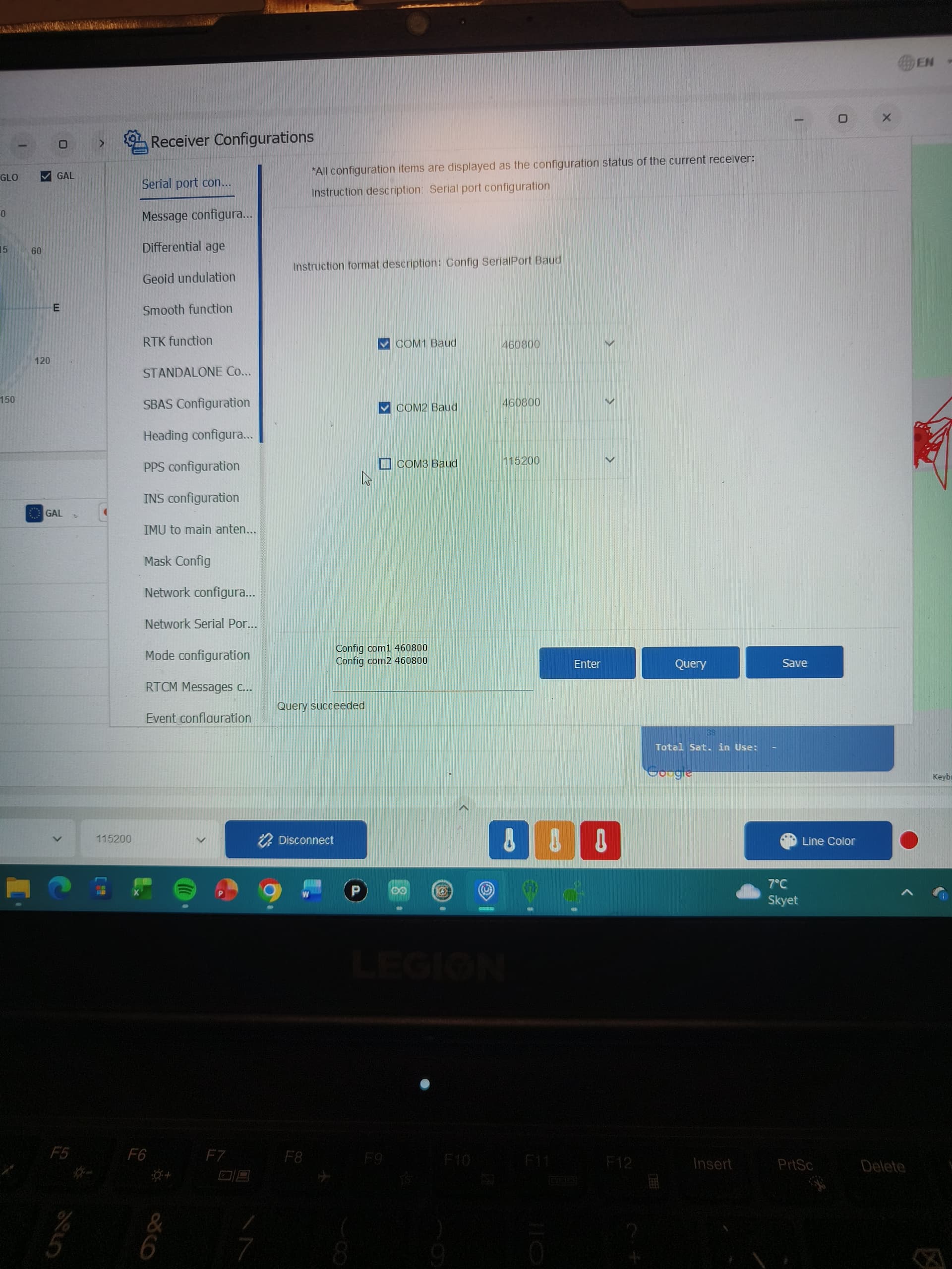

Set com1 and com2 to 460800
Leave com usb at 115200

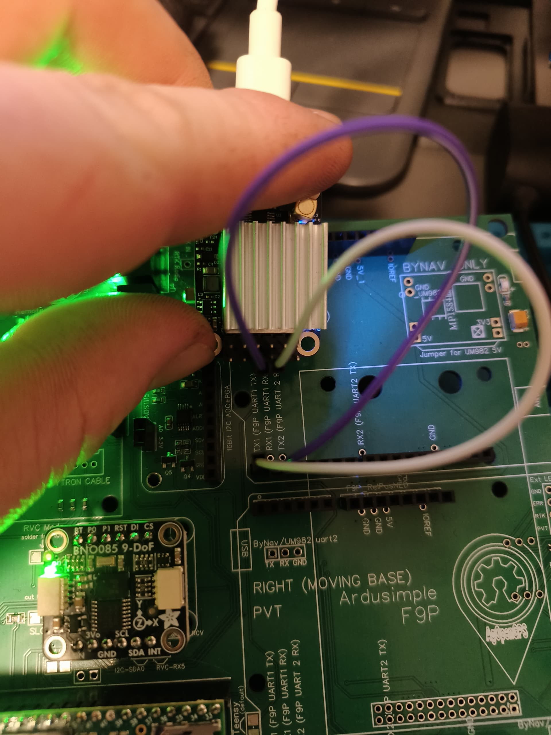

Cant quite see but rx to tx and tx to rx
Blue is tx on um and Rx on pcb
That should be ok
Now double check your configuration
If you put 460800 on both com1 and com2 it won’t matter which rail your using on the um982

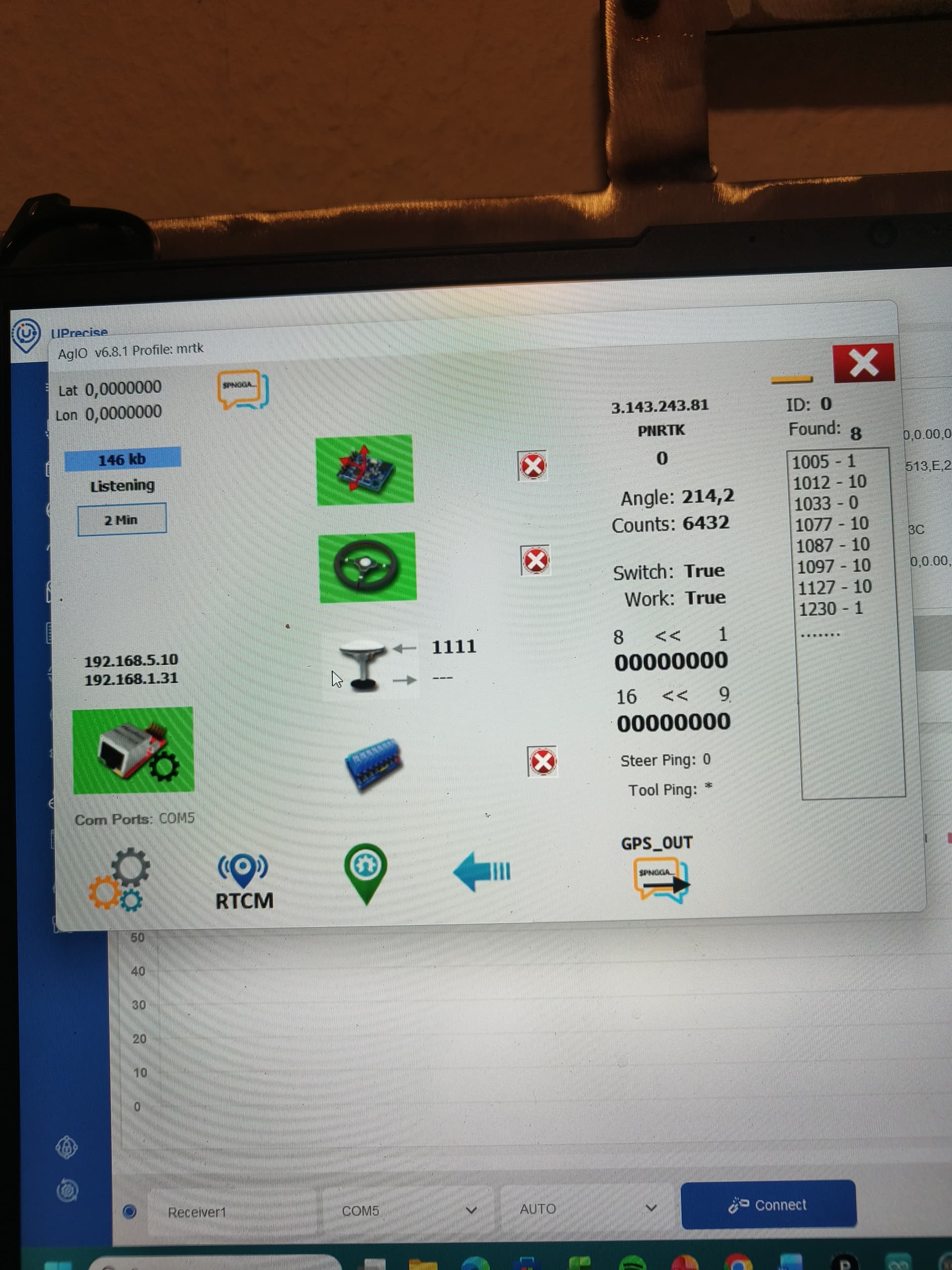

Still nothing showing up

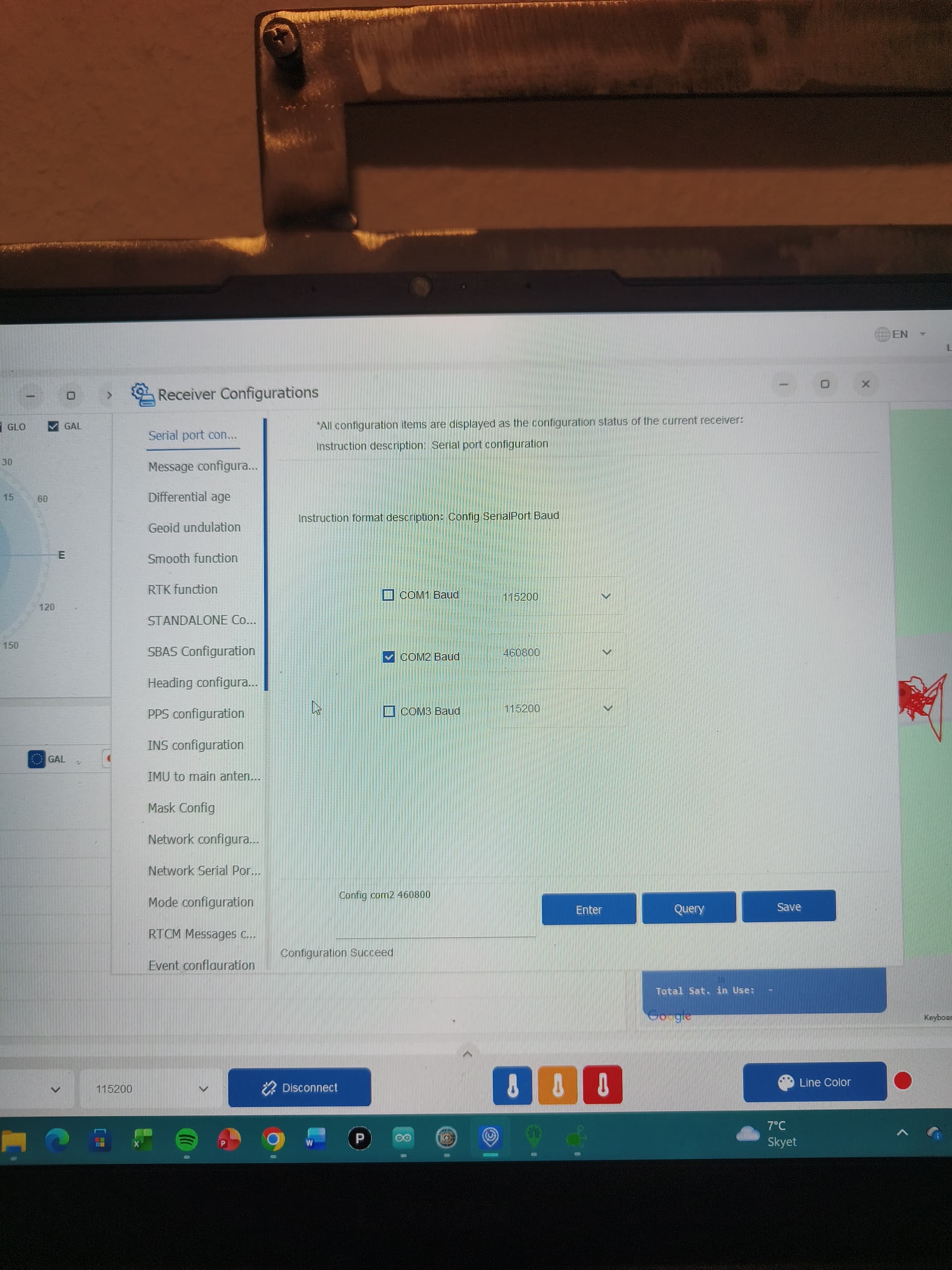

Have you done a complete freset 1st?
You can use configomatic to program it for single gps use
Yeah did freset first, will try configomatic
Double check your rx tx wires and try swapping them
Also try changing to the other header pins on the um982

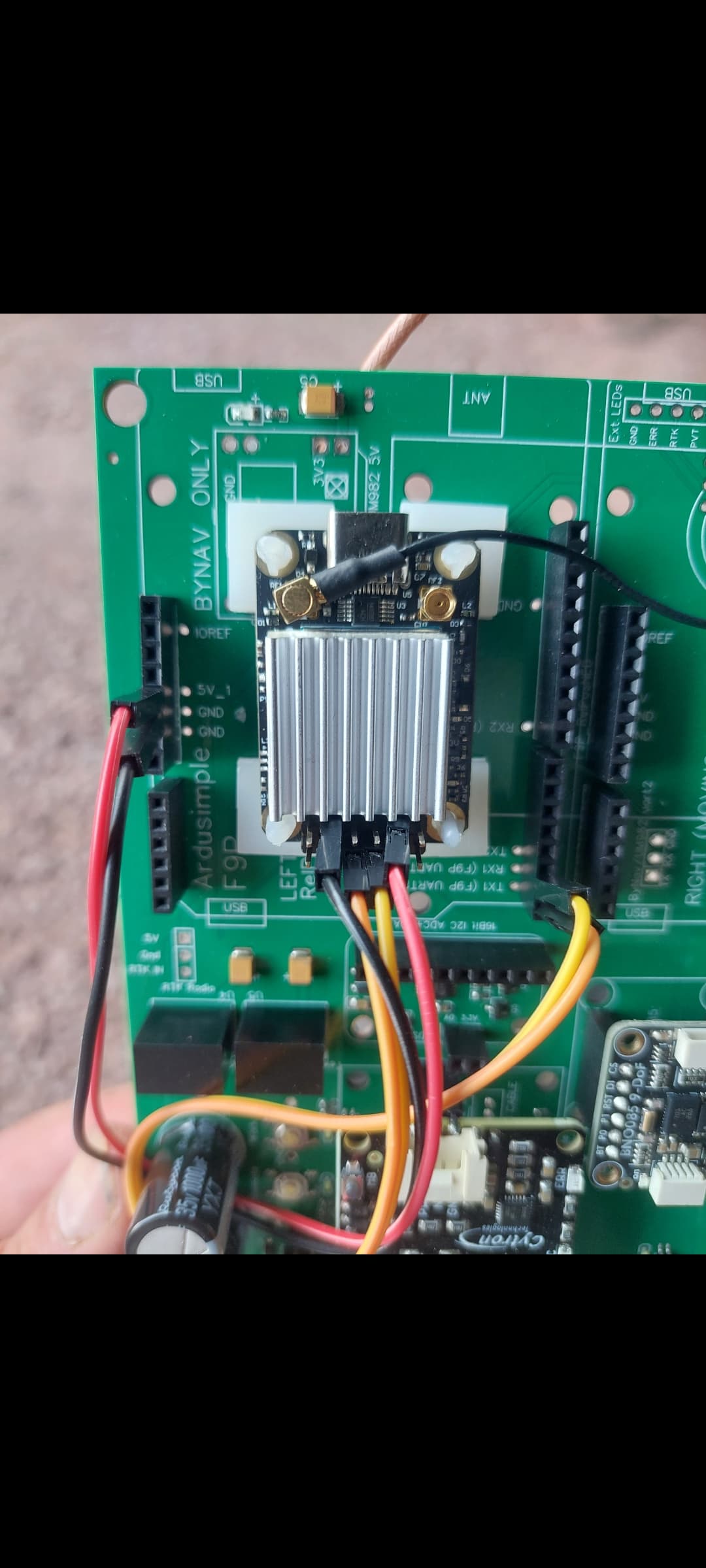

Still the same, I can easily connect via serial and connects instantly, so it must be something wrong with wirring, will try to sauter on some wires directly, is there another place to wire in to Rx and tx?
Aio standard board
Try the thread creator teensy firmware GitHub - chriskinal/AOG_Teensy_UM982: UM982 specific AgOpenGPS Firmware · GitHub GitHub - chriskinal/AOG_Teensy_UM982: UM982 specific AgOpenGPS Firmware · GitHub and kskt intead.
Make sure to pass ksxt in the firmware. Set the um to send kskt intead.
Hmm don’t remember checking ksxt, that could be solution, just enable it under messages to 10 Hz right?
Ksxt only for dual.
