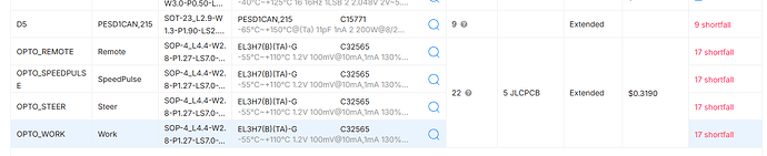

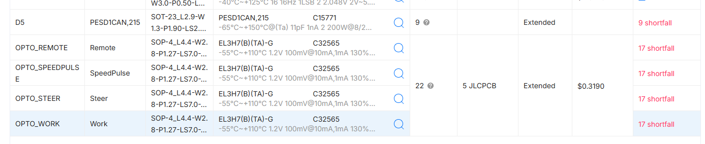

Where would you source led’s, as JLC don’t seem to have any?
I’m having the same issue, no LEDs. Also, what do the exclamations marks mean? The quantity of parts don’t seem to be matching the BOM csv file? Sorry, first time I’m doing this, I know these are probably elementary level questions.
Mainly it is just wanting you to confirm the part on the ! ones I believe since there are multiple options that could be correct. Usually it should be right. One of the things you can do is confirm that it looks right on the board on the next page. If things are hitting holes and contacts right usually you should be fine.
Shortfalls you can usually just hit the looking glass and it will show the selected part specs and usually there are alternatives that look exactly the same that are also listed. Often if they are chips the numbers will be the same on the chip and they are just a different manufacture. I just suggest checking the specs and try to find the one that matches the closest to the original one.
