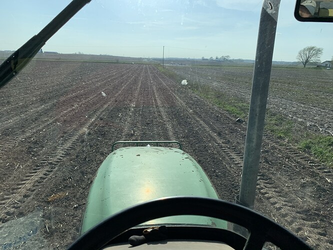

The results were impressive. I expected the system to be quirky and have little glitches and issues that would inevitably come up as this was not a “commercial” system. I was astonished at how well the system performed. Hour after hour it ran with out issue. It maintained RTK fix at all times. It performed amazingly well along tree lines. (I used the helix gps antenna from Ardusimple) The steering was quick, smooth and accurate. I couldn’t be happier.
