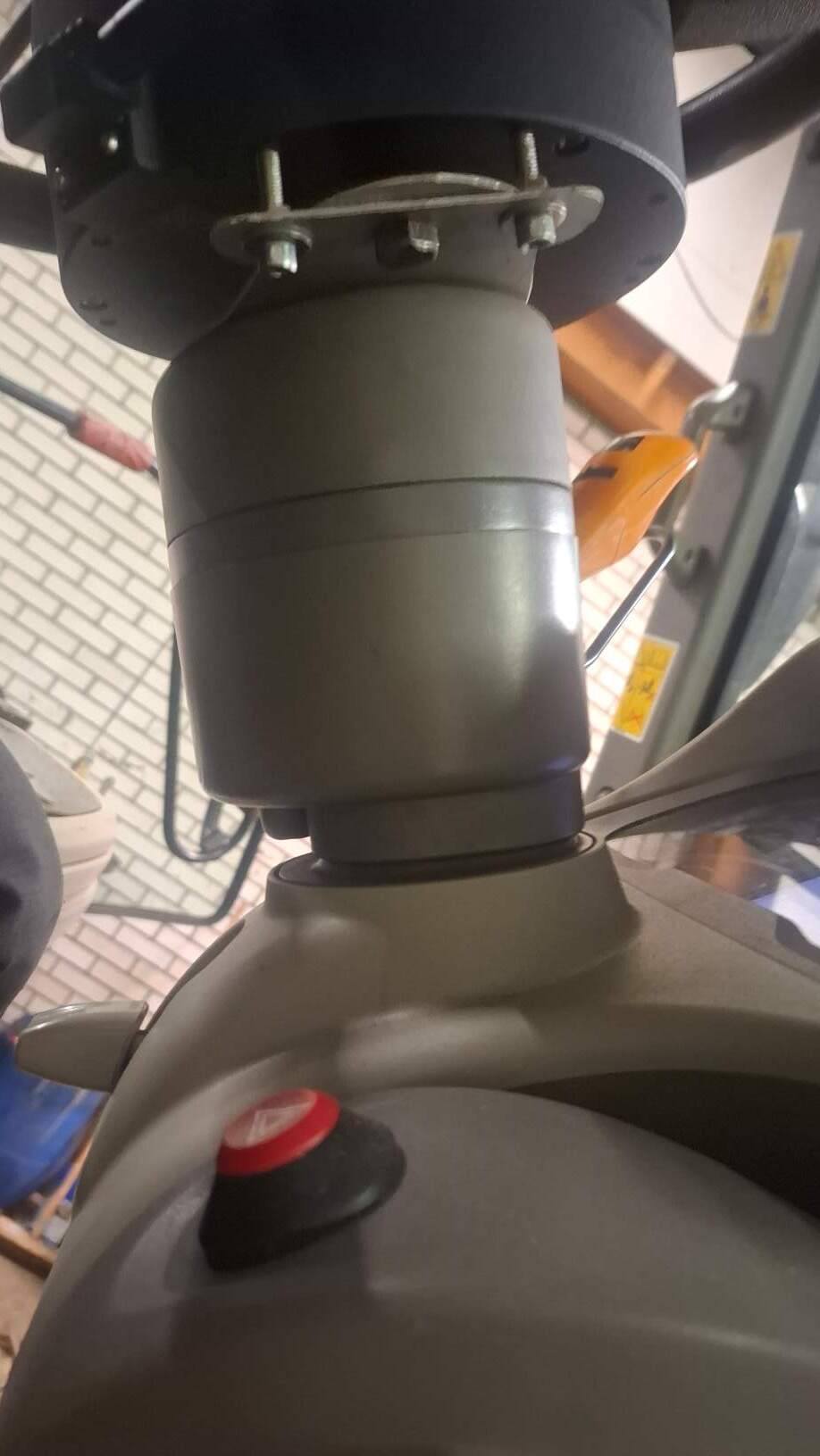

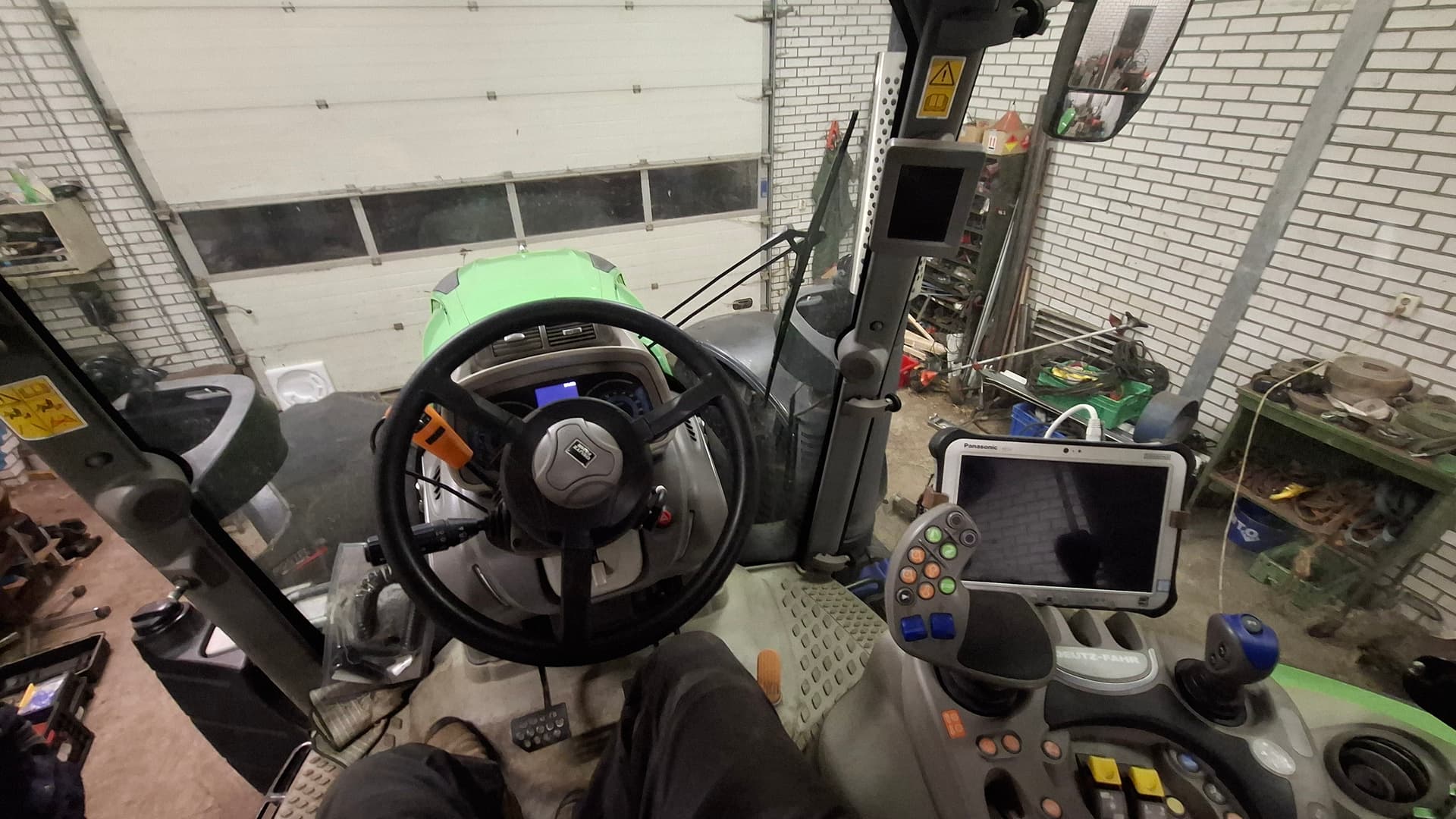

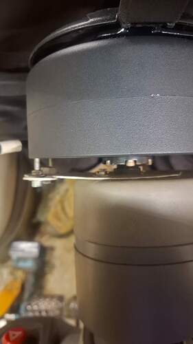

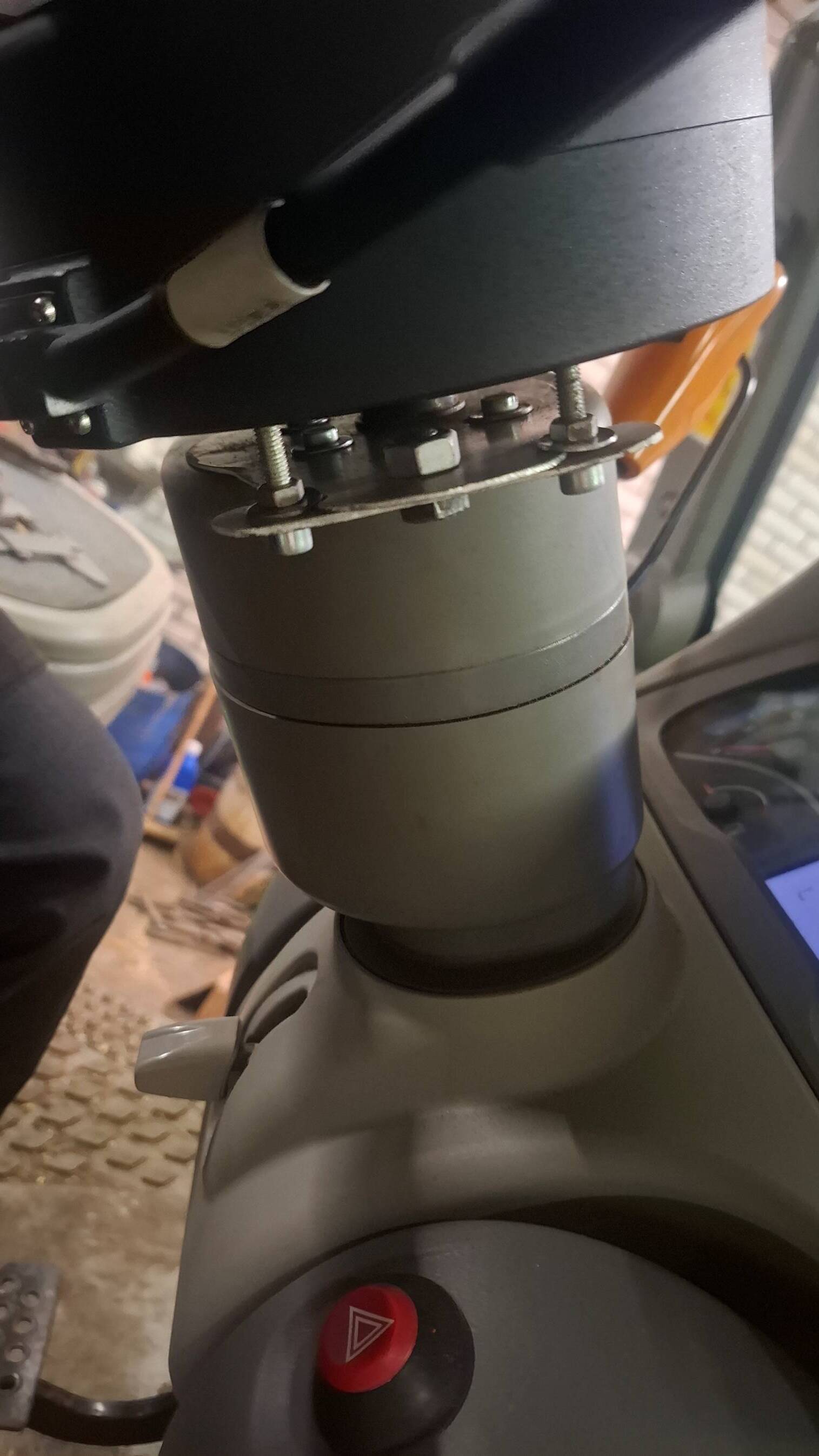

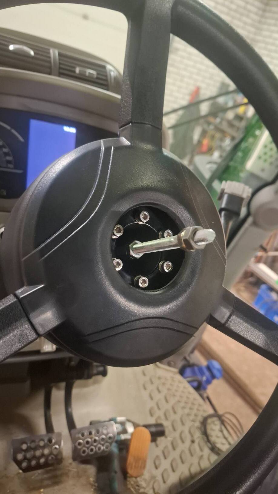

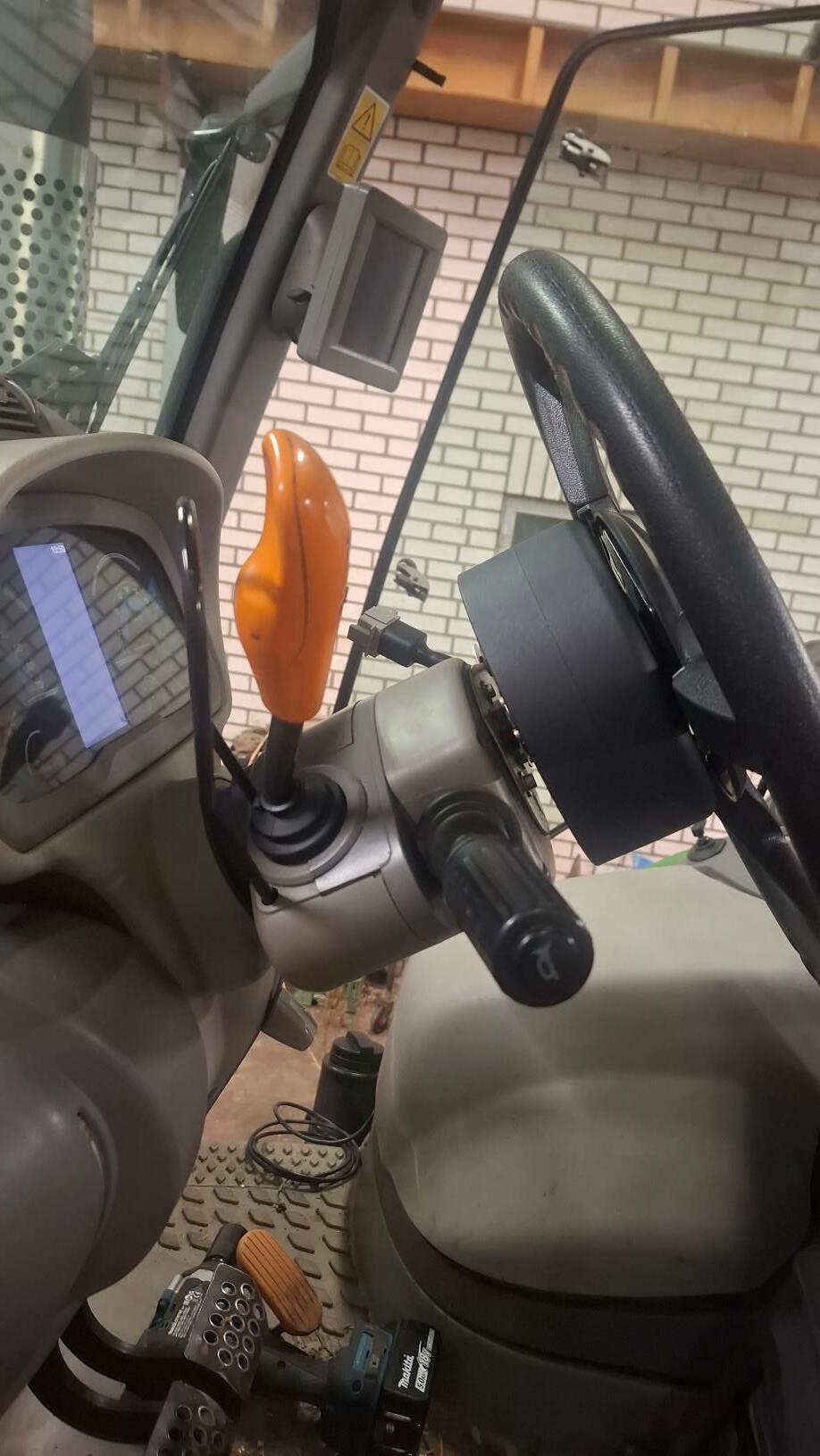

Hi all, I built a keya v4 motor on a 2018 Deutz 6185ttv. I made a simple aluminum plate that matched the bolt pattern of the indicator mount. I also extended the bolt for the steering wheel height adjustment and just put the original cap back on it to keep adjustability. It is a 100% revertable to original as i did not drill any holes.
