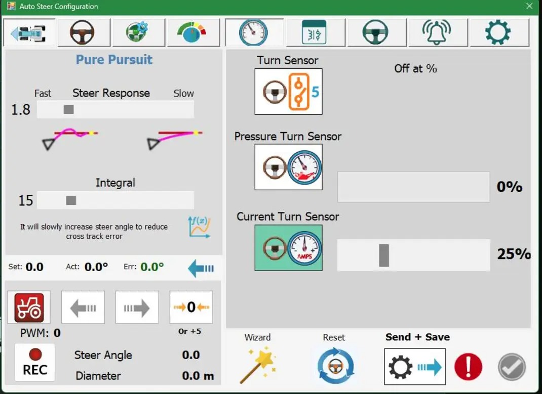

I have a Keya driver and a BNO085 steering angle sensor. Could any of you share the settings you use for this configuration? What settings should I use for the Gain, Pure Pursuit, and Deadzone parameters? Could someone advise me?

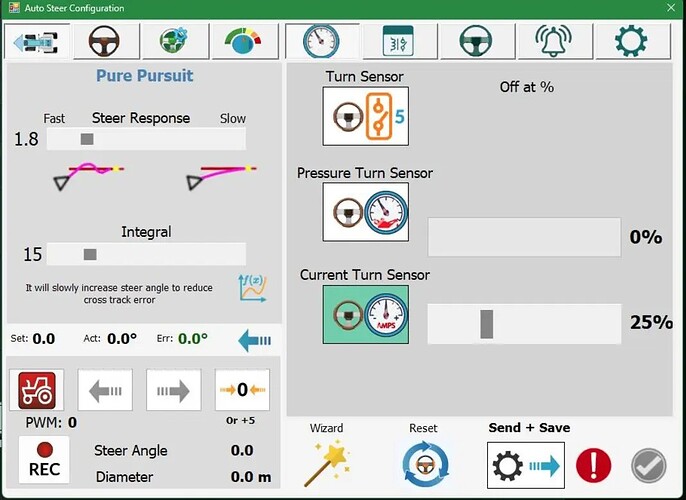

Try changing the Current Turn Sensor setting here. The lower the percentage, the easier it is to disconnect.
Thanks guys. That verified it for me. I had the WAS set up wrong when I first tested it, but ran the Steer Wizard again and was able to then tweak the Current Turn Sensor setting with noticable feedback (I found it had a nice disengage on the lower ~15% side, as I don’t have to really jerk the steering wheel to disengage then). I just used the settings @BGunics listed for the others.
