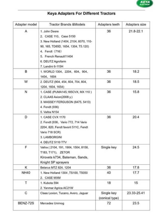

I might just be lazy but having difficulty with removing steering wheels does anyone know which adaptors are needed for the following
New holland T 6.155
New holland ts115
New holland tx64 combine
Many thanks

T6 155 i think its the same as the T5 140 i just got one and got the A

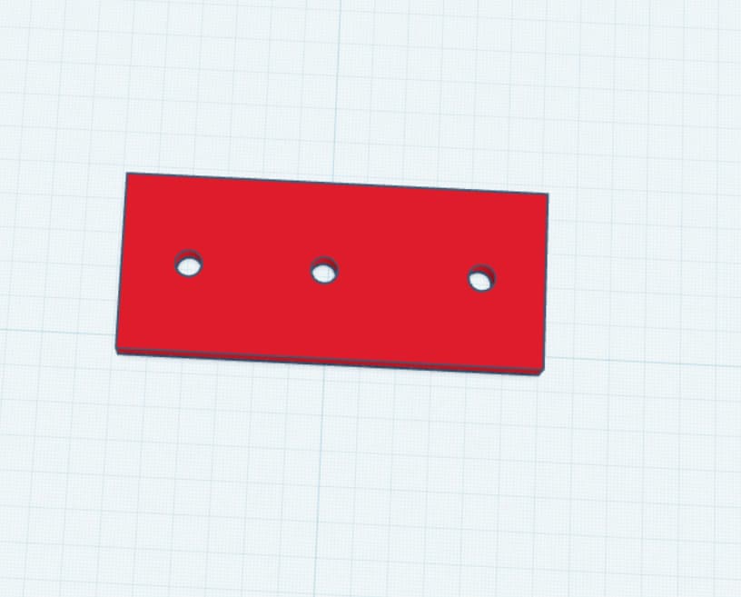

jus drill 3 holes on a plate the as a puler the bolts sould be 8mm
