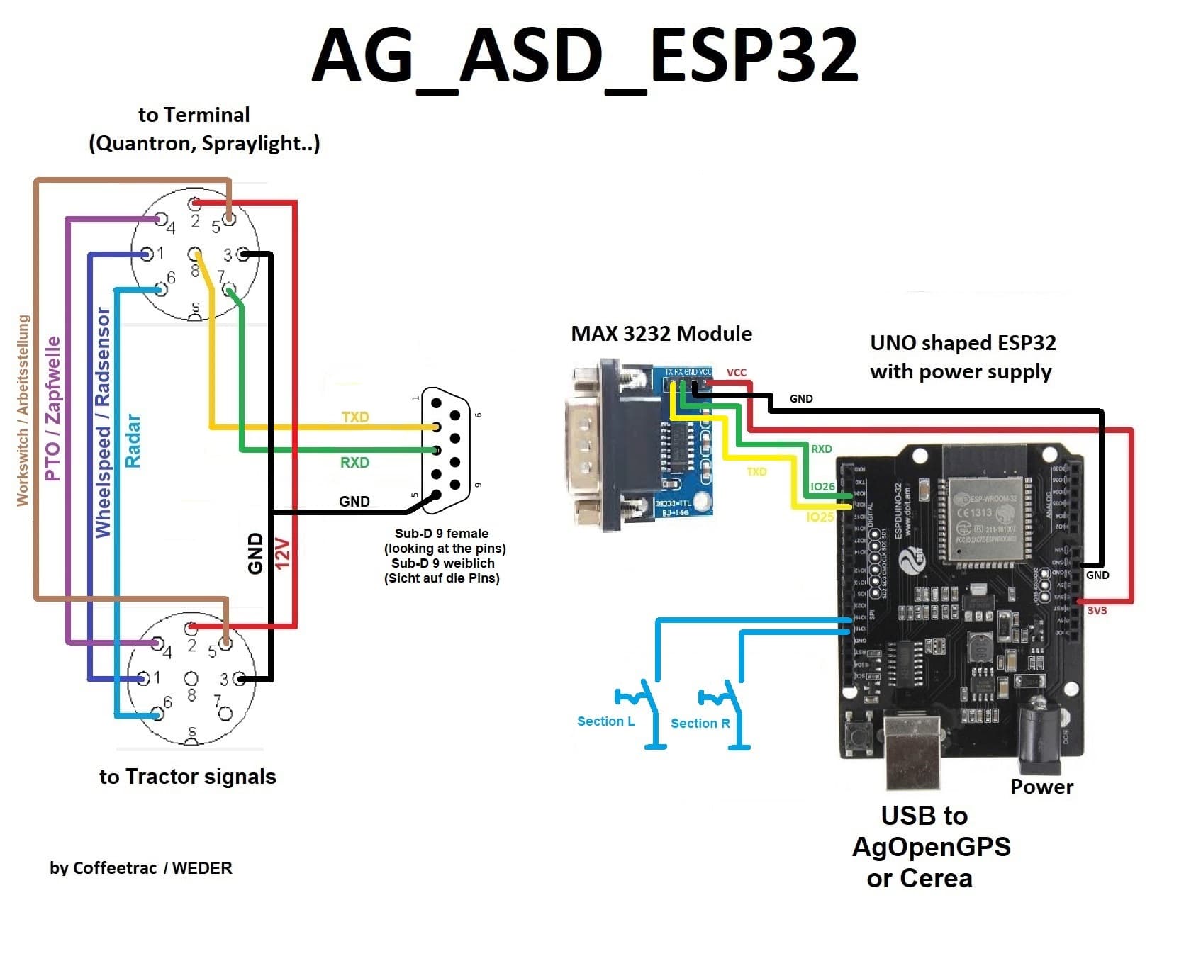

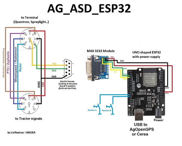

Feel free to try
What do i need to download to try this out?
The exe from the release and you need a USB RS232 adapter :slight_smile:
pinout is:
start the app pick the COM port and you should be fine (if UDP is enabled in agopengps)
