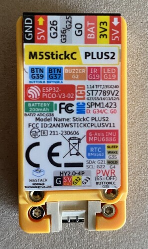

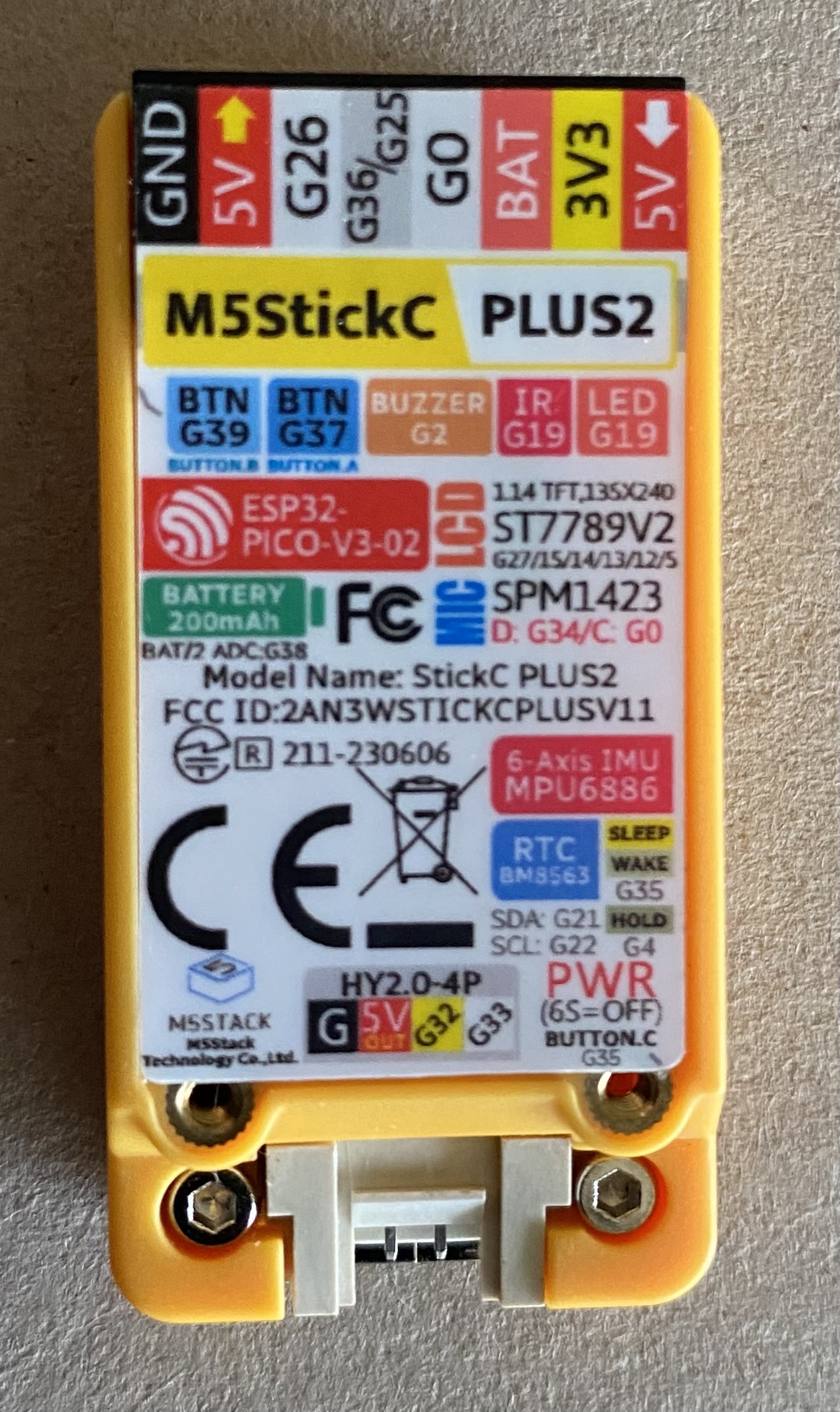

Here is the one I was using at the time. Front looks like Kents.
I have no experience coding apart from my current attempt to install chri5k’s lightbar
Finding the correct model would definitely be the easiest option , which in hein sight I should of been more specific in my purchase

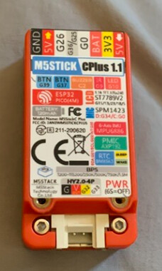

The older one (orange) is still available from M5.

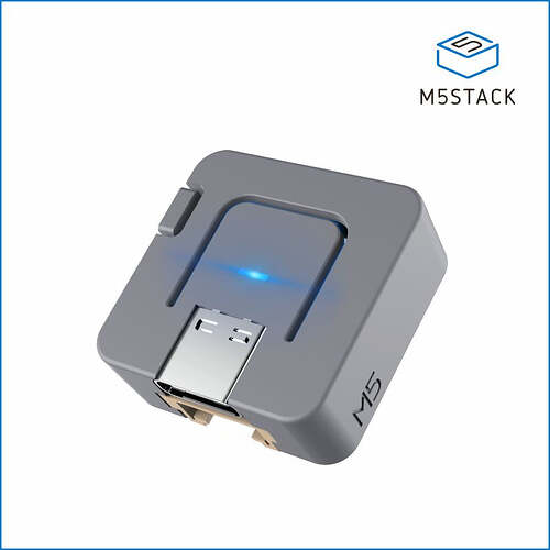

Mine was an atom lite, the simplier version
I had to adapt the code from the M5stick, using the samples. It was not very straight forward
