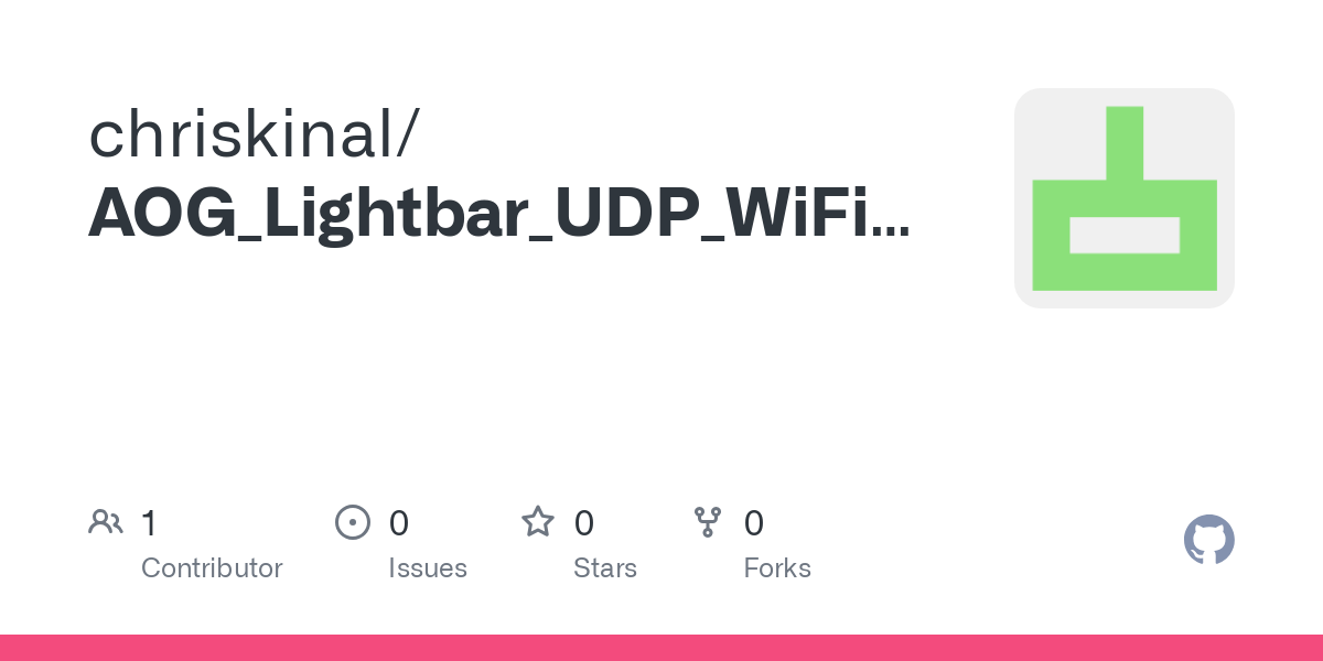

Here is some code for the M5. UDP over wifi. As is, no warranty or support.
