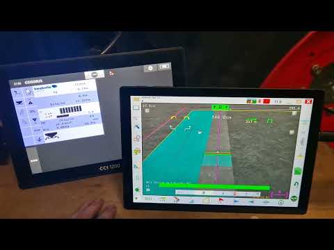

Hi, it’s ready now.
I purpose code for integration to AOG repo.
https://youtube.com/shorts/iA3AdDkYQR0
