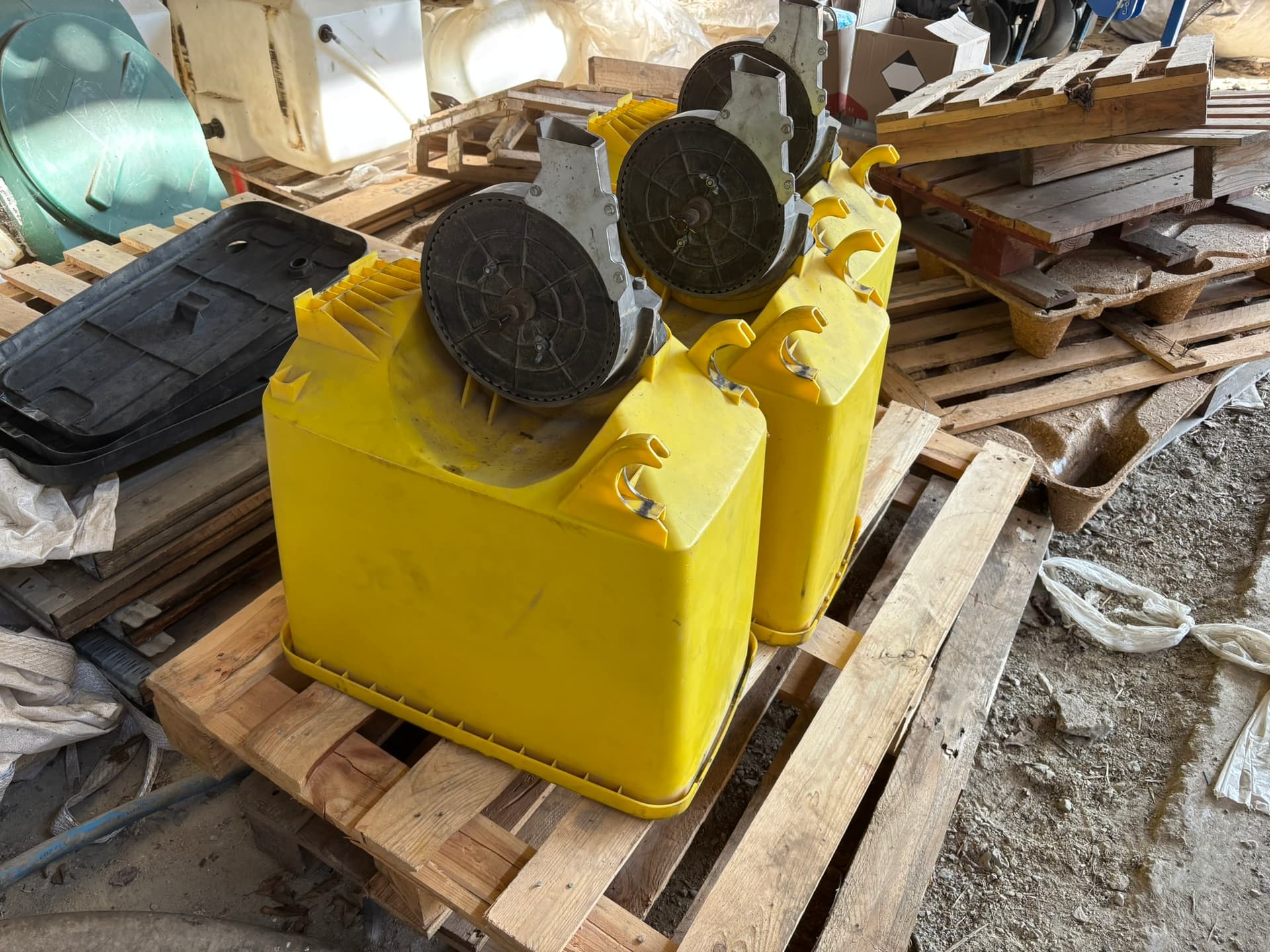

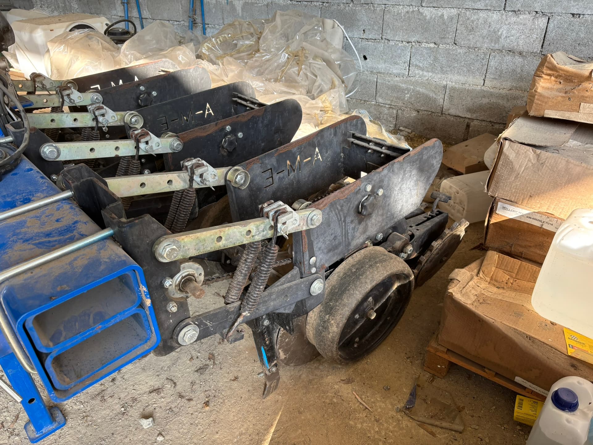

Hello, we want to build a mecanics american seeder (we have old part), but i don’t know where find parts to repair and buy new one…
I like this element because distribution does’t need fan and power. it’s very simple to equip at small tractor. and it’s for direct seeding.
Do you know the brand ? or similar part ?
Thanks !
Did you check John Deere parts (or clones)? I don’t know this brand but a lot of parts in your pictures look like JD parts.
It seems like it could possibly be an A-M-E planter. I don’t know anything about them, buy you could maybe try contacting them? Like @Pat mentioned, a lot of parts do look like Deere parts.
Yes, we have reshearch same part like JD but we are based in France and it’s difficult to find this part…
