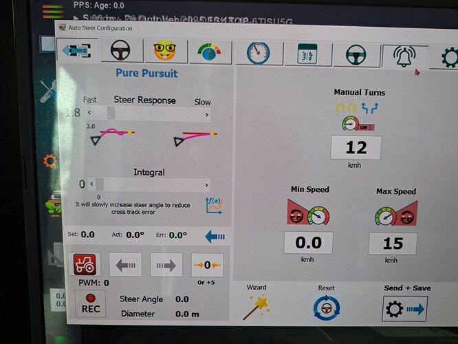

yes just set your minimum speed in the steer settings expanding tab
mine is set at 0 for hedgecutting so it doesnt disengage when i stop
Probbaly setting minimum gps step from 10 to 5cm will also help with very slow speeds
