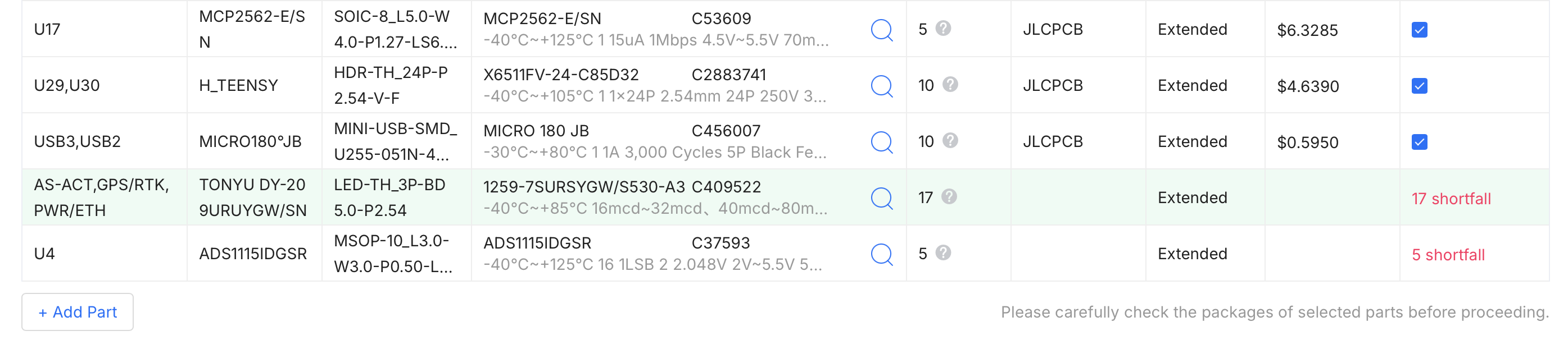

I am just trying to order a AIO 4.5 micro PCB from JLC, I have overcome most of the unavailable parts by using the search bar, however I am a little stumped but the last 2.
C409522 was originally the C459134 (found the alternative on here) but that is also out of stock. Would it be a problem using C459128 instead?
The second one is C37593, unfortunately also out of stock. I have come across C700177 and wondering if that would also fit the bill?
I hope I have put enough information in and it all makes sense.
Thanks Jack
For C409522 (C459134) → C459128 or C2895567
For C37593 → C2868291
Perfect thank you, I will get them ordered
