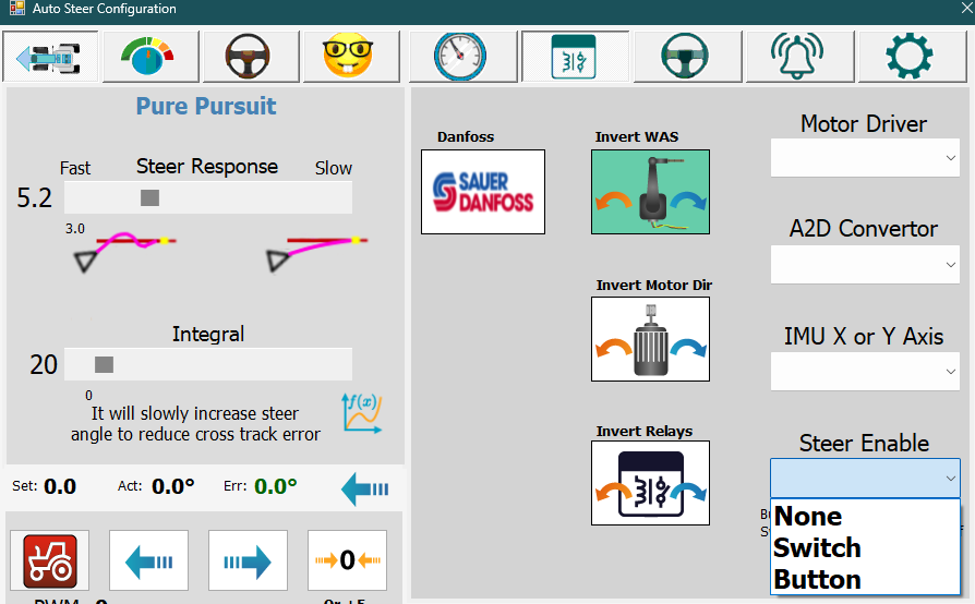

Set to Button
Thanks! I’ll take a look at the settings when I’m back in the shop on Thursday. I think that I originally had that setting on button but I’ll confirm. Thanks for the response.
Remember to click Send, so the teensy can know how you want to use it.
