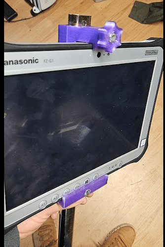

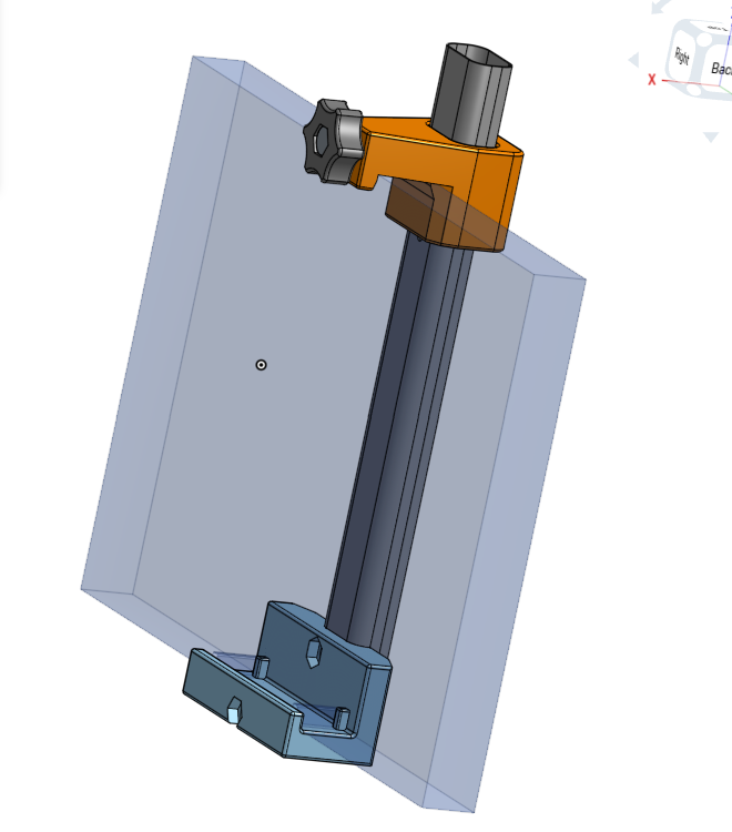

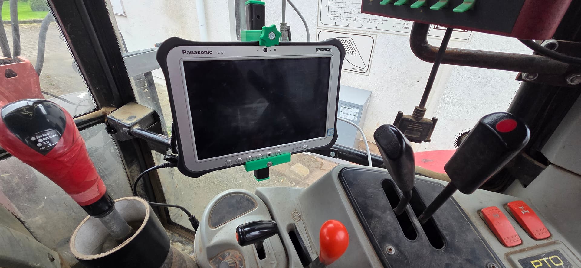

I have just created a mount system for the FZ-G1. It uses a hanging rail from a wardrobe as the main structure. The key feature is the two lugs in the base which lock into the two grouves either side of the multi pin connector on the tablet. I found this makes the tablet mount super secure. The drawing is available in the OnShape public files, just search for “fz g1 tractor mount AgOpenGPS” if you want you can make a copy from there and remodel for a different shaped rail e.g. 30x30 box. It uses M6 bolts throughout. I will upload the stl files here. FZ-G1 mount - Google Drive My daughter helped with the design I am teaching her how to 3d model so she got to pick the print colour.

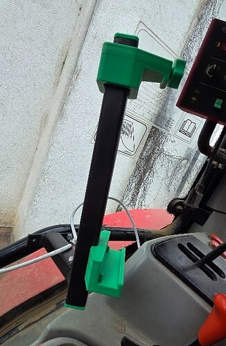

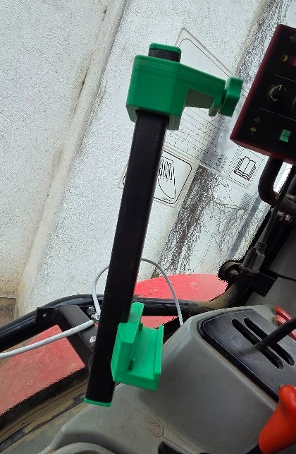

I have created another version of the tablet mount which uses 25mm box as the base material. I thought this might be more accessible to everyone and its easier to weld up a bracket.
STL files are available here
