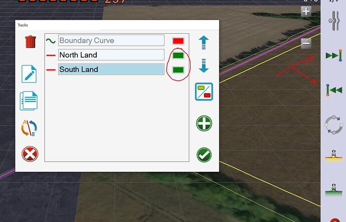

You can copy the track, shift the new track to where you need it, and then rename the new track. Then use the arrow buttons to toggle between the two tracks.
thanks for your replies. @WildBuckwheat I’ll give that a try. but if I understand correctly that would mean I still have to switch with each pass. Would be ideal for me if i could run on the set AB line the entire field.

You understand correctly that with this method you still need to press a button to switch tracks each time you turn around.
But it’s just one press, less than what you’re doing now. With this method you can also nudge each land independently which is often required when plowing in furrow anyway.
