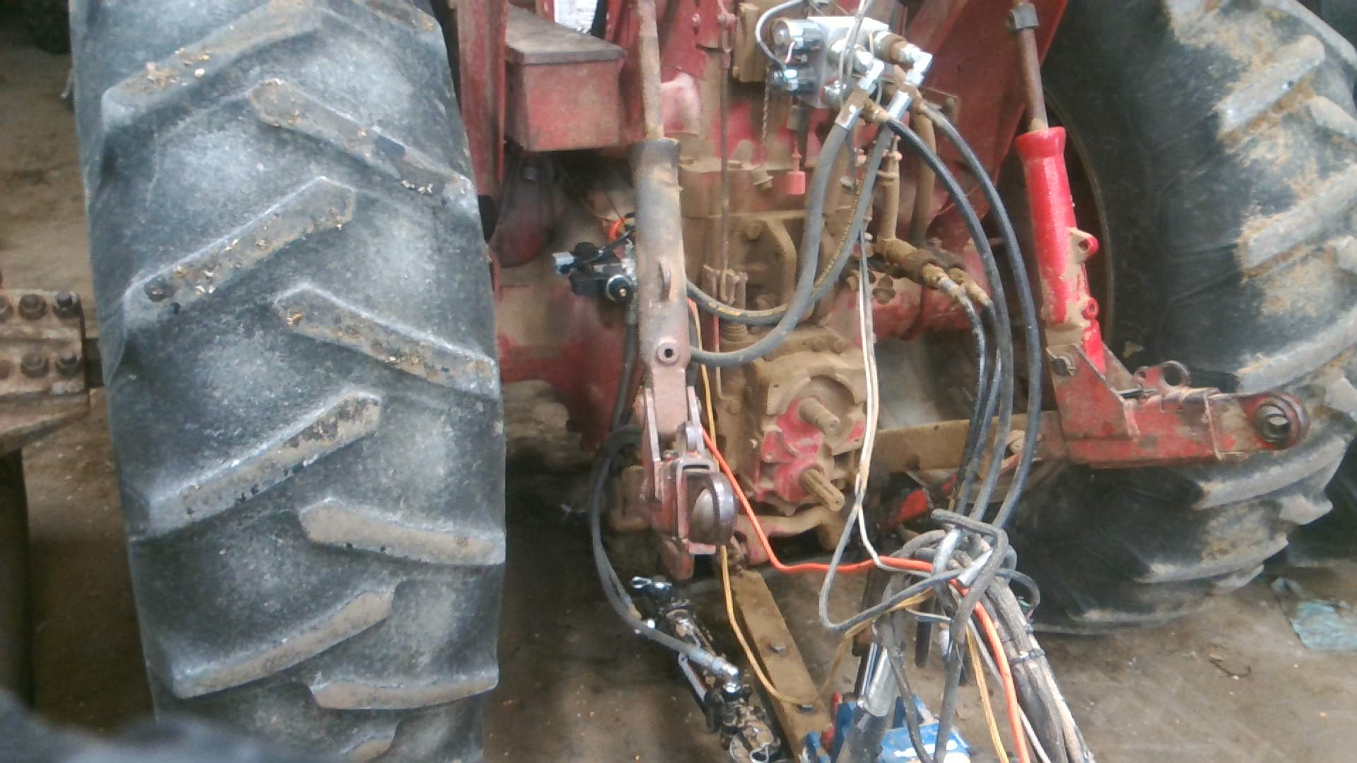

went back to a dual system, laid out the field lines with disk, copied field to my tool steering computer. worked good for a couple rounds, then started swinging hard right Left Right evrey 10-20 feet through the field. that made some real zig-zag rows! had a rain coming, didnt want to deal with figuring out the problem right then, so i locked the drawbar in the center and finished the field without toolsteering. have some WAS coming tomorrow, if i get to it i may try and install one before planting beans, and see if that fixes it.
added a WAS under the tractor near the drawbar pivot and finally got tool steering working. planted about 20 acres with it. worked on tuning settings, couldnt get it to steer quite all the way. right at the end of the field i finally found what I think i needed with the counts per degree setting. i think its going to steer pretty good!
Well it worked for a few hours, then It developed an intermittent Ethernet connection. Never seen that before. Had a rain coming, and a lot to do, so I locked the drawbar solid and planted the rest without toolsteer. Got done planting yesterday evening, so I will have to resume toolseering next year. so far I have learned a lot, and was seeing XTE values of 0 or 1 almost always, except on curves, where I ran out adjustment room on my drawbar.
I’ve been wondering where to put it, seems so obvious now, thanks for the idea.
The WAS? It works fine there, it doesn’t move much, in theory it would probably be better if it had more travel, but I didn’t see another place that would work. I need to get a skid plate on the bottom of the tractor to protect it. Its in one of the lowest places on the tractor. I think I pretty much maxed out the counts per degree setting, i am guessing that is because there isn’t as much movement as there is on a front axel.
