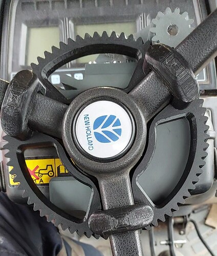

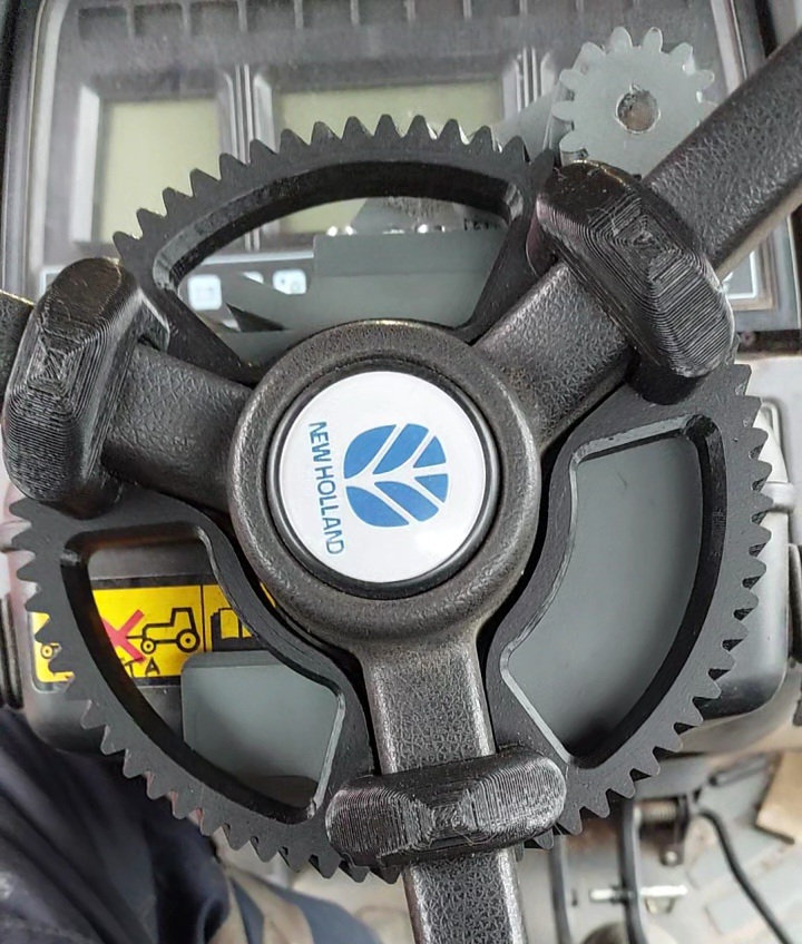

Has anyone done a steering motor assembly for the TM series of tractors? Working on a TM125 and TM175. After inspecting the column i think the universal gears should work but maybe there is something better.
yea there is file TM_Halterung_für_Universal_Motorhalterung - cerea-forum.de
some photos:TM_Lenkrad - cerea-forum.de ( need to create account to download the files)

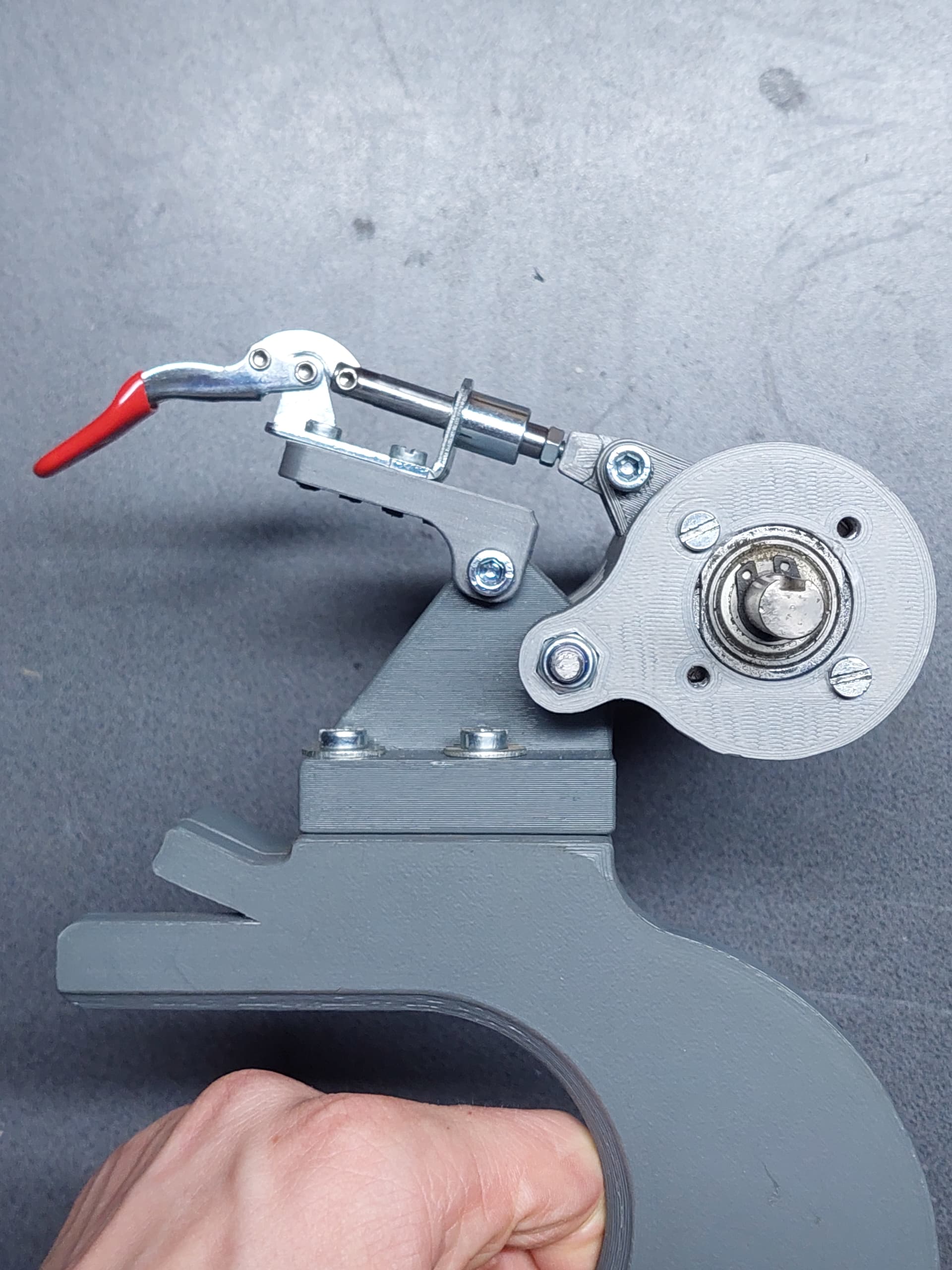

i needed to modify the motor mount since he used pg56 and i pg45(will share after i get to test it). Another thing was that my tractors (tm190) steering wheel wasn’t as deep as his, but i managed to get it working. I liked the mount because i didn’t want to drill any holes into the plastics. Picture of mine

Hello. I was wondering what the engaging device is on the TM mount? As i have a Tm135 and be going using a motor drive on it. Be using Phidgets motor.
Cheers
i belive there was a .docs file that had the clamps amazone link. But last season just put bolt so it would be enganged

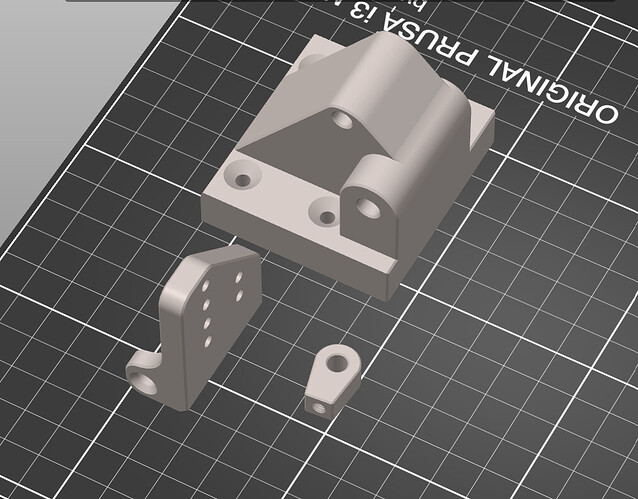

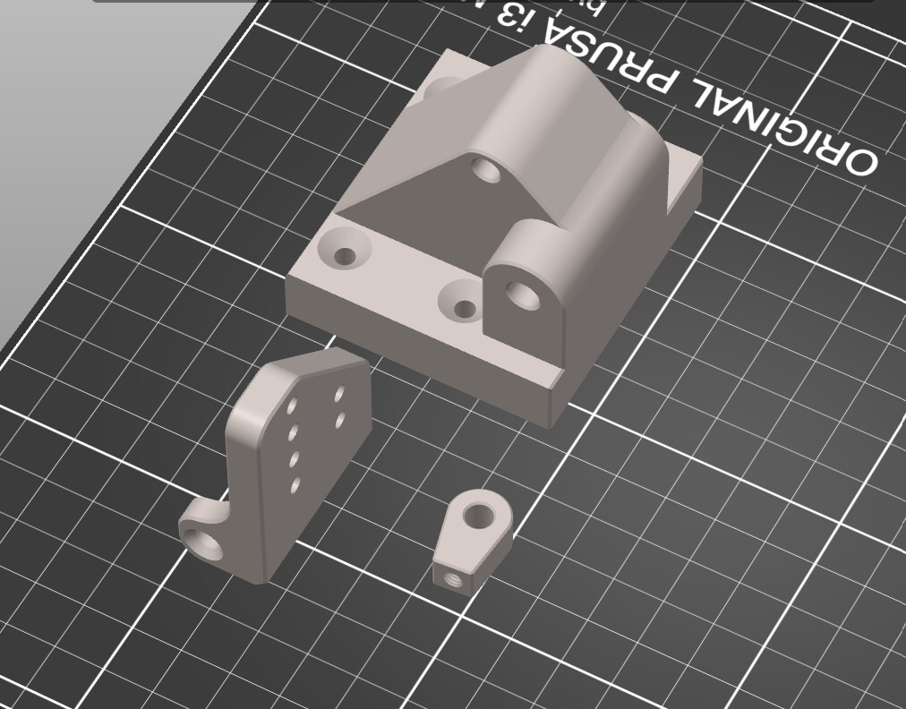

I have printed off all the cogs and pieces that goes around the steering column. But i missing the file for the piece that take the adjuster on top. Have found files for the type of motor i have. Just not for the piece that attaches to the motor and mounts on top of the steering wheel bracket. If any can help would be grateful.
Hello, if u are missing these
they are in the folder Universal Motorhalterung - cerea-forum.de, only things that i didn’t have modify was the plate where the latch is and the small bit, what connects the latch and the motor. If u didn’t get the answer take a picture of what are u missing and post it here so i could understand better.
Picture of my complete but untested contrapstion
Thankyou. Yes those were the brackets i was missing.
