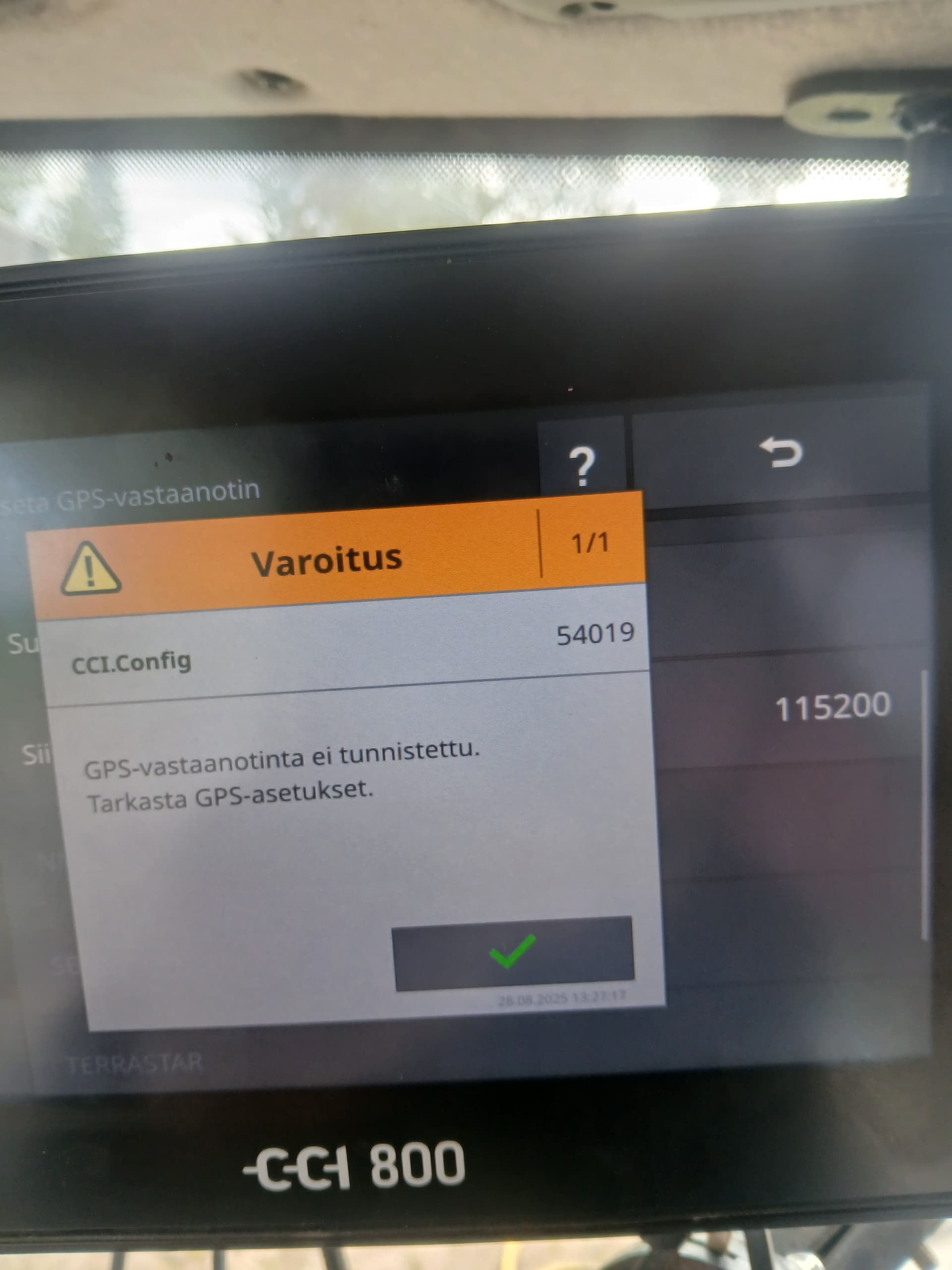

NMEA 0183 from F9P to CCI 800

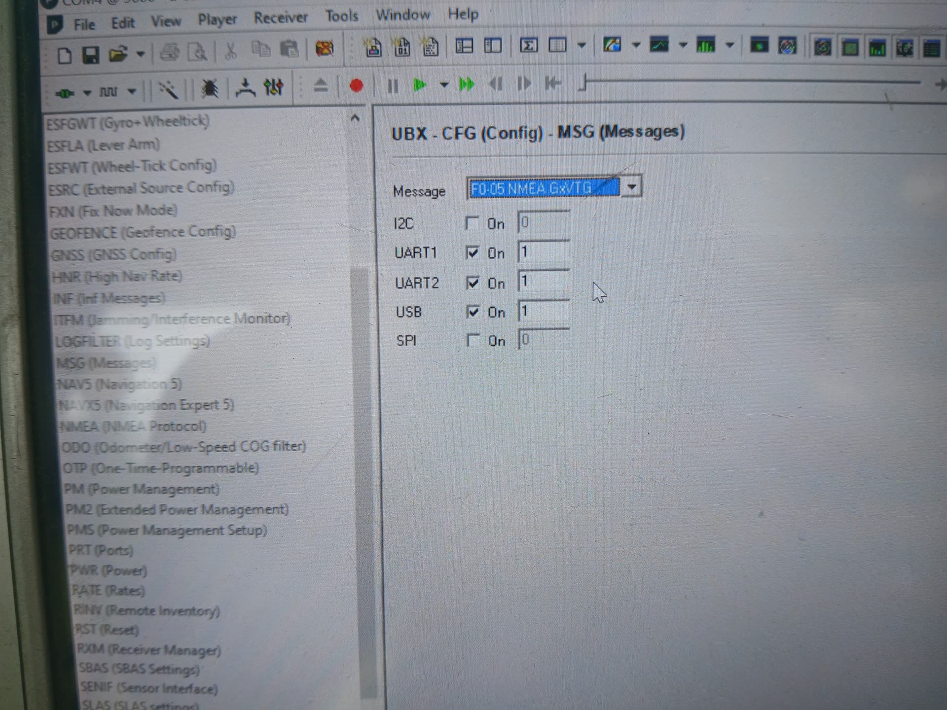

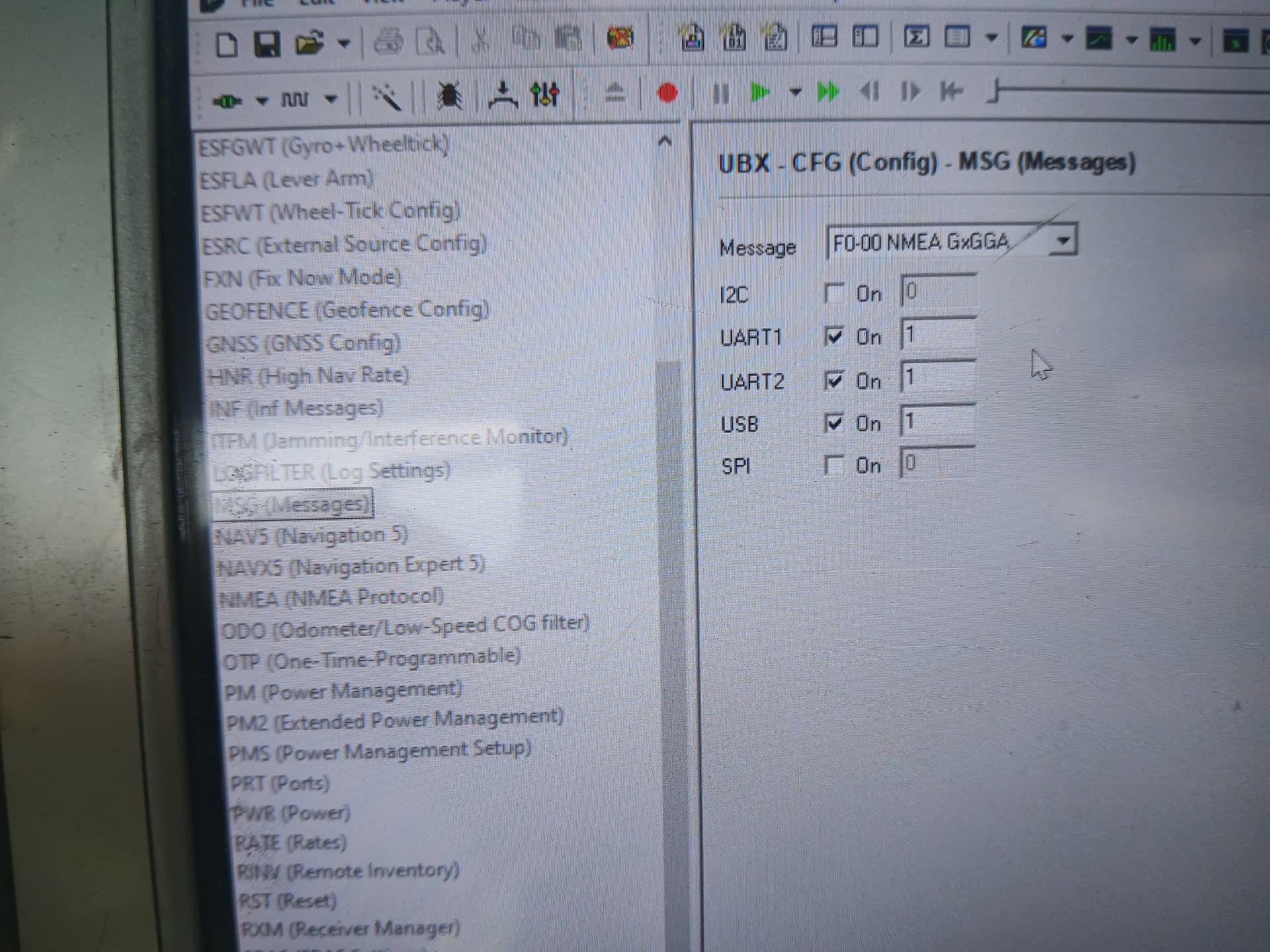

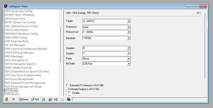

First I tried with gps_out but I did not get it to work. Now I’m trying to get gps from uart2 but it has not been that easy to me…

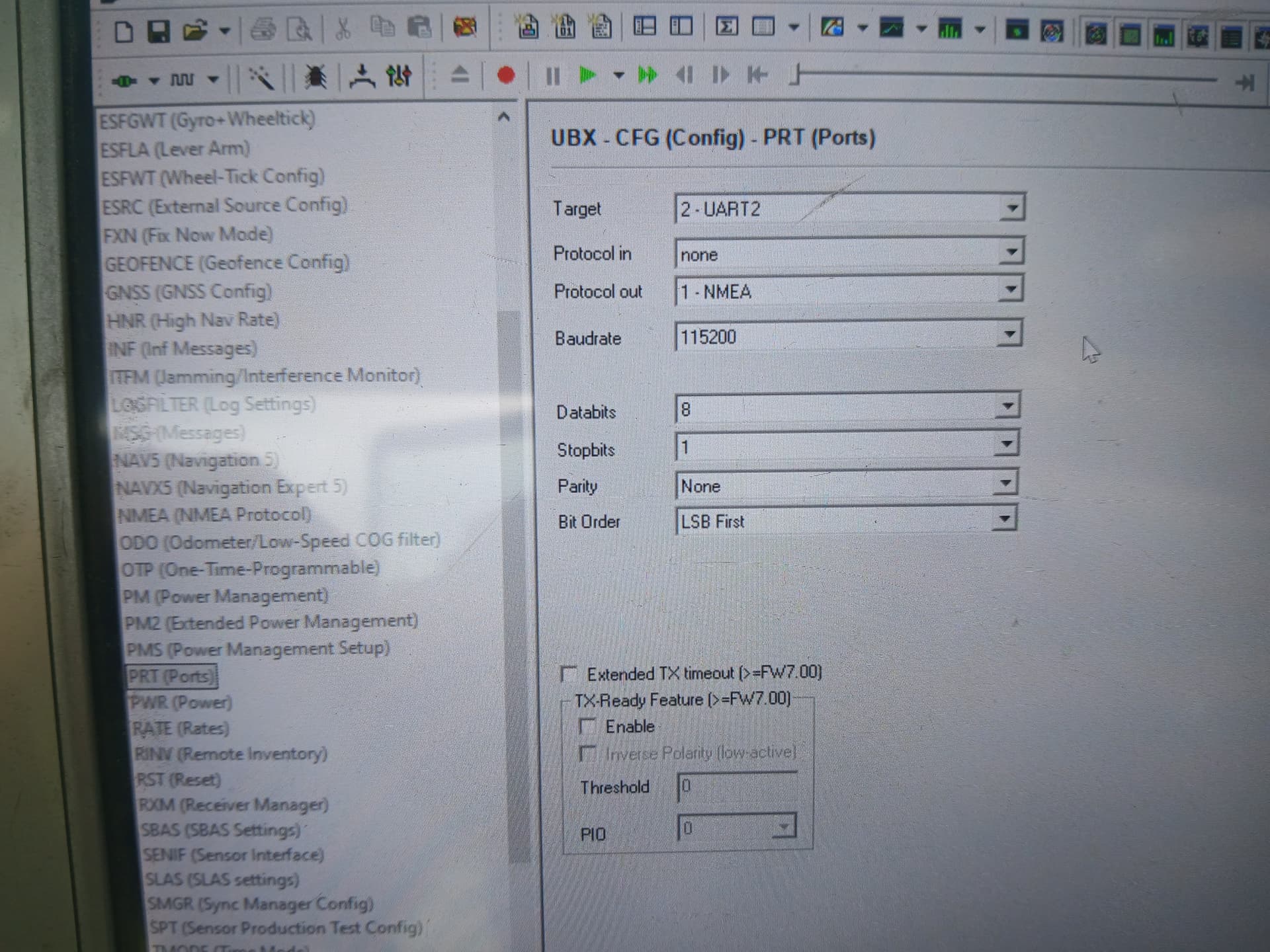

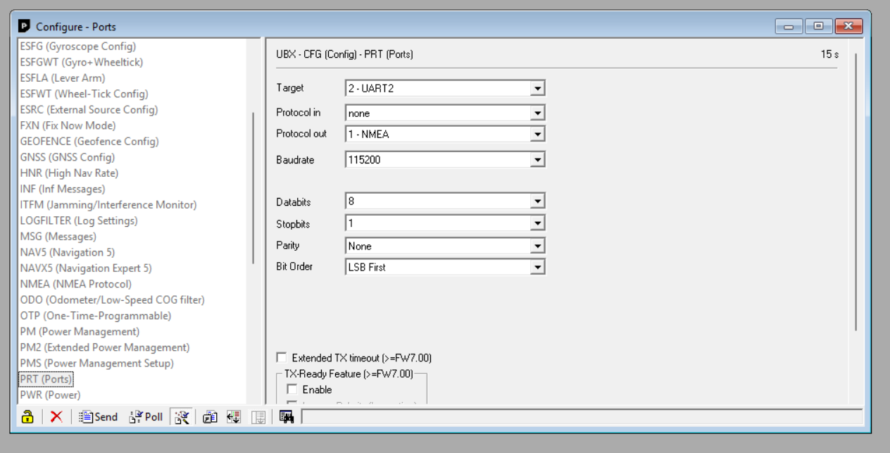

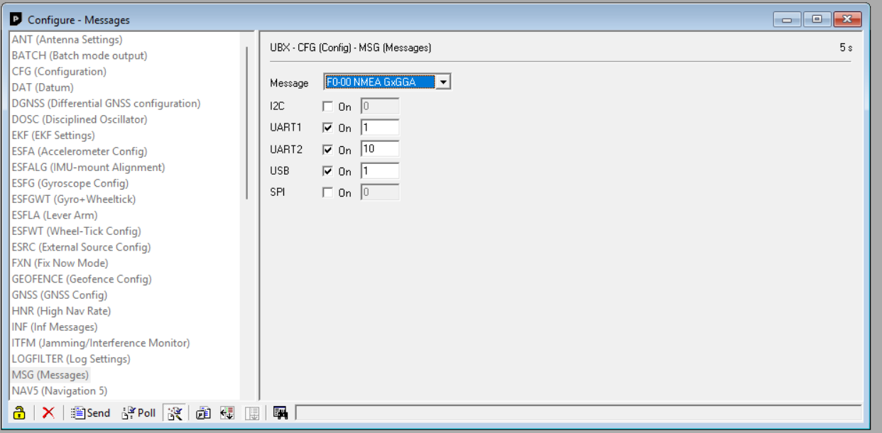

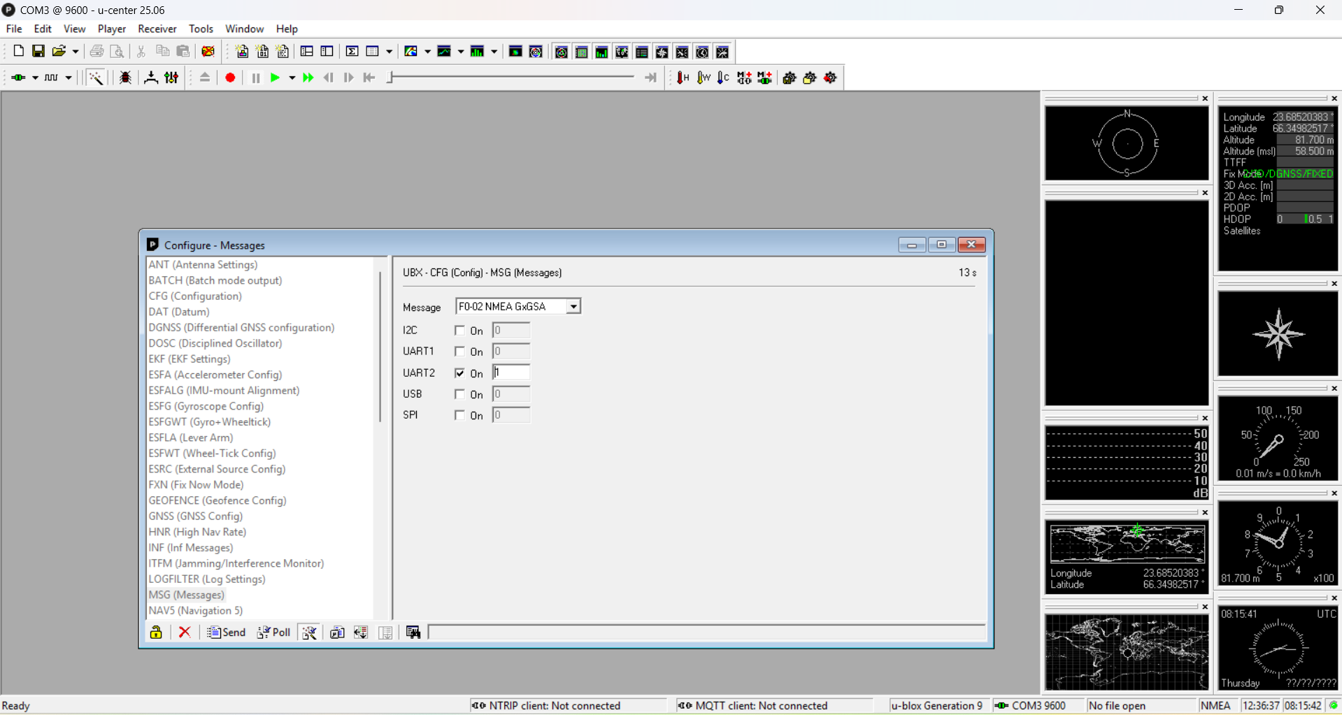

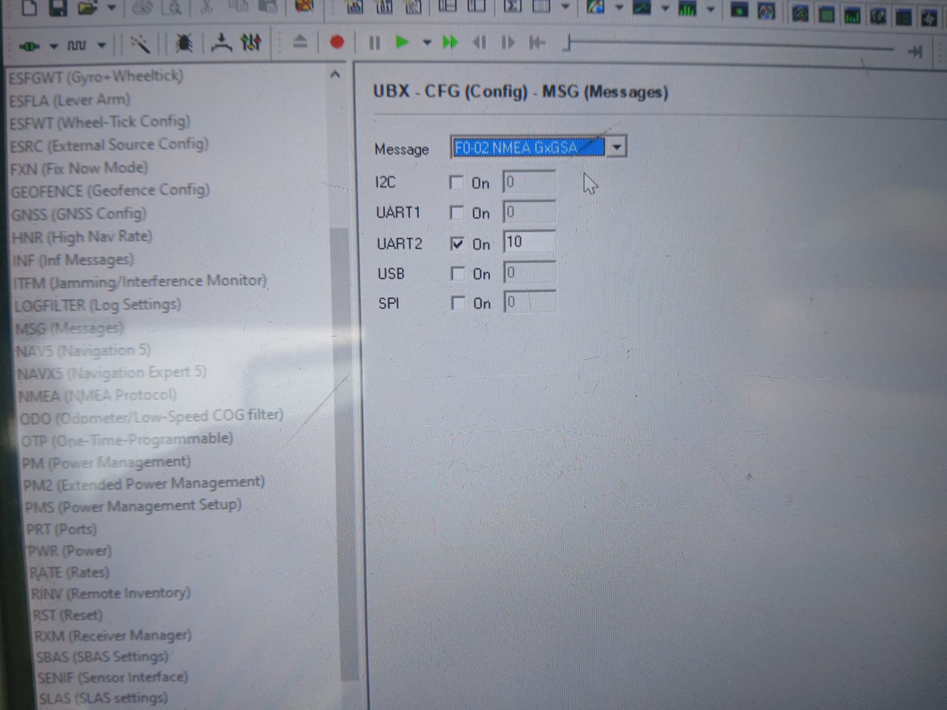

I have tried with GSA 1hz, GGA and VTG in 5hz and 10hz,
115200 and 38400 baud rate
tx-tx, rx-rx, and tx-rx, rx-tx
Can enyone see what I’m doing wrong?
I would appreciate any suggestions. I’m stuck with this one…

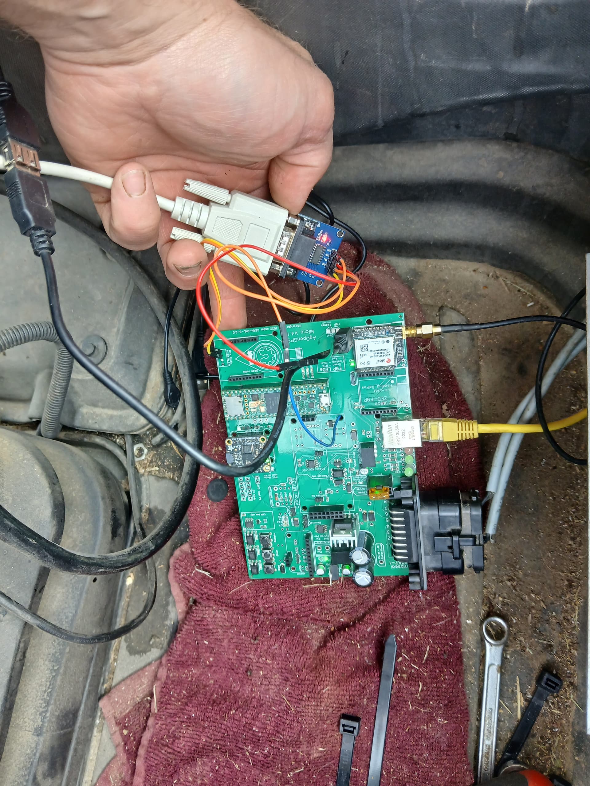

Thanks for the idea. I have heard that some people have cci terminal working with NMEA 0183 and I have cables and converter for that, so I want to try that first. I did not know that there was a DIY way for NMEA 2000

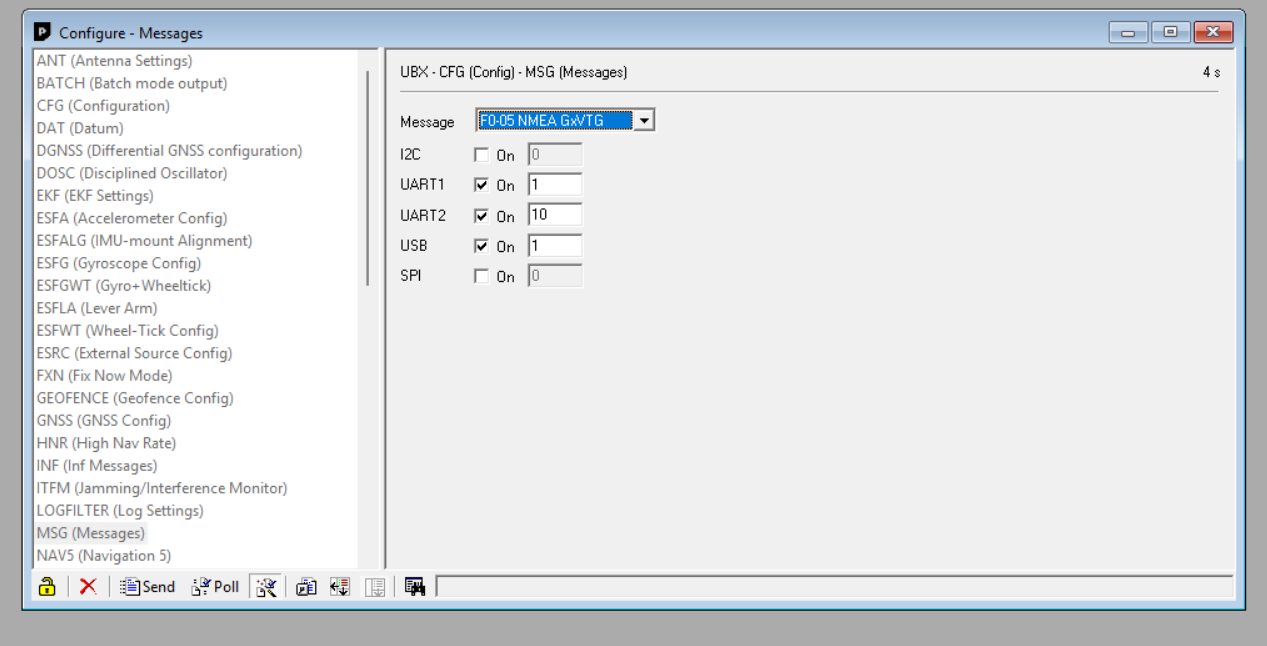

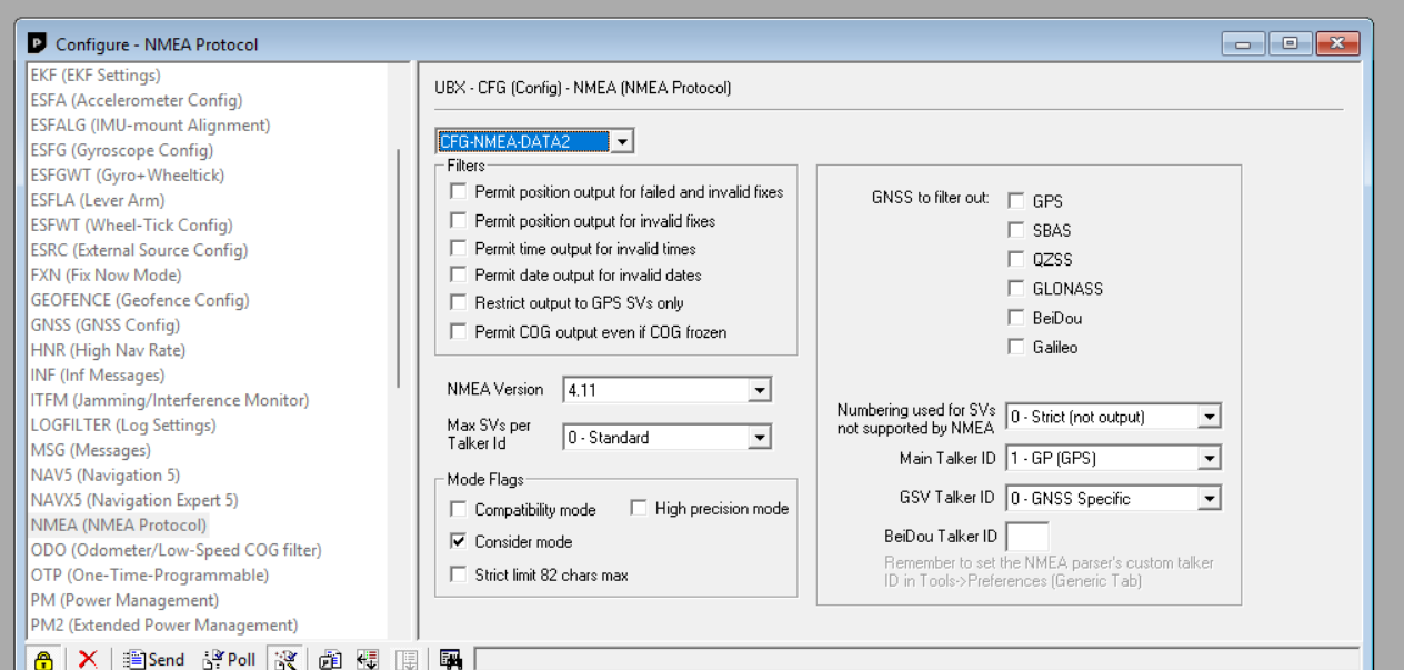

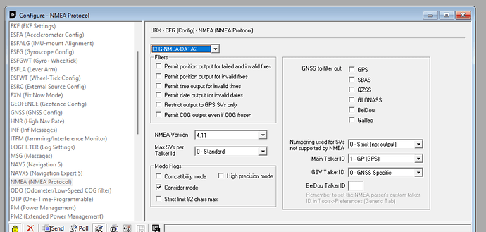

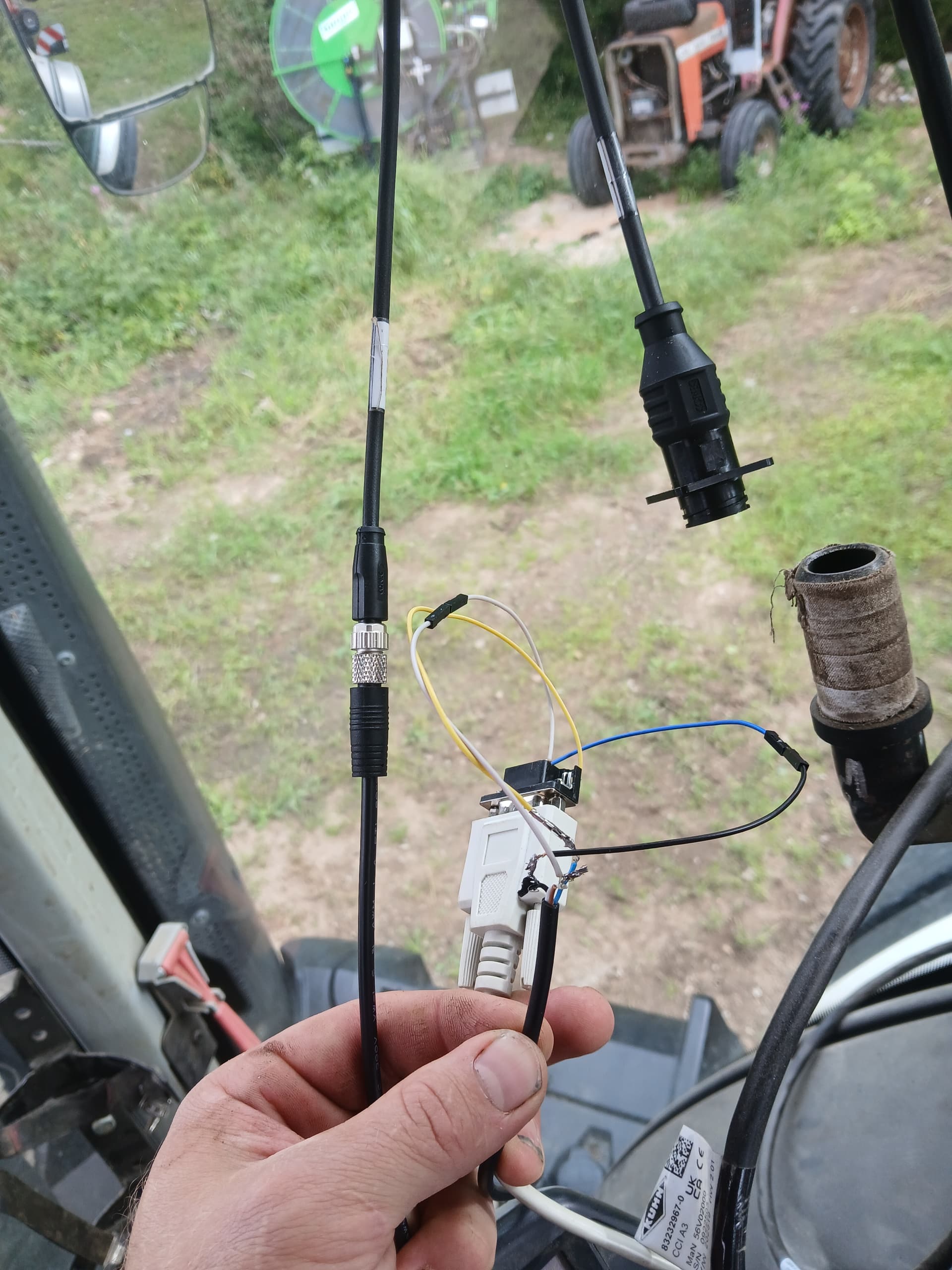

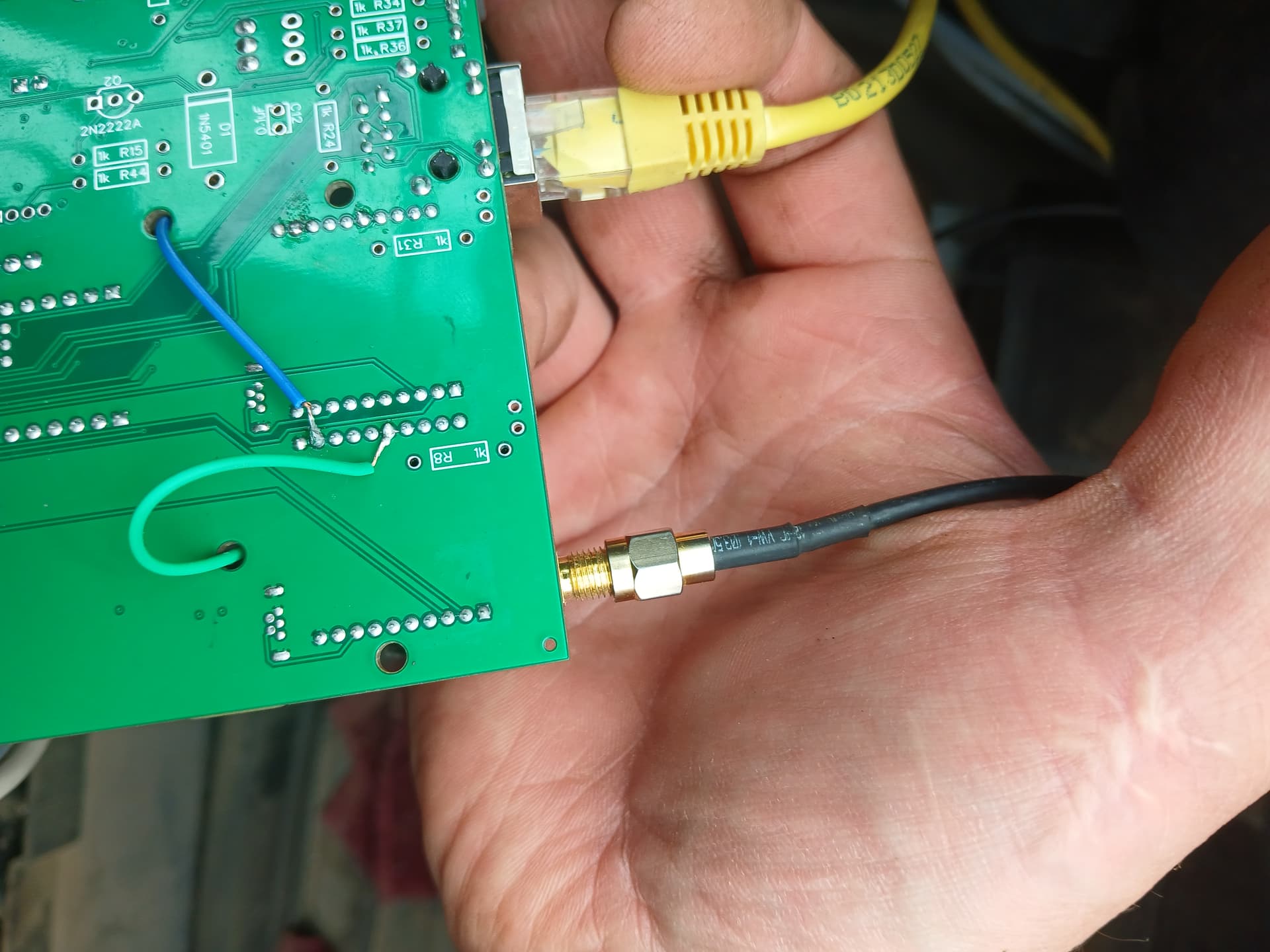

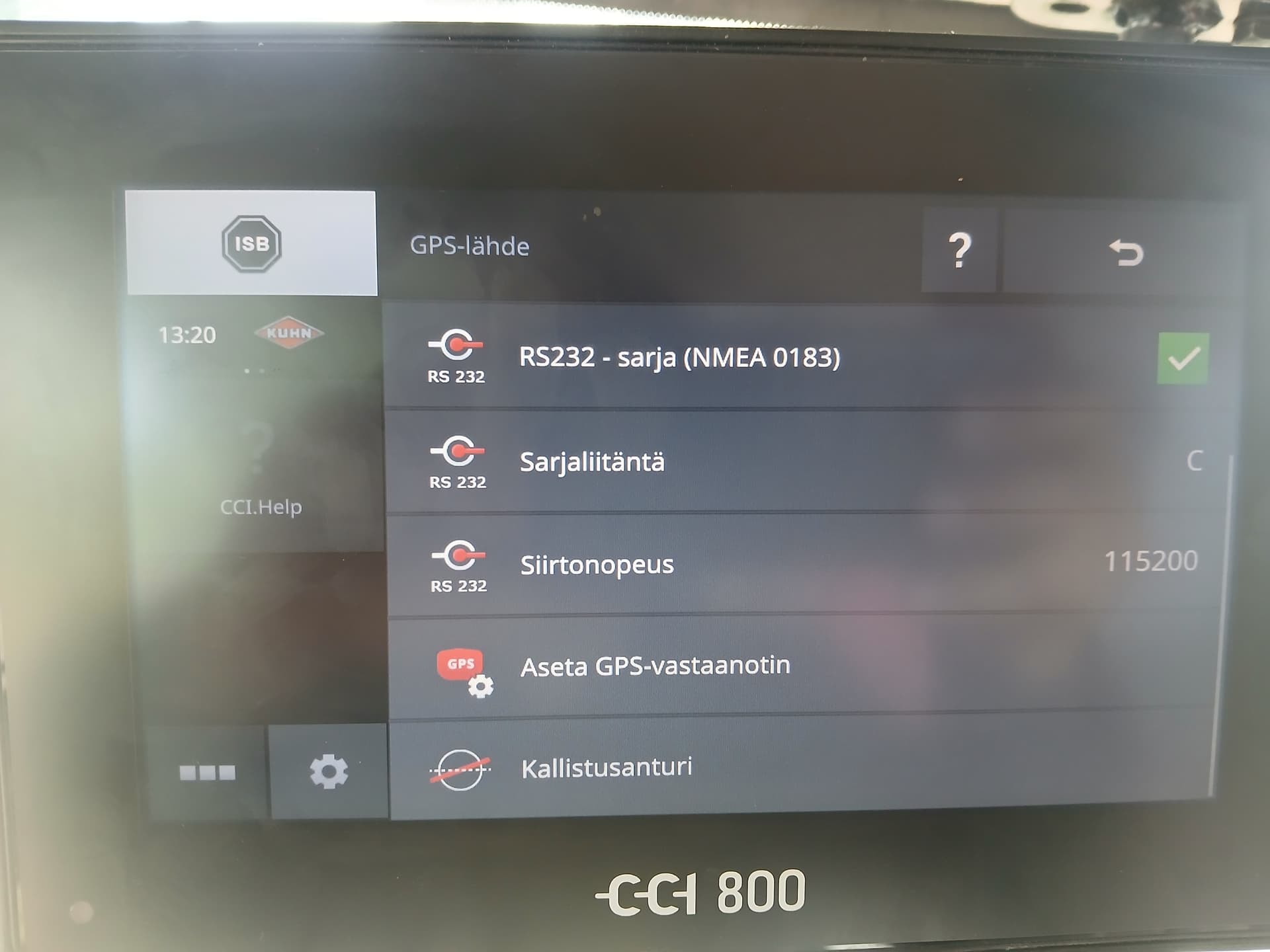

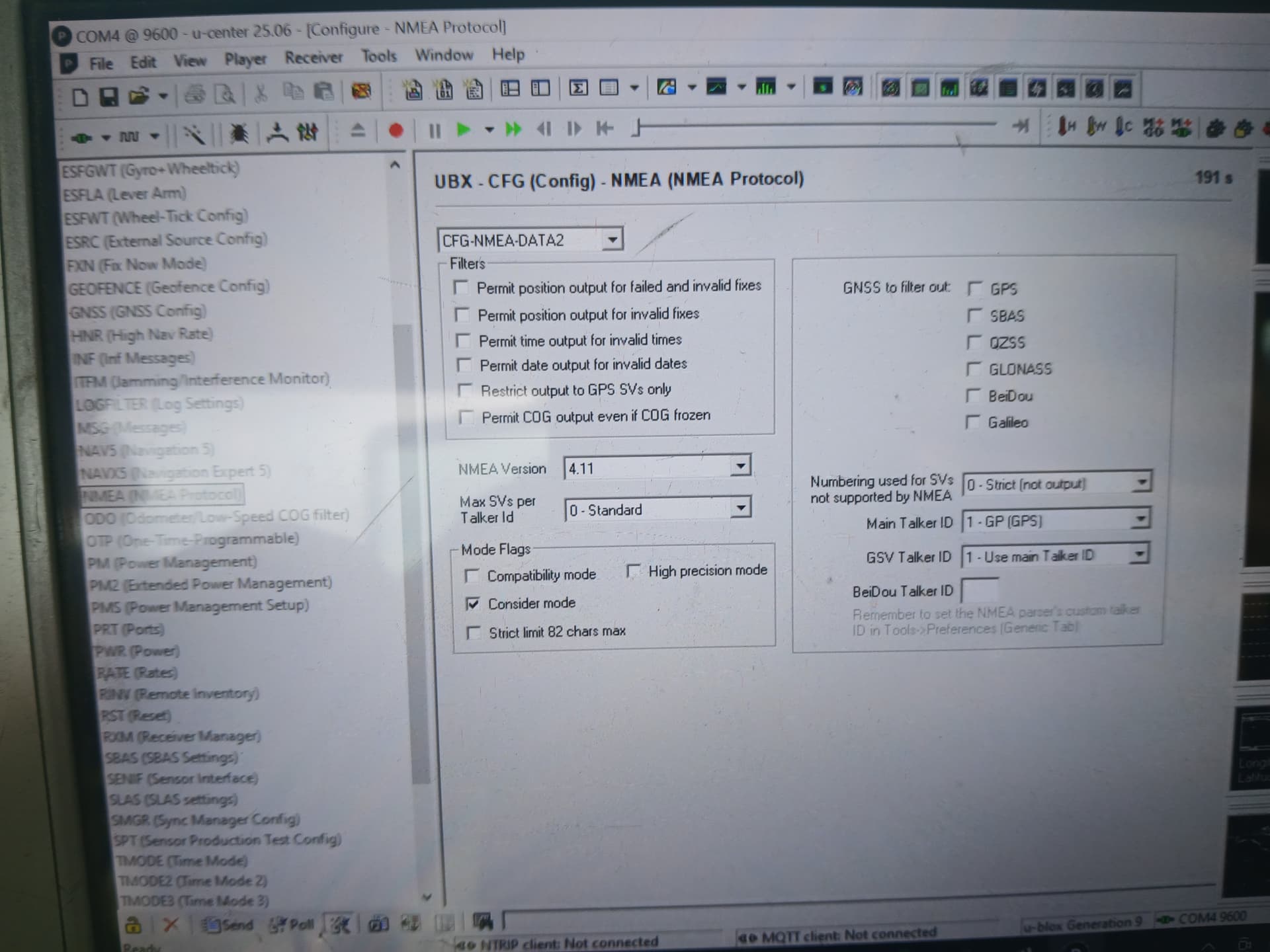

This are my setting now and still not working. I see from SerialTool that I have messages after rs232 converter.
C-connector was plugged the wrong way… working now with GGA 10Hz VTG 10Hz and VTG 1Hz, baud rate 115200
