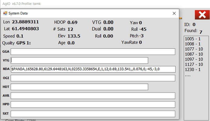

I’ve just succesfully connected rover with the base but I can’t seem to get rtk fix. Both antennas are outside and i’ve configured teensy 4.1 and zed-f9p with agconfigomatic.

You have ntrip messages coming in, your picture say 7 messages
