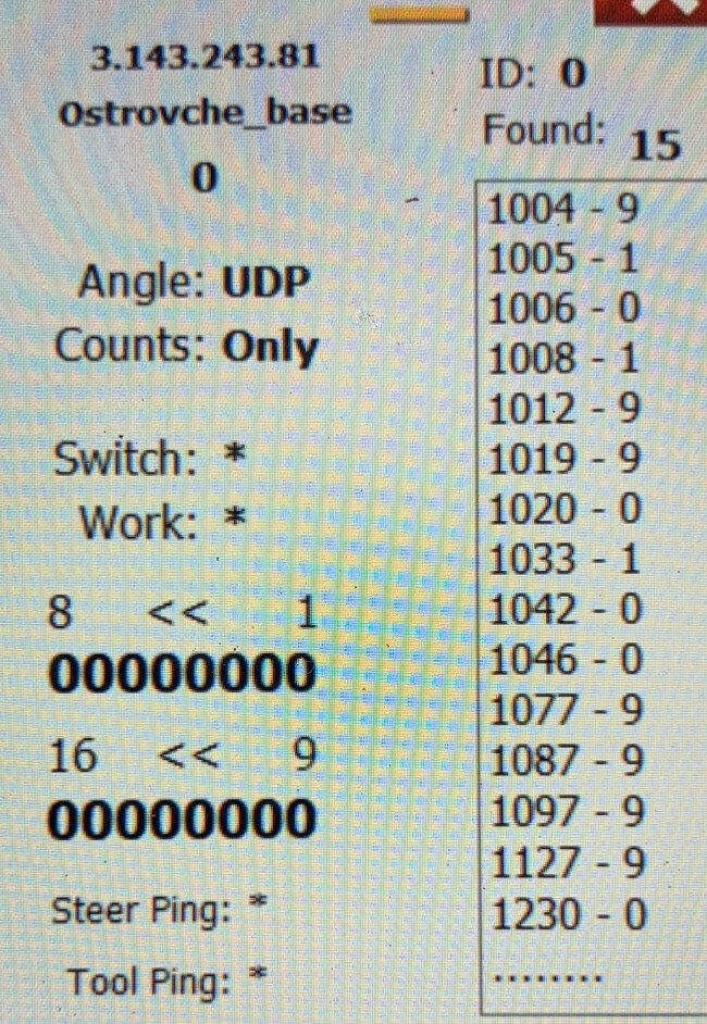

I have setup my own base station using Stefal’s RTKBase and a Raspberry Pi connected to F9P using USB, uploading to rtk2go. When I open AgIO or U center I can see the rtcm messages, but in AgOpenGPS it says GPS Single. I have tried getting the tractor outside of the shed and even connecting to 2 other base stations which are about 95km away from me and still no fix, not even FLOAT.

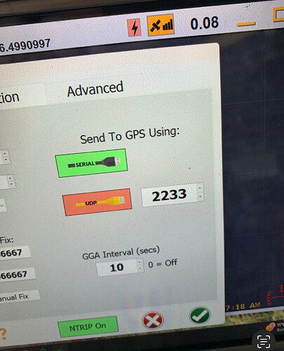

1- be sure to have a clear view to the sky.
2- if you see the RCTM sentences when you expend the AgIO page that a good sign.
3-On the NTRIP setting page on the second tab you must select where do you want to send the correction.
Be sure the correct one is active (USB or UDP)

So I connected my panda via USB and I instantly got RTK FLOAT and the tractor is still in the shed so don’t know what the problem is
When I put in UDP I can’t get it to work
If your F9P is on USB, then UDP can’t reach it.

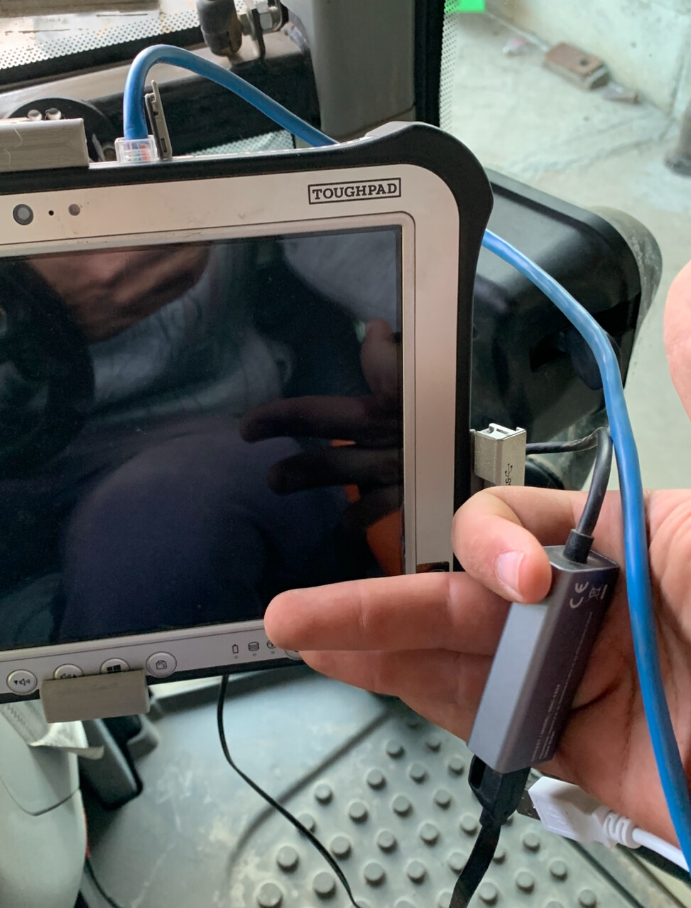

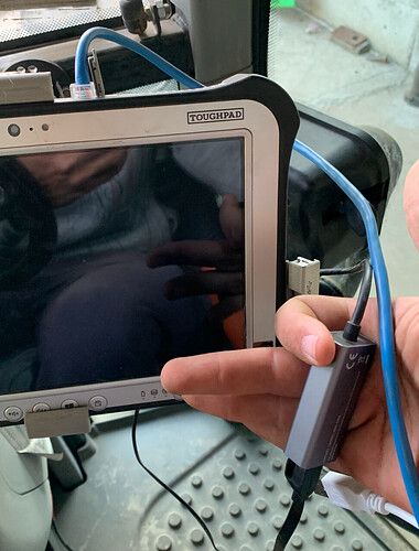

My tablets have no ethernet, so use USB to ethernet, with only one eth at the end of USB.
So I use router as “middleman”
Also at the moment I use lefebure on phone to Bluetooth on F9P. But did use phone as hotspot when running AOG 4.x

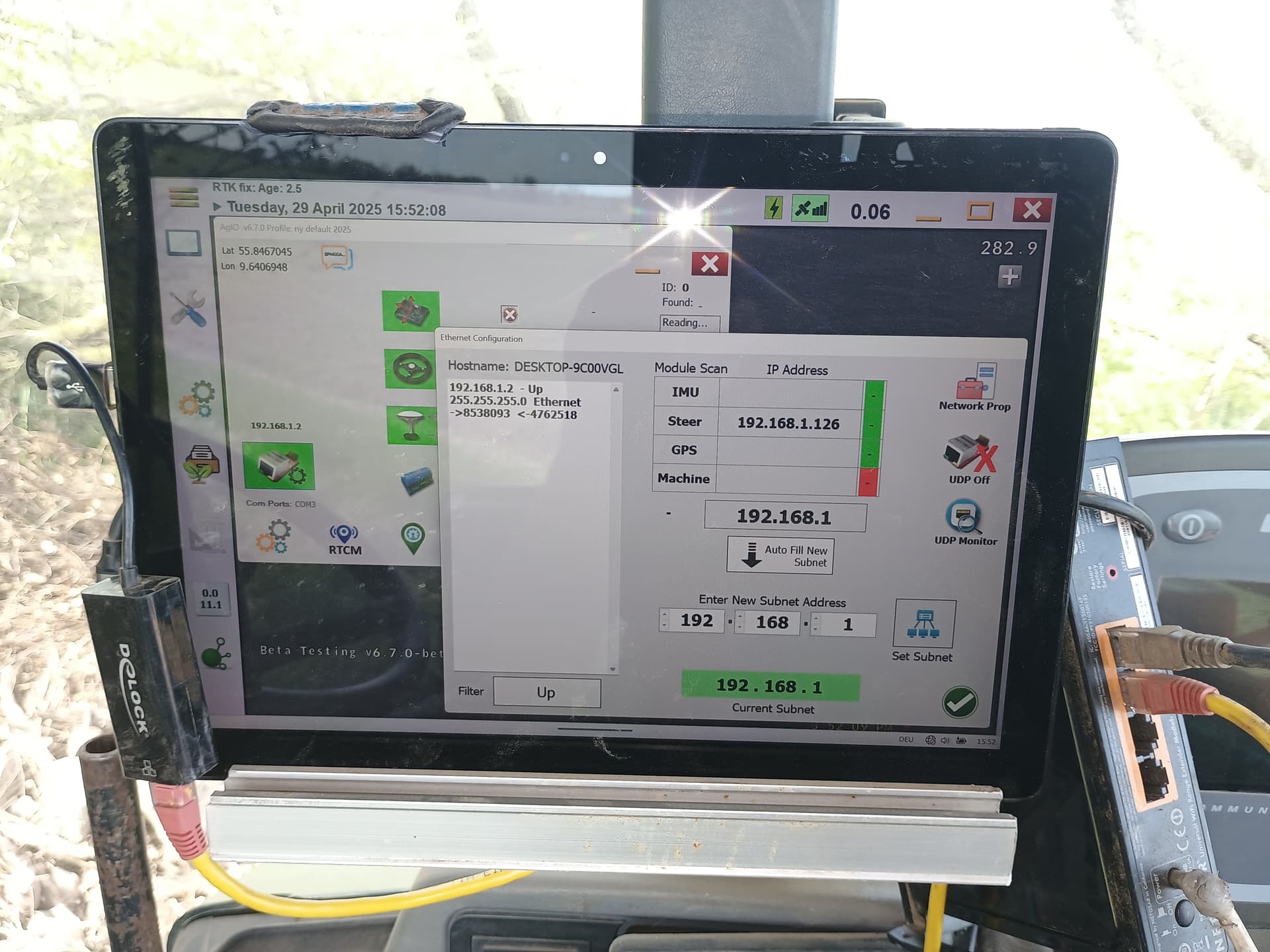

And the picture, but this is tractor with teensy steer, so only 2 eth cables
So I have PCBv2 connected with blue cable and Panda connected via a usb to ethernet adapter

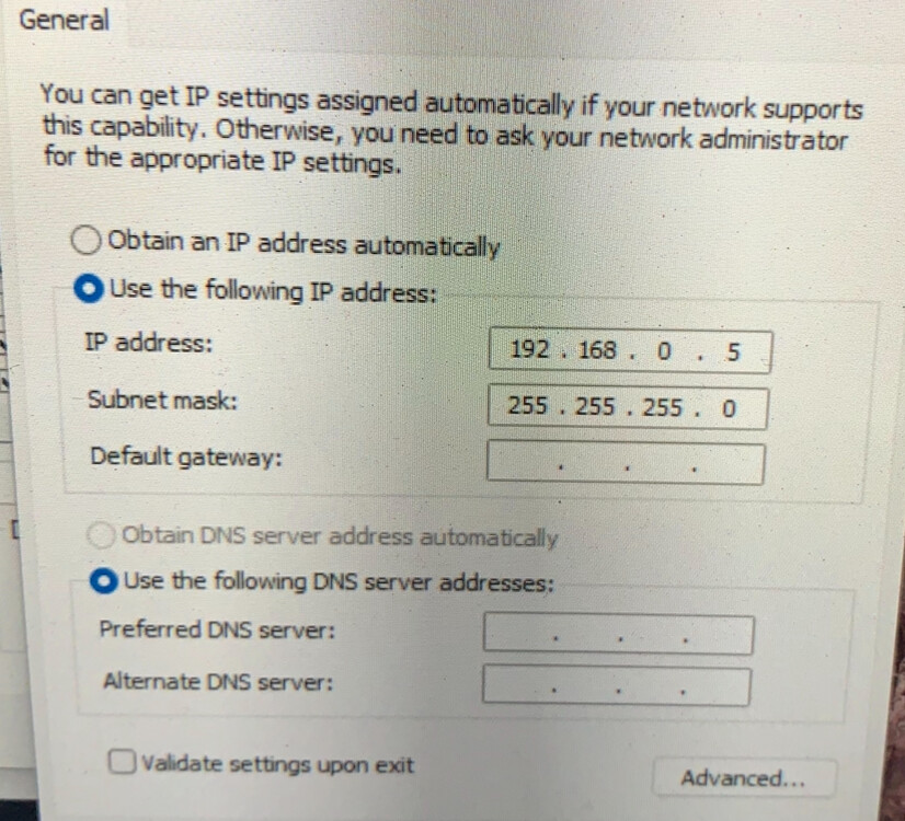

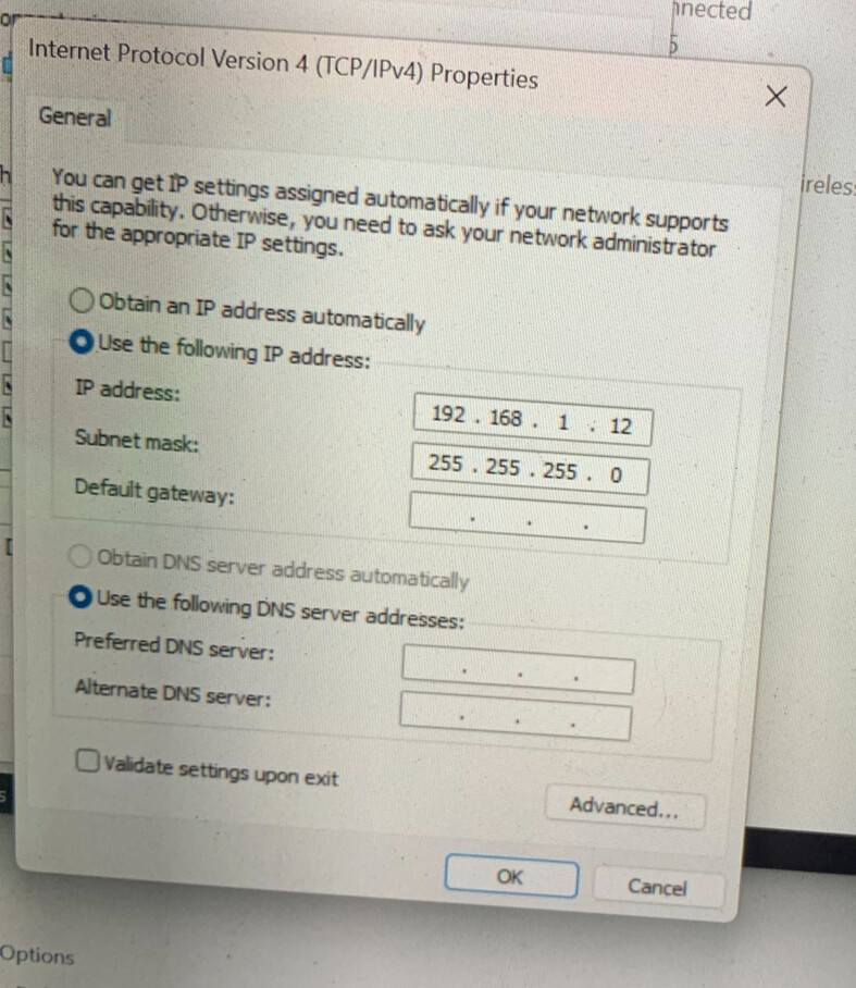

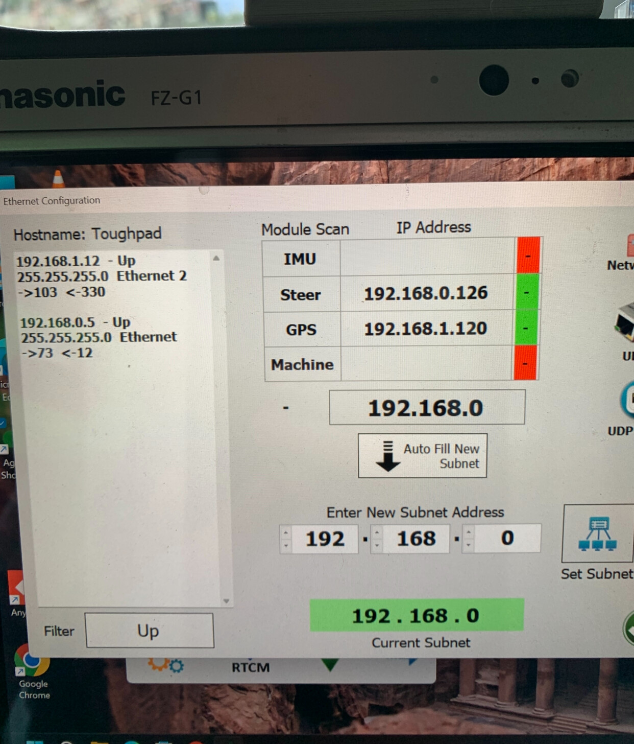

Ethernet port for PCBv2 address is 192.168.0.5
Ethernet adapter for Panda is 192.168.1.12

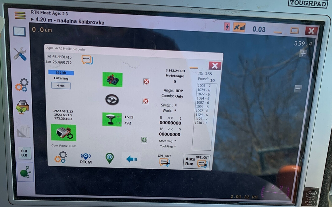

And for configuration in AgIO
For some reason my IMU is not in green but when I open the heading chart IMU number changes constantly during work so I believe it works
OK so here’s what is going on:
For some reason, AgIO will receive GPS even if your subnet is incorrect. This is why you are receiving GPS.
Of course, because your Steer board is set to the correct subnet, it works.
But AgIO is sending the corrections to the subnet you have set (192.168.0.x), and your GPS board is on 192.168.1.x . So it never receives the corrections. This is also why your IMU isn’t showing up as connected.
The fix is going to be buying a router or ethernet switch and plugging both devices and your tablet into that. Then everything will work like it should.
Maybe the INO for your teensy, haven’t got the new delay for IMU in it?
I have never fidled with those IP settings in windows, but I would use .1.5 and .1.12 if possible. Not the .0.5
IP MUST be same, else no talking from AOG.
The IMU isn’t showing up because the PGN that checks for a connected IMU is being sent over 192.168.0.x, and the GPS is listening over 192.168.1.x.

So i setup steering board and Panda in same subnets 192.168.0.x but when I connect them both with the ethernet cable my autosteer board disconnects(lights red in AgIO). When I connect just one of them (either PCBv2 or Panda) it lights green. That is the reason I changed the IP addresses of the two ethernet adapters in control panel.
Yes, you’re trying to use two separate networks. AgIO won’t work with two, which is why you need a router, so both boards are on the same network.

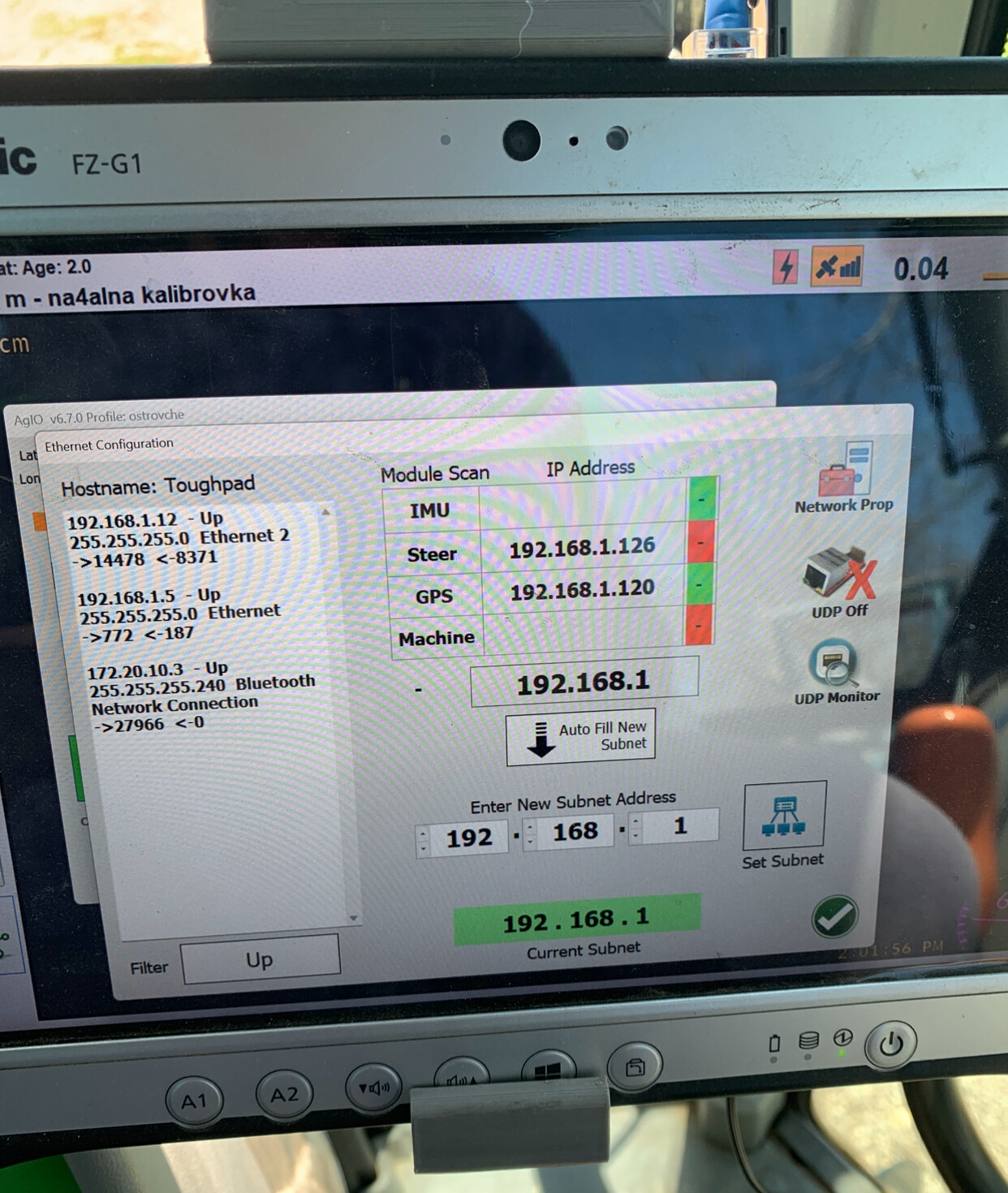

Ok so I got the IP addresses sorted out and put everything in the same subnet, and as you said AgIO is searching for the panda in the subnet that is setup so now I have corrections over UDP which is fantastic. Even the IMU lit up green.
But as I said when my steering board and Panda are in the same subnet, my steering module doesn’t light up green but oddly it doesn’t light in red either just like the IMU earlier when I had set different subnets. I haven’t tried to see if it actually works because I’m away at the moment but will test it out maybe tomorrow
I’m not sure why would a router or a switch resolve this problem since Windows recognises different ethernet ports and addresses
Now you use 2 input at tablet. With router or switch you would only use 1 . The eth plug!
Ok thank you for the clarification, so I guess I’ll have to go find a 12v switch or router.
