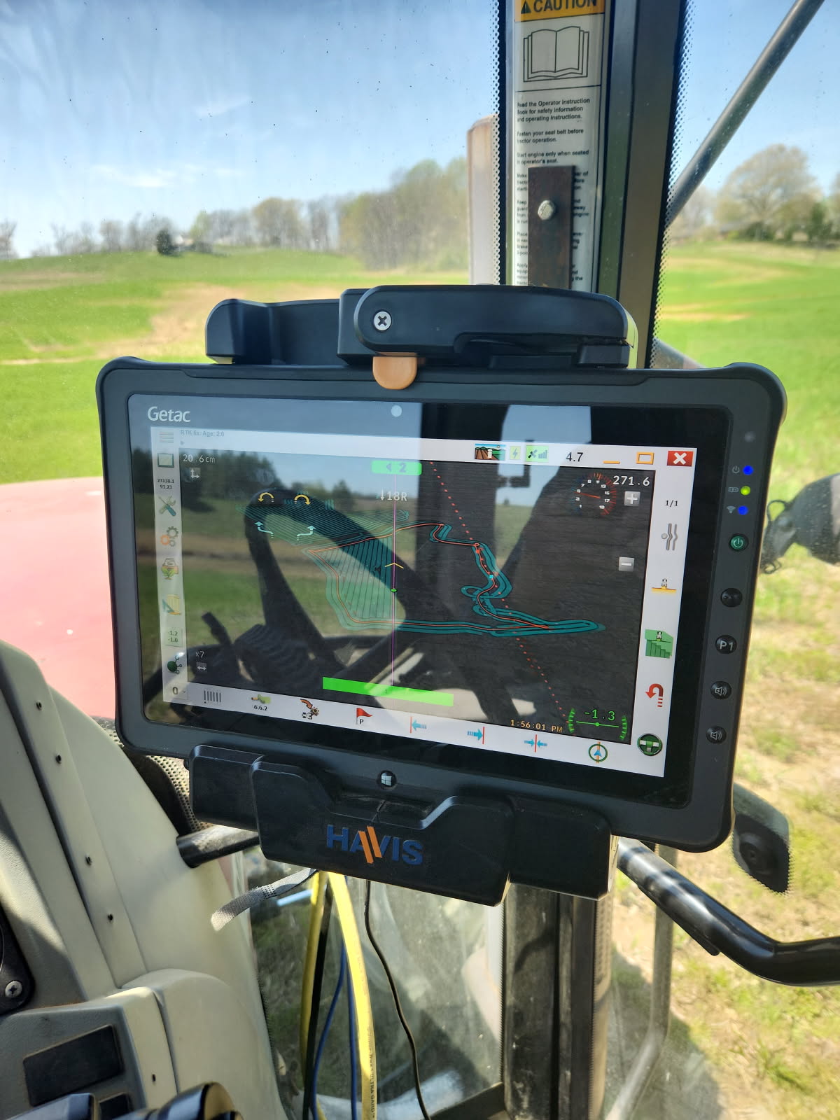

While running anhydrous I would set AB line and start applying my implement width is 270" and each pass I’m on line but it leaves a 4" or so strip on each side that doesn’t paint, like my AB line is set to 274".Im sure its a setting just cant find it. Antenna is in center of tractor.
A screenshot would be helpful

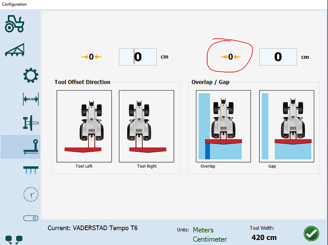

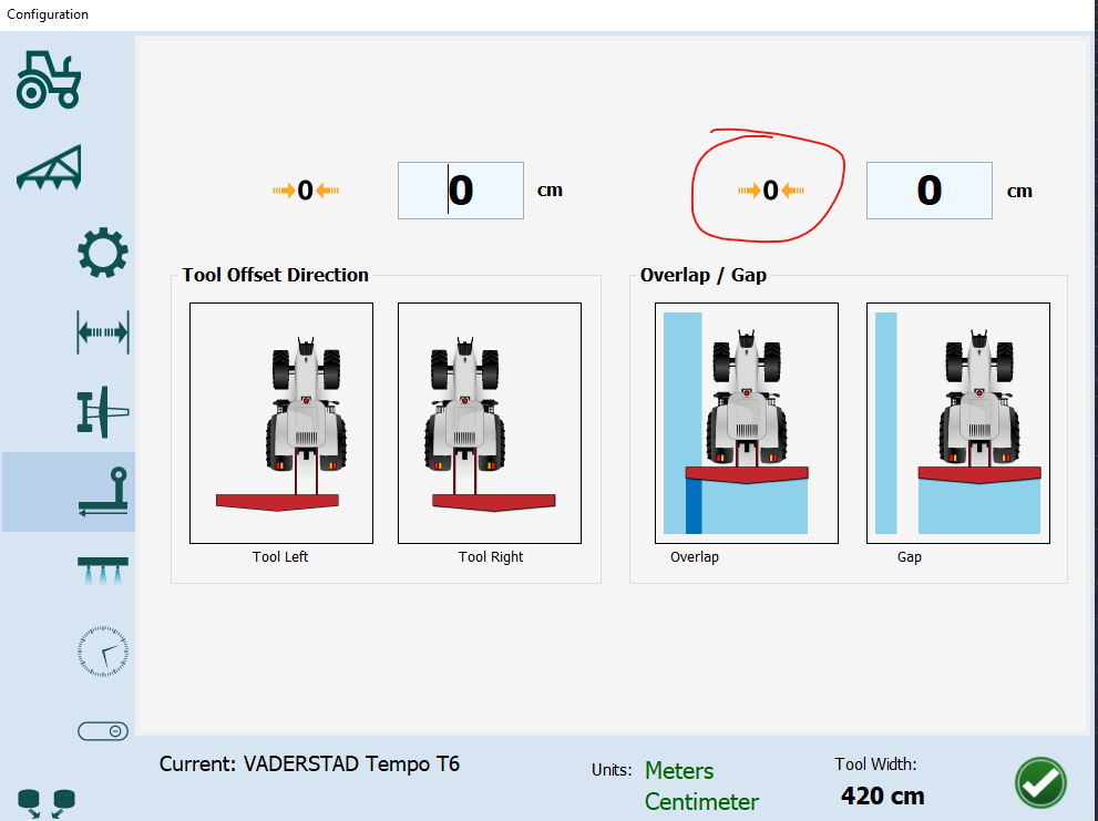

Gap setting in implement setup screen?

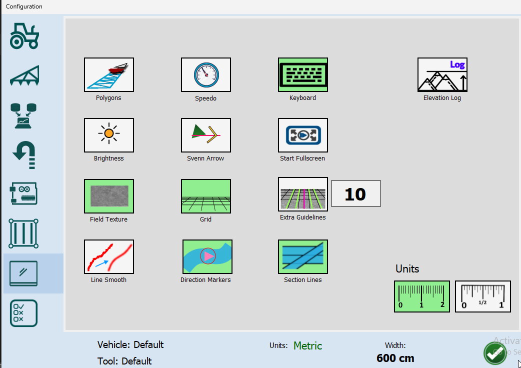

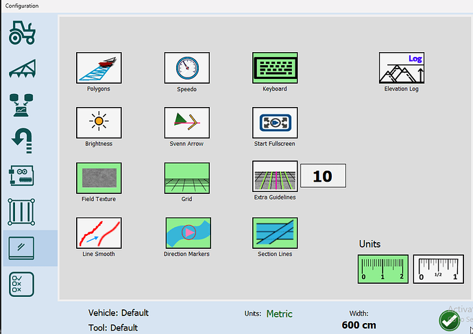

Are you sure you don’t just have the “Section Lines” turned on? It draws a black line around the sections for looks. Can be turned off in the settings by clicking the “Section Lines” button. I’d try that and see if they disappear before trying anything else. Could be you don’t have anything wrong.
As @Davidwedel said.
I always turn those black lines off.
Apparently some people like this look but I really don’t, especially to see those gaps😑
