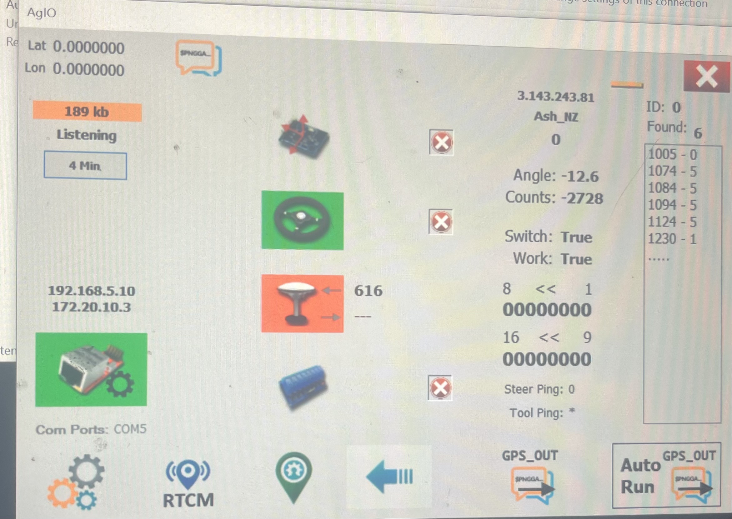

Really struggling. I’ve just upgraded a working Teensy system to single receiver to Dual Receiver with base station.
I’ve manage to connect to the base station. Set an AB line. Hit the autosteer button and no response.
I’m in a complete loss of IP addresses and ports.
The AGio window has no green lights.
Middle left has two IPs, the IMU and my hotspot
Bottom left says com 5.
If I click into them GPS, IMU, Steer, and Machine all have ***
Where do I start?
              You should share some pictures. That would make it a lot easier to see whats going on.
              If your using a teensy im guessing you are on ethernet connection but from your description it sounds like your trying to connect over com port usb
If you open the settings page in agio you can turn UDP on for ethernet.
As ray said some pictures of your board and screen will go a long way
              I’m glad you’re here. I think this is 95% of the answer.
What I’m thinking is that because im on a FZG1 tablet I might need to do that regedit thing to get the new receiver through the port. It’s USB to ethernet. Pictures will be up soon
              What other photos do we need?
              Could be a wrong firmware on f9p, try reflashing it again.
Or you are using com port as well. Click on red antenna icon and than red disconnect button next to GPS drop box.
              So you’ve got ethernet configured on your tablet so thats good.
Do you have the 6 ethernet pins soldierd in your teensy?
Have you uploaded the correct configuration to the teensy for your steer application
              As @Uprishaa said, most likely your GNSS receiver is not configured correctly, since autosteer is green.
What receiver and board you use exactly?
