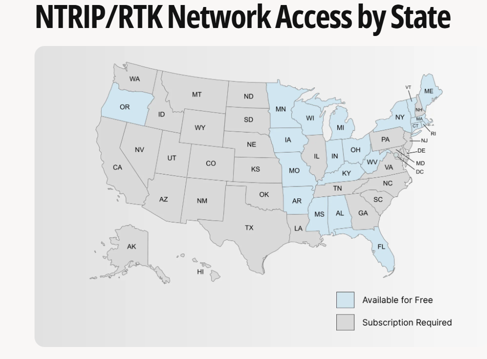

Check with your state. Quite a few have a no cost correction offering. I’m in Iowa and use the state DOT service
Thank you for the reference. I should have specified, we are in IL which does not offer a free correction service. As such, I’ll be setting up our own base station using RTK2Go as the caster service
In either case, I’ll still need to pull NTRIP RTK corrections down to my rover unit(s) via cellular network.
