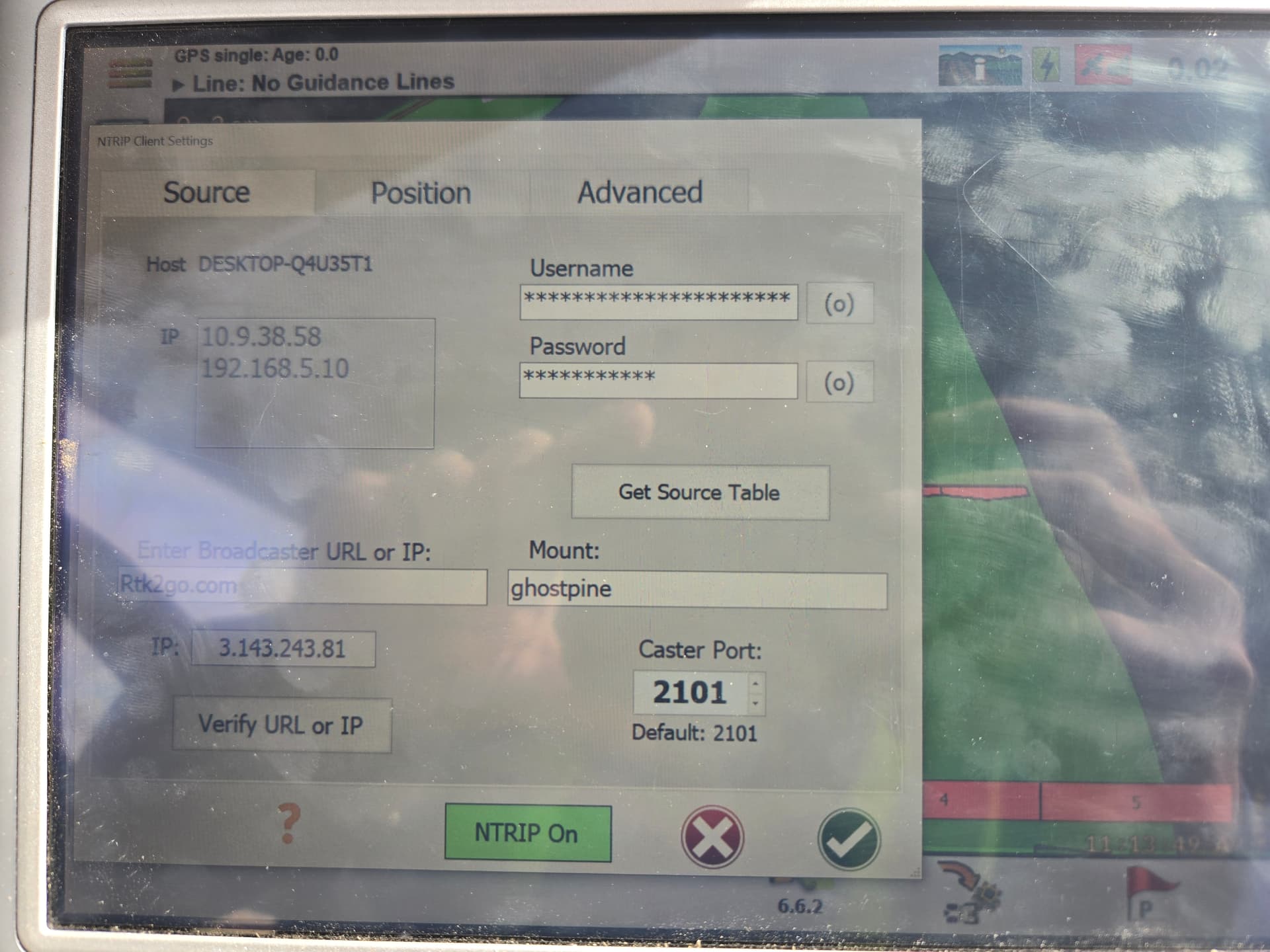

need help as I’m having trouble with Ntrip. i can connect to castor but no data is received. I’m using Agio V6.6.2. i have verified from my phone that my basestation is sending out correction data. I’m using rtk2go.com. I’ve deselected ipv6 connectivity as i read on the forum that this could hinder. my internet connection on tablet is excellent. not sure what else to try…
when i select ‘Get Source Tablet’ it freezes up and says invalid port (something like that).
Can you upload pictures of the NTRIP settings? And what board/how are you communicating with it?
communicating ethernet cable to micro 4.5 all in one board.
