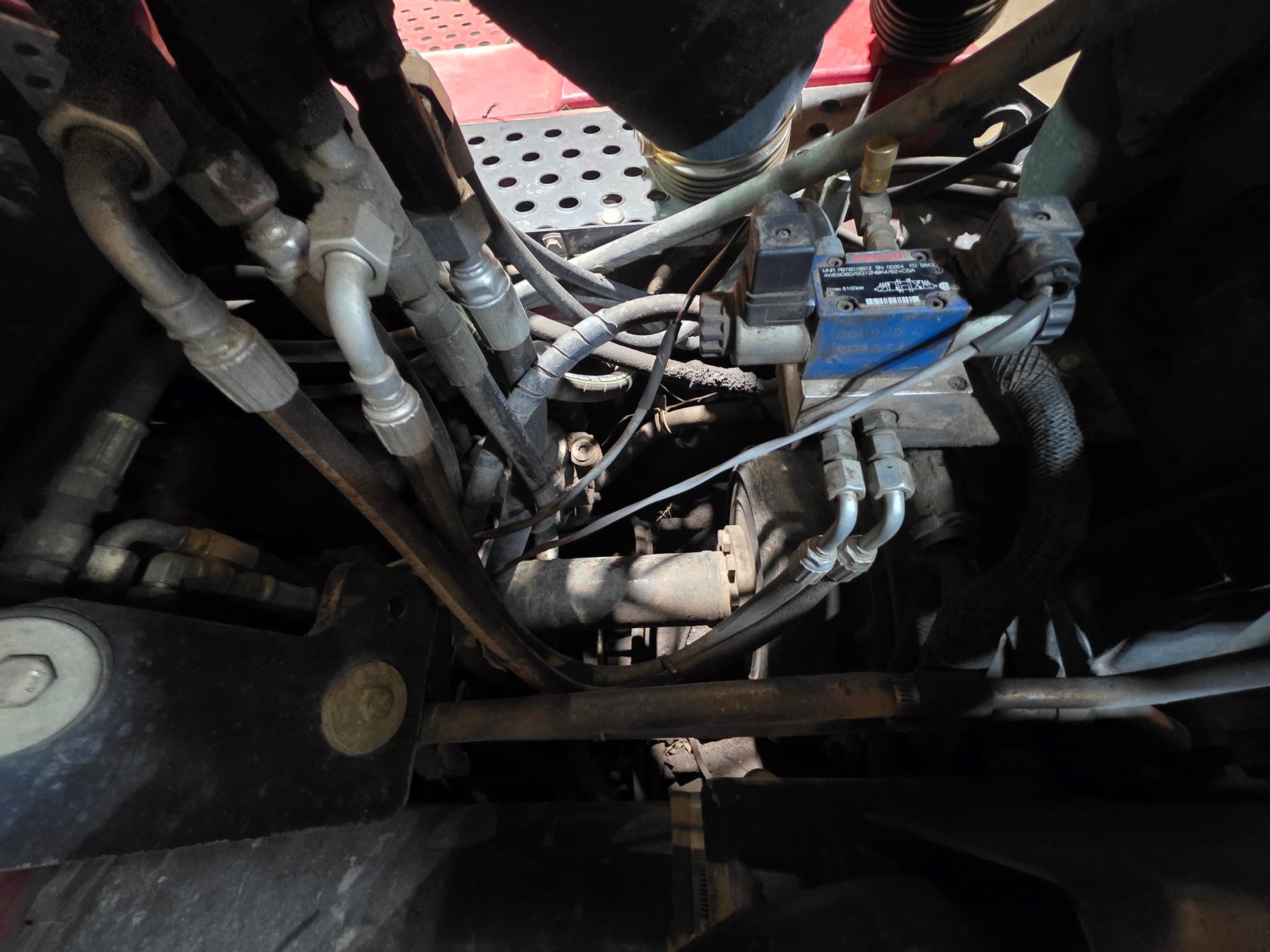

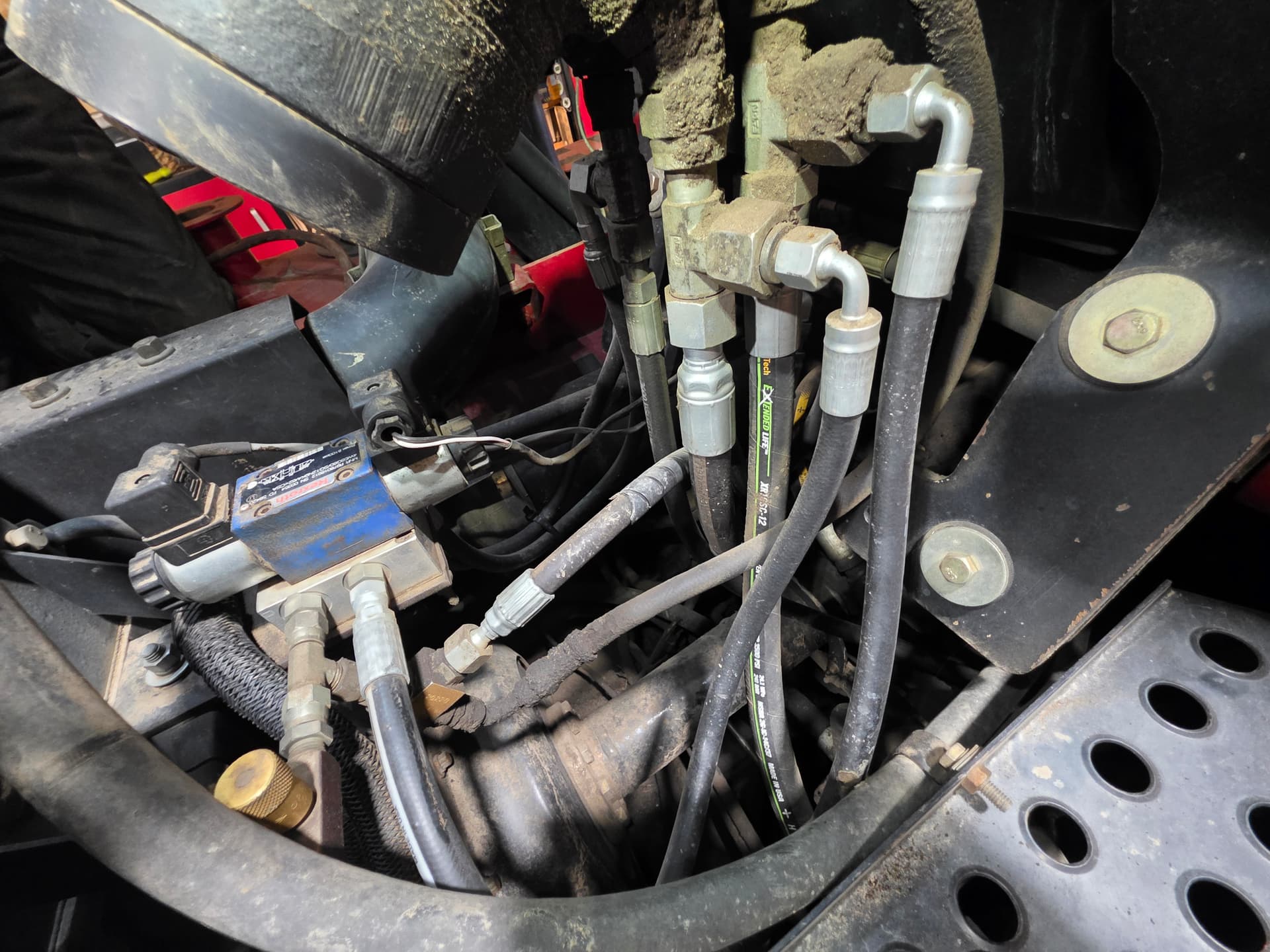

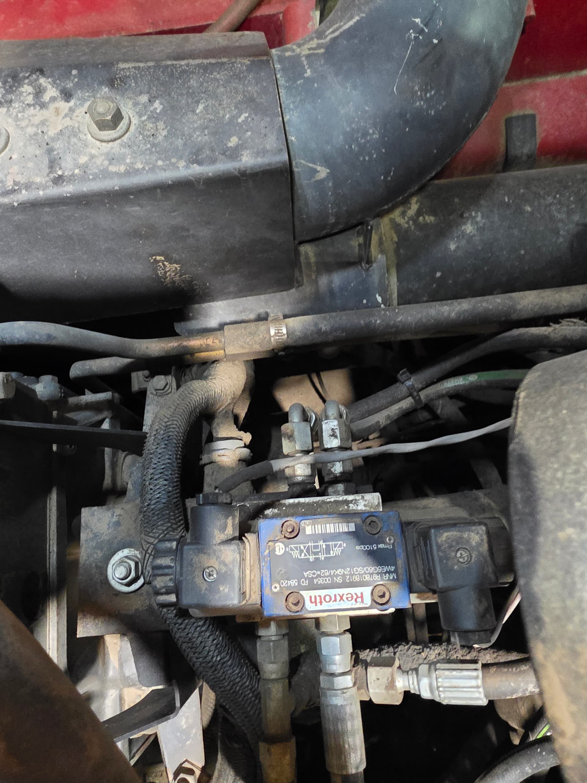

Need help with steering valve pictured in photos came with tractor stx450 quadtrac hoping to use with v4.5 board , think some one said it might be a bang bang valve ? Can i run it on v.4.5 board? How to hook up ?
Bang bang can be used with the aio but will need the min to move and pgaig set alot higher
Wire up each solenoid as normal to left and right on the ampseal
Is there a lock valve there aswell as that will need powering
I dont see a lock valve , only solenoids is the two in picture one for left and one for right , there is no pressure port either do i need that for agopen ?
Would expect a lock valve somewhere id think
You dont need pressure sensor. Also not lock valve, if you have a non reactive orbitrol, which I suppose as your autosteer hose is T ed to steer system
Ok , thanks for the input i guess i will try it
