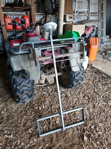

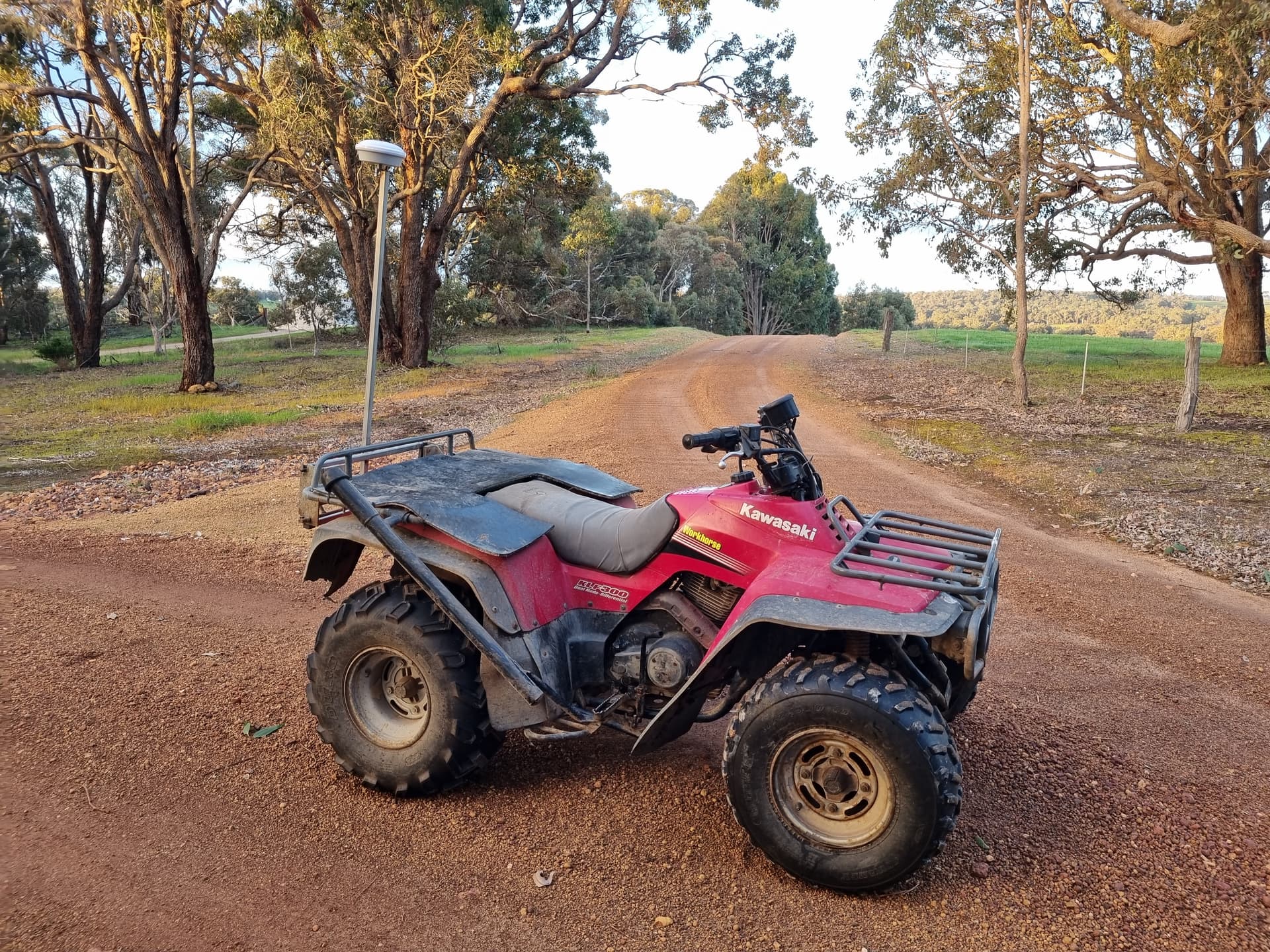

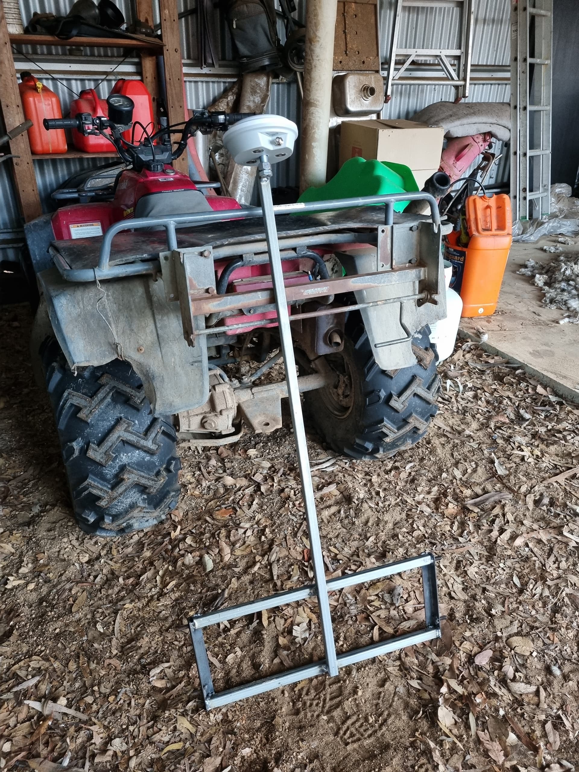

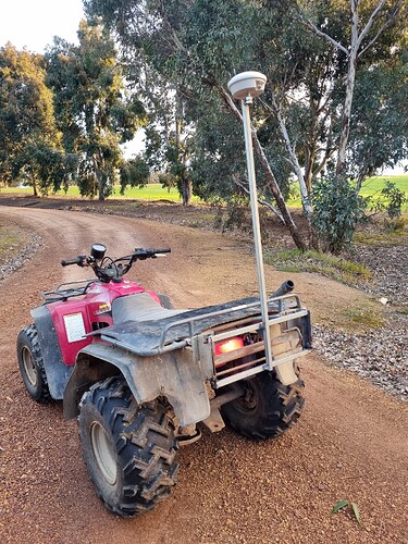

Still relatively new to using AoG, and have been struggling with making boundaries, a combination of taking time to drive around paddocks with the sprayer, navigating around trees and such with boom wings out. So decided to copy all the BTOs (big time operators) and set myself up a survey rig!
The fellow Australian/NZ farmers might recognise the C-Dax quick attach rack fitted to my trusty Kawasaki steed. I made a frame to fit the quick attach rack, with a 1100mm mast and whatever size imperial bolt fits my ali-express AG25 antenna.
The idea is that sit my spare PCB on the rear deck, laptop on the front and drive around quickly and accurately map my paddocks interior and exterior boundaries.
Thought this might be of some interest to people looking to make a budget survey rig, I would also be interested in seeing what others have set up to map boundaries with.

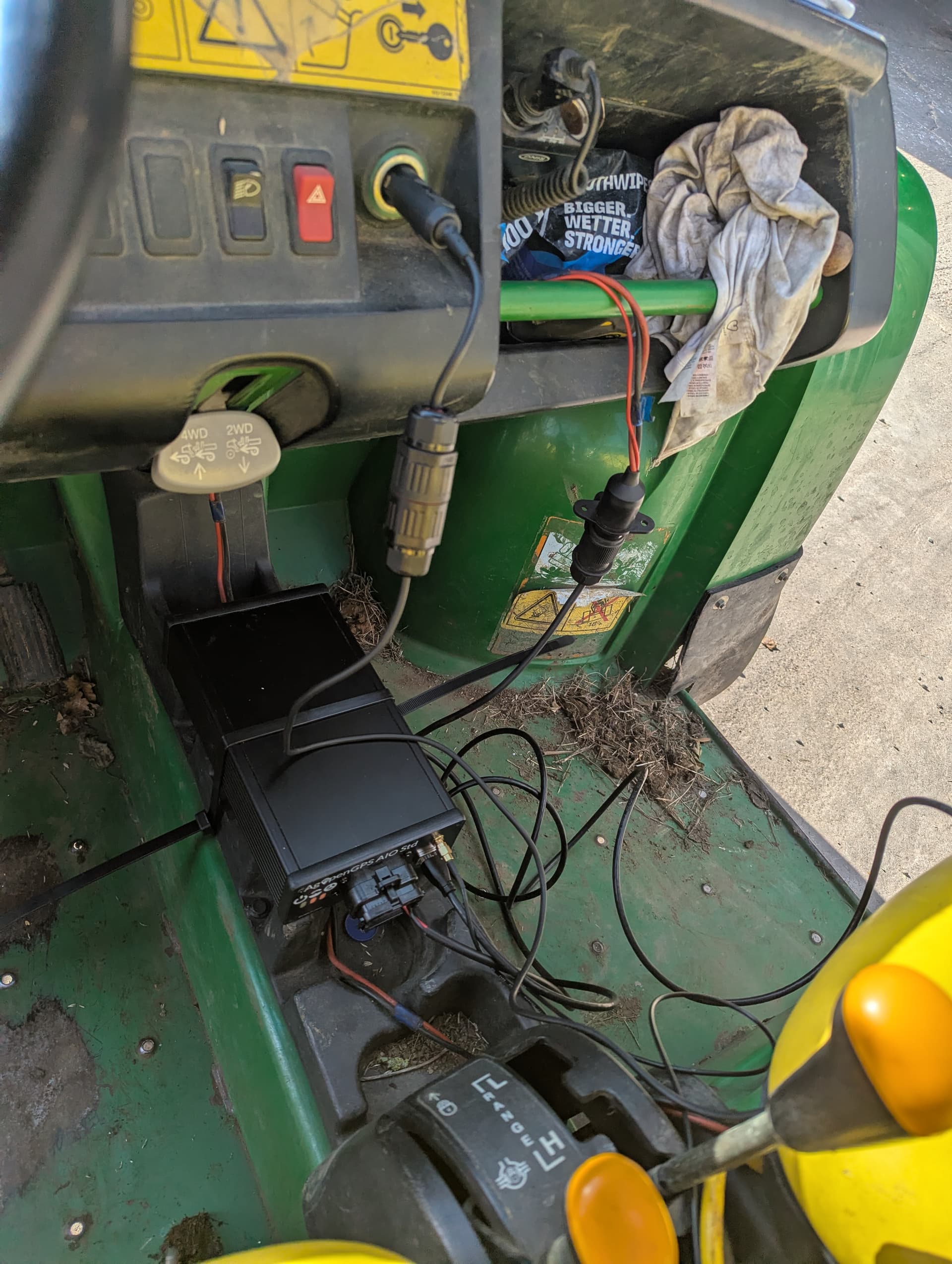

Put a PCB in a Gator yesterday doing exactly this…

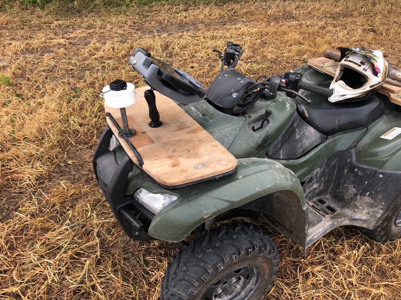

That Honda in my picture has electric power steering. The motor part is separate from the torque sensor/driver part and just has a big 2 wire plug on it. I did some investigating and I think it could be used for autosteer: Telegram: View @agopengpsinternational
My antenna is on an aluminium stick at the rack level at the side of the quad-bike and a chain hanging under the antenna. The chain is not that much needed when the antenna is so low and roll isn’t too much of an issue.

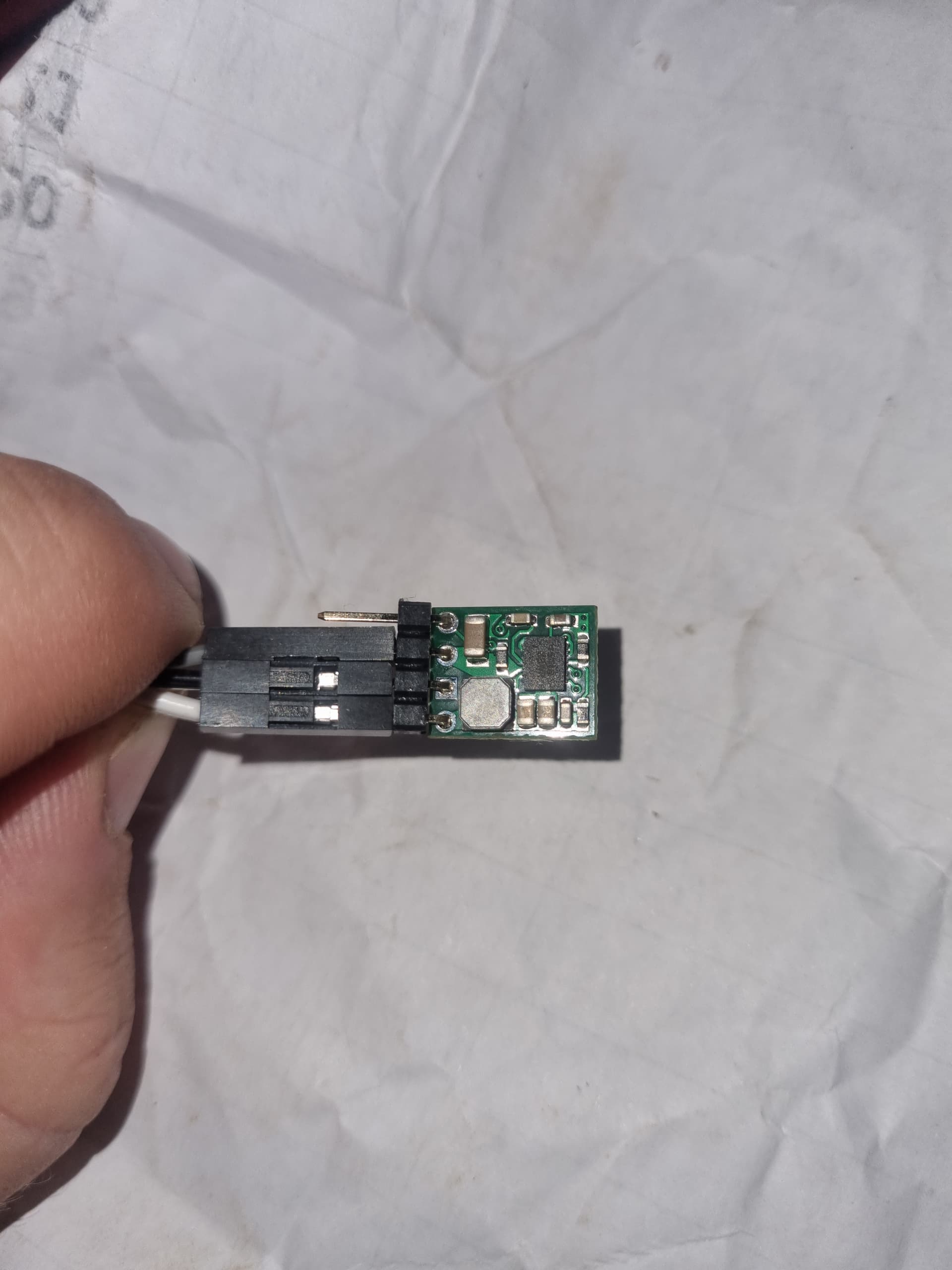

For anyone playing at home. I have found a 5v to 2.5v step down converter, will link below, that in my testing has been good to zero the wheels, i will eventually encase it in a non conductive resin to seal it and pin a 3 pin deutsch plug to match my WAS pin outs. It will be used in any situation where steering isnt needed and it can just center the wheels to keep it all happy. It is accurate to within 2°!
https://www.pololu.com/product/2841
