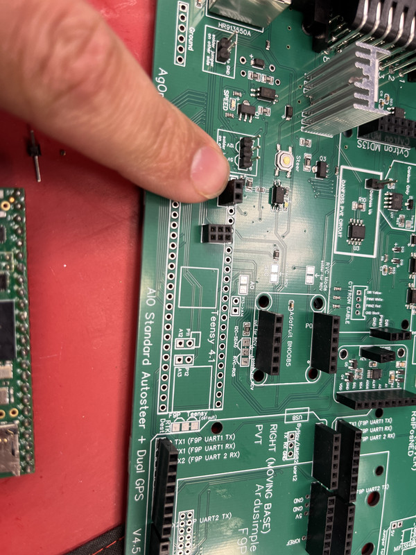

A second question, On the STD PCB there is a 2 pin header used for the teensy close the 6 pin one. Is just one pin of that used? What’s it for? I assume it’s something to do with the "Speed+ pull up label beside it?
picture of header in question IMG 6233 — Postimages

The 2 pin header under the teensy is for an extra ground to my knowledge.

That header is there for that one single pin on the Teensy, that allows it to still be powered via USB even if you cut the trace on the Teensy.

That makes sense, i read something about that in the documentation. Thanks.
