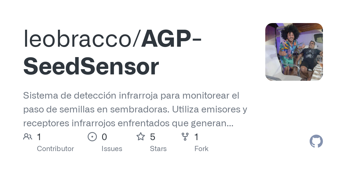

I begun to build a side app from a base from @SK21 and it would use (or be compatible with) Jim’s hardware.
Here is my Github projet (far from working):

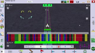

I have my planter monitor up and running on top of AOG. It runs at the same time as AOG but does not modify or require AOG. See outfarming.com and video: https://youtu.be/y2G5T6tp_XA?si=k_9lbF8p3mYqrLCn. Will have a few farmers try it out this spring (2026). Jim
