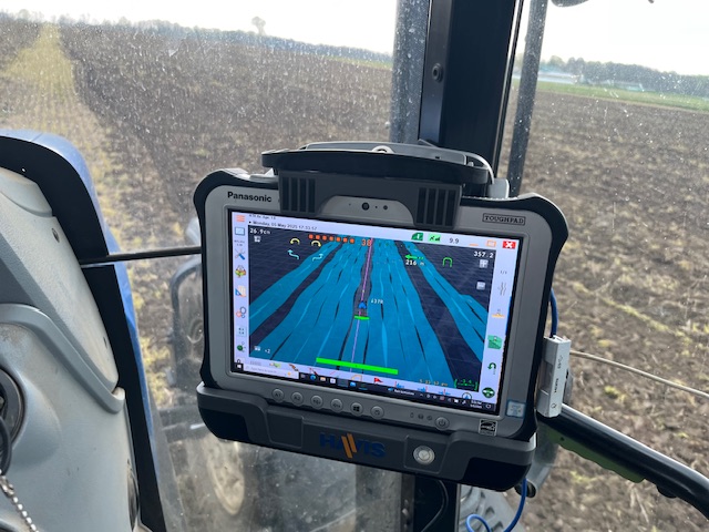

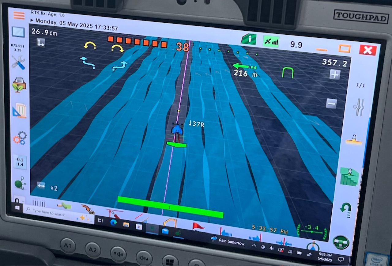

Hello All,
I have set up a base station and am casting through RTK2GO. I am connect to my base station under the source table and the little satellite is green. When driving in the field my tractor seems drunk lol and I have played with the pwm settings (using a keys motor) and have it driving a little better but I think it must be the RTK accuracy? It bounces between 20-30 cm while driving. I would really appreciate any suggestions.
Could internet speed play a role?
Thanks!
No that looks like a was or a steer settings problem. If you look up in the top left corner where it says rtk age or something like that you want a small number like one or two. Your picture isn’t super clear but it looks good. That means you’re connected to you caster in a timely manner so no Internet problems. You will get a message on screen if it’s bad.
I believe what you are referring to as accuracy is actually the distance between gps fixes.
Thanks for the response, RTK age is 1.6. I am using the WAS that was already in the tractor and a 4th gen KEYA motor. Where it says 26.9 cm is that not the accuracy of the gps signal?
No. It’s the distance between 2 GNSS positions. Should be near 0 at standstill and go up the faster you drive.

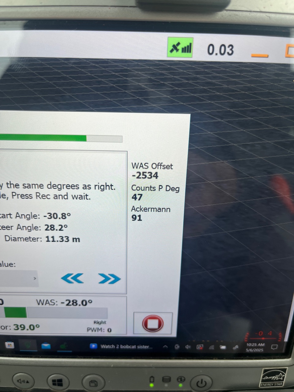

Some CNH tractors have bad WAS apparently.
If you drive manually straight, then little right, then come back straight, then the same left, does the steer angle always show 0(or 0-0.3 range) when driving straight?
I see that the CPD must have reset to 100, I thought I had set it the day before and I have lowered it back to 47 and Ackerman of 91 as per the wizard. I am hoping that’ll straighten it out as the wheel turned full lock left or right didn’t get the degrees above 8-10.
Fingers crossed thanks for the idea to check the was.
That number that bounces between 20-30cm while driving is the distance between fixes, which come in 10x a second. You’re moving 200-300 cm per second, 5-6.5 mph. What’s the number when you stand still? It should be 0.0 cm, there may be some occasional ~1.0 cm jitter.

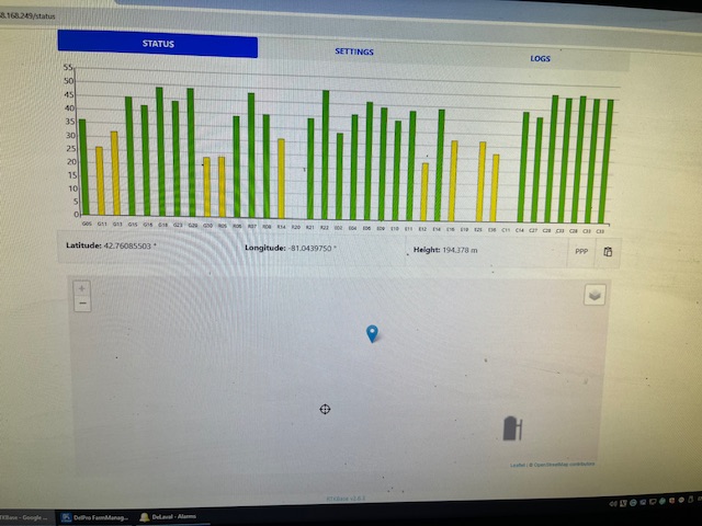

I think your issue is tuning related, but I also think your base station signal isn’t very good.
Here’s my base with ANN-MB (square black patch antenna)

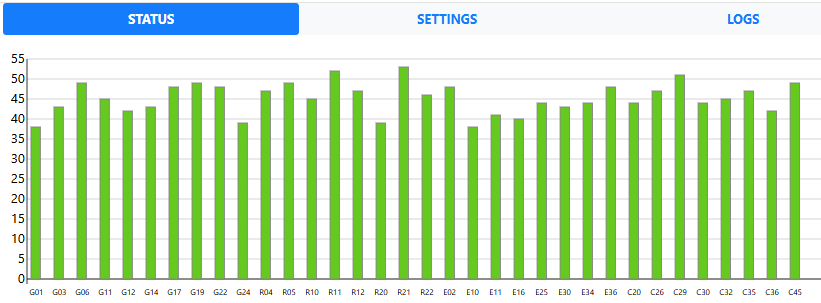

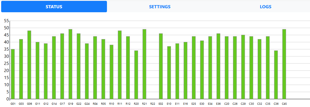

Here’s buddy’s base with the ardusimple survey antenna
You shouldn’t have so many satellites below 35 db.
