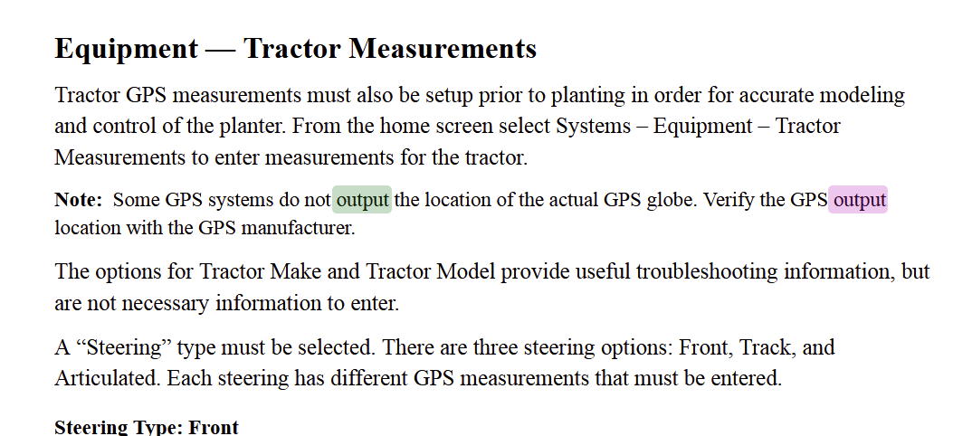

Still need to confirm that it keeps working, but here are a few important details that are found in the manual, but not on the display:
My dual setup outputs the roll-corrected signal, so on this page, I set the height (D) to 1 inch, instead of the tractor cab height.

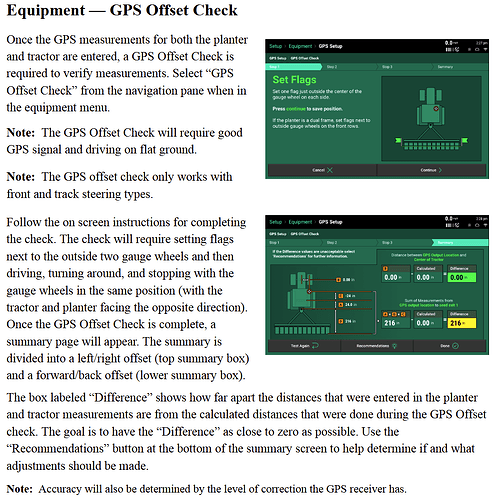

Then there is this page to double check things
After I did the whole thing, it showed I was off by 26 inches? Why? I have no idea. But I set the B measurement from center to 26. Now it’s working great!
Hope it keeps it up! Would save a lot of frustration.
Is 26" your right antenna offset?
Actually, you are right! So must be that the serial output is not center of tractor as I thought?
So far, so good. Can’t find much documentation or explanation on how the 2020 decides offsets, etc, but after making those changes, it is working for now.

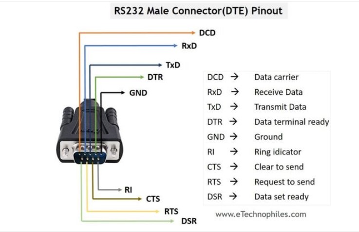

Looking for more info around AOG to precision for gps. Getting a new to me planter with precision. My dealer said they have a serial adapter cable I could use for the connection. Sounds like it is doable but is there a pin out map available on the pin outs on the serial off of the tablet? Or did you just plug in and it worked. Thanks.
The serial data cable is very simple, likely very expensive from a dealer.
You can google for RS232 connectors. Your planter likely works with ground and Tx data from the GNSS receiver (RxD would not harm).
@theGtknerd setup our system for us. He wired the serial output (Tx and GND) from the roofkit directly to a four pin round like the 20/20 uses, then we didn’t need to buy the adapter cable. (The adapter cable isn’t terrible expensive, but more connections tend to mean more potential problems.)

So is the pin out for the RS232 in the picture coming off of the tablet side or from the receiving side on the 20/20 monitor?

The adapter cable provided by Precision has all available configurations, you just need to figure out which 2 of the 4 plugs to use. If you are running off of the tablet you need to set up the software yet.
