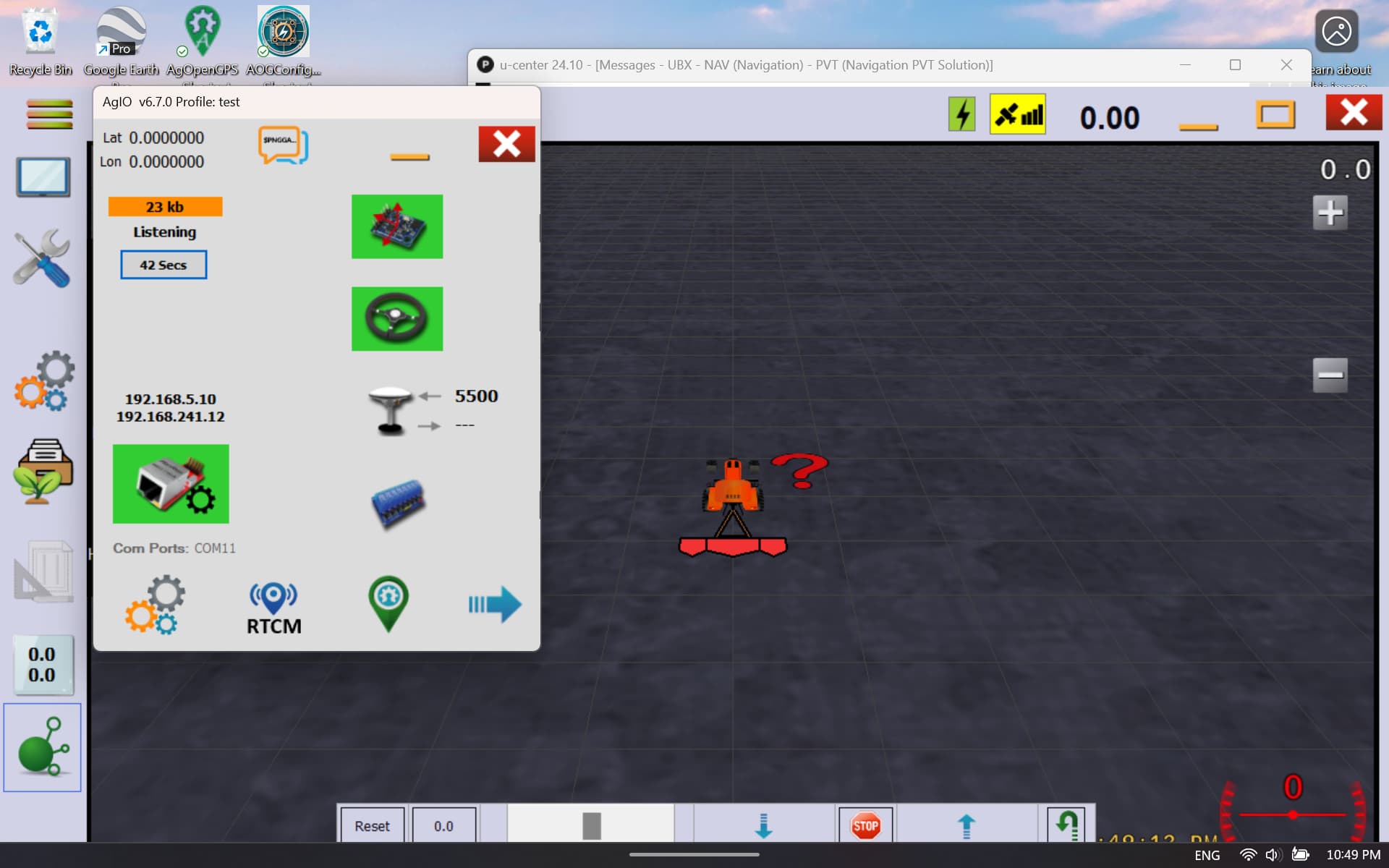

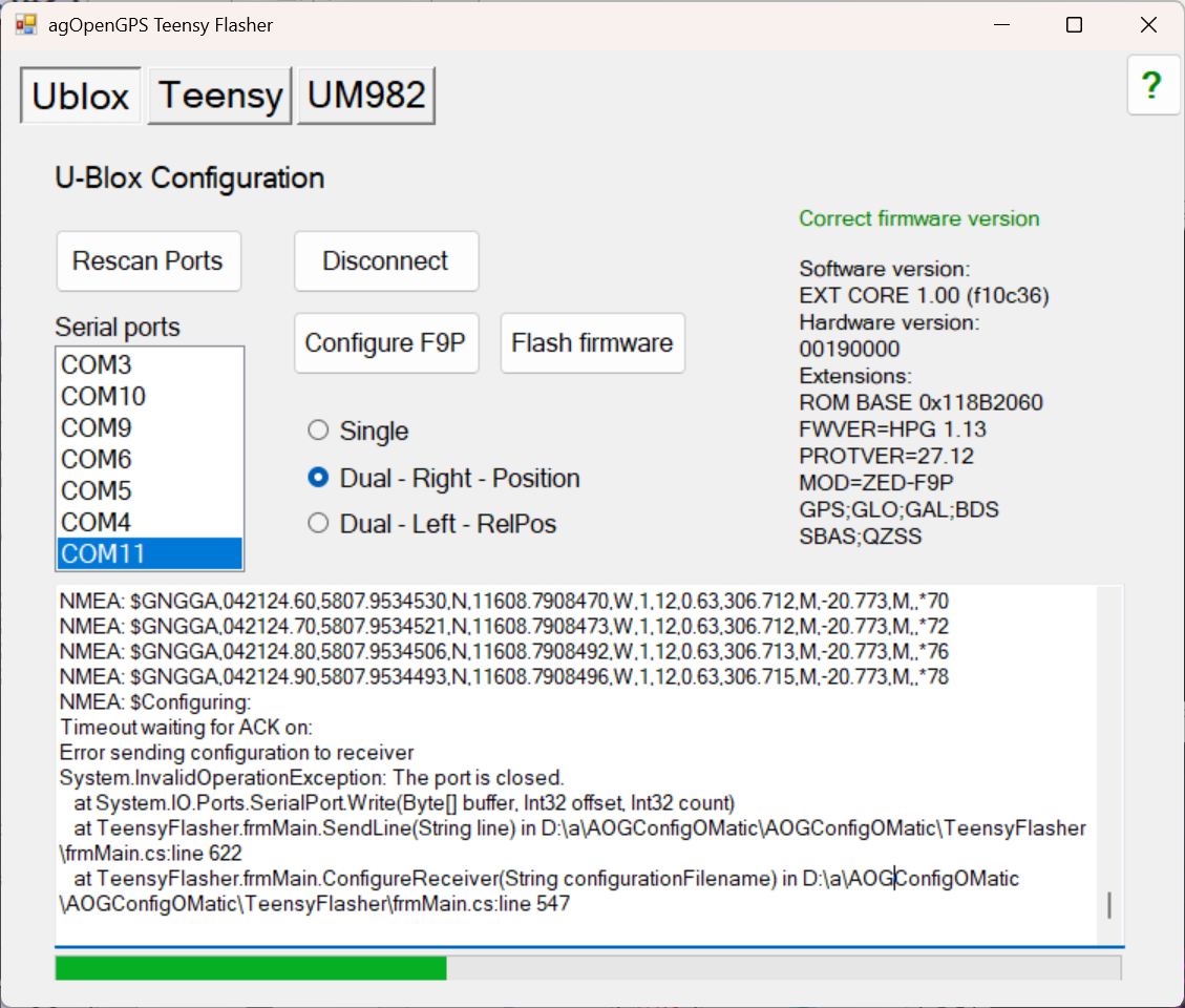

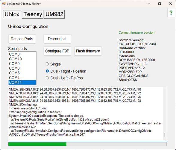

Then on the pcb, using dual receivers micro simplertk2go, I was trying to use the teensyflasher for auto configuration but keep getting errors saying a bunch of things including that a port is closed. Using ucenter, however, I have no trouble programming it. I have programmed it with the rover 10hz file from ardusimple, but no connection to the software via udp (steer and imo connects however). I have tried so many things with the teensy flasher, most recently switching them around and finally getting one to take the “single” configuration, but still no connection. I have a friend’s base station I can connect to for NTRIP just to test, and I can see corrections coming in and there seems to be some gps data as well, as shown by the black screen, but my light in AGIO will not turn green and my led at the receiver stays solid red. I have tried so many things and had hours with an IT guy checking ports and trying all sorts of things that I don’t understand, to no avail. I feel very stuck. Any advice would be appreciated.
