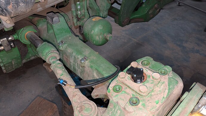

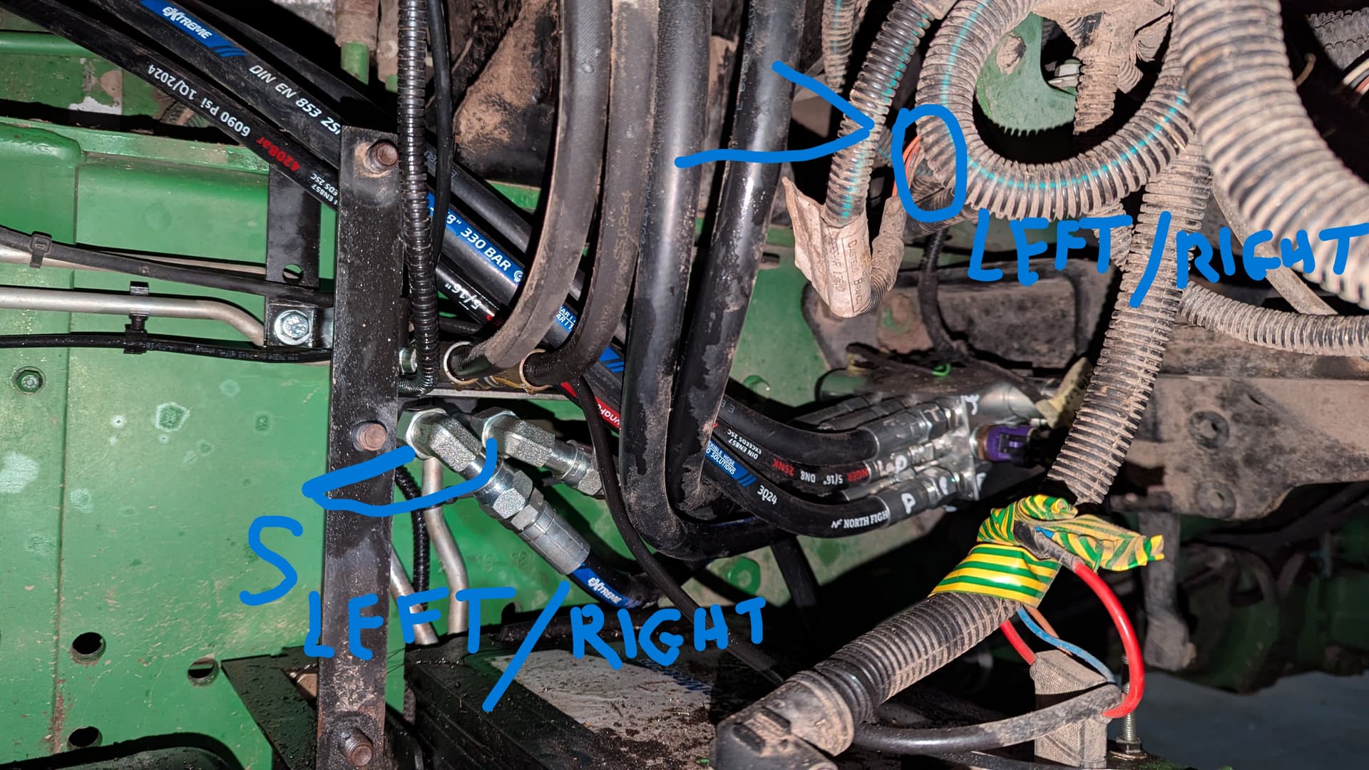

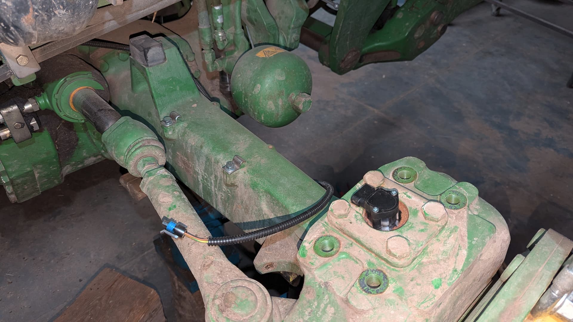

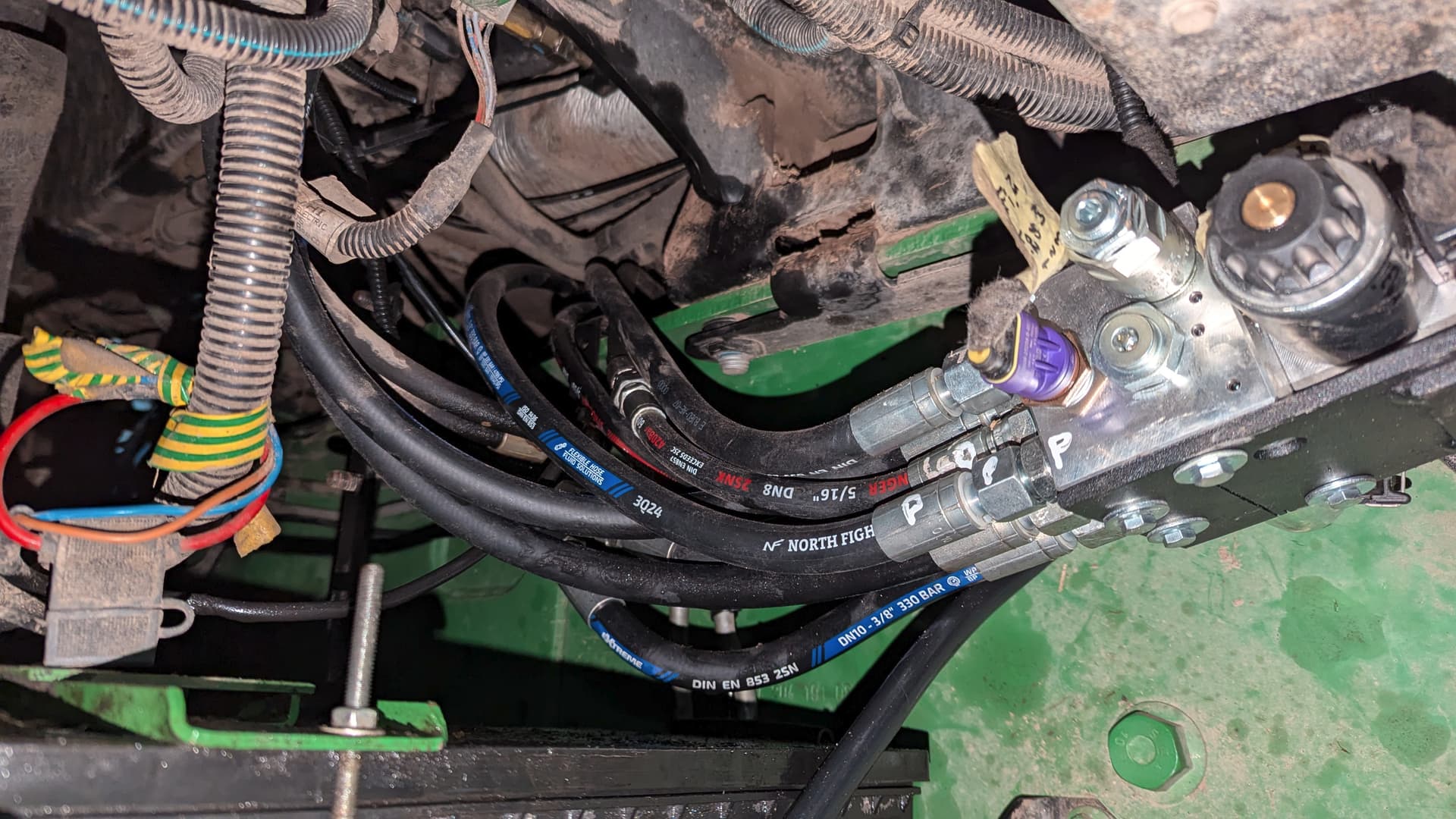

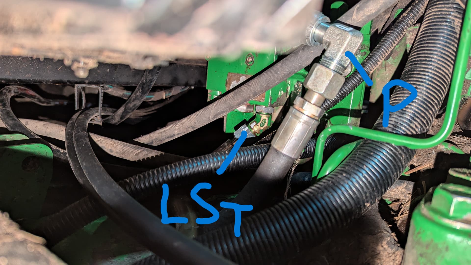

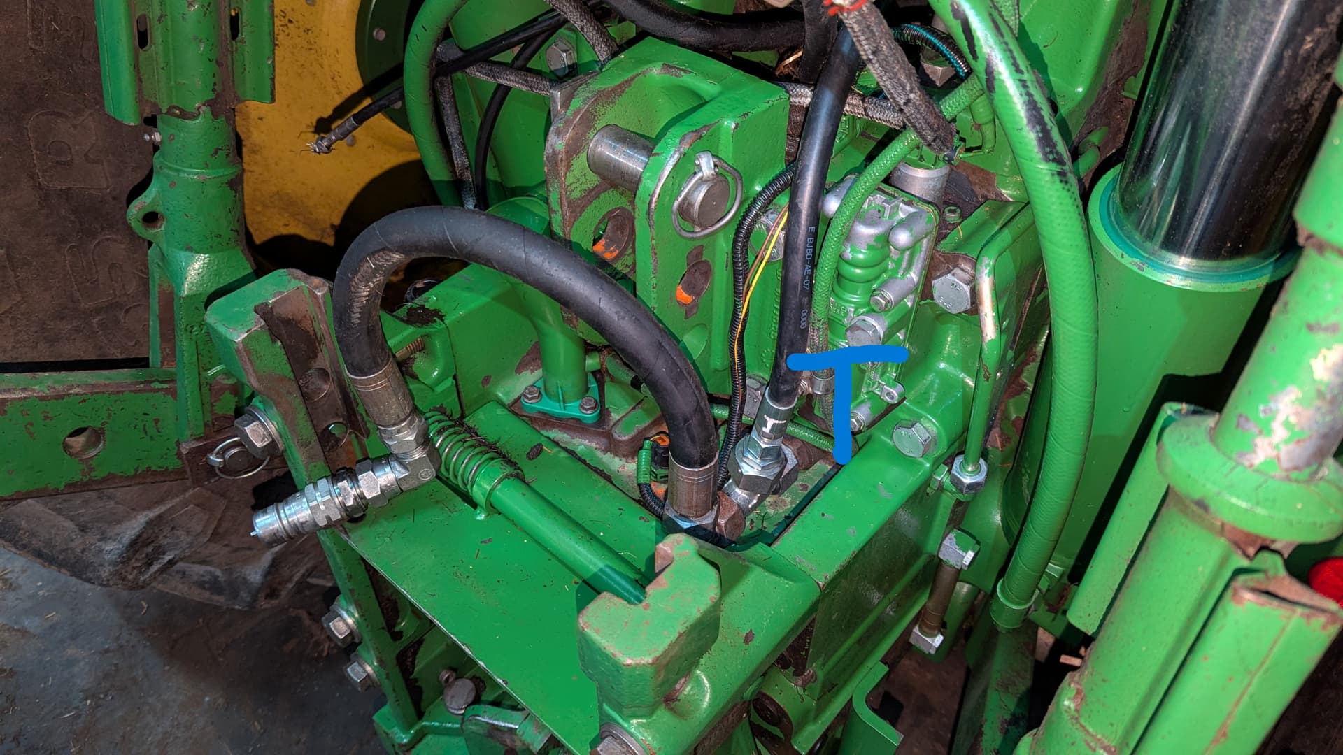

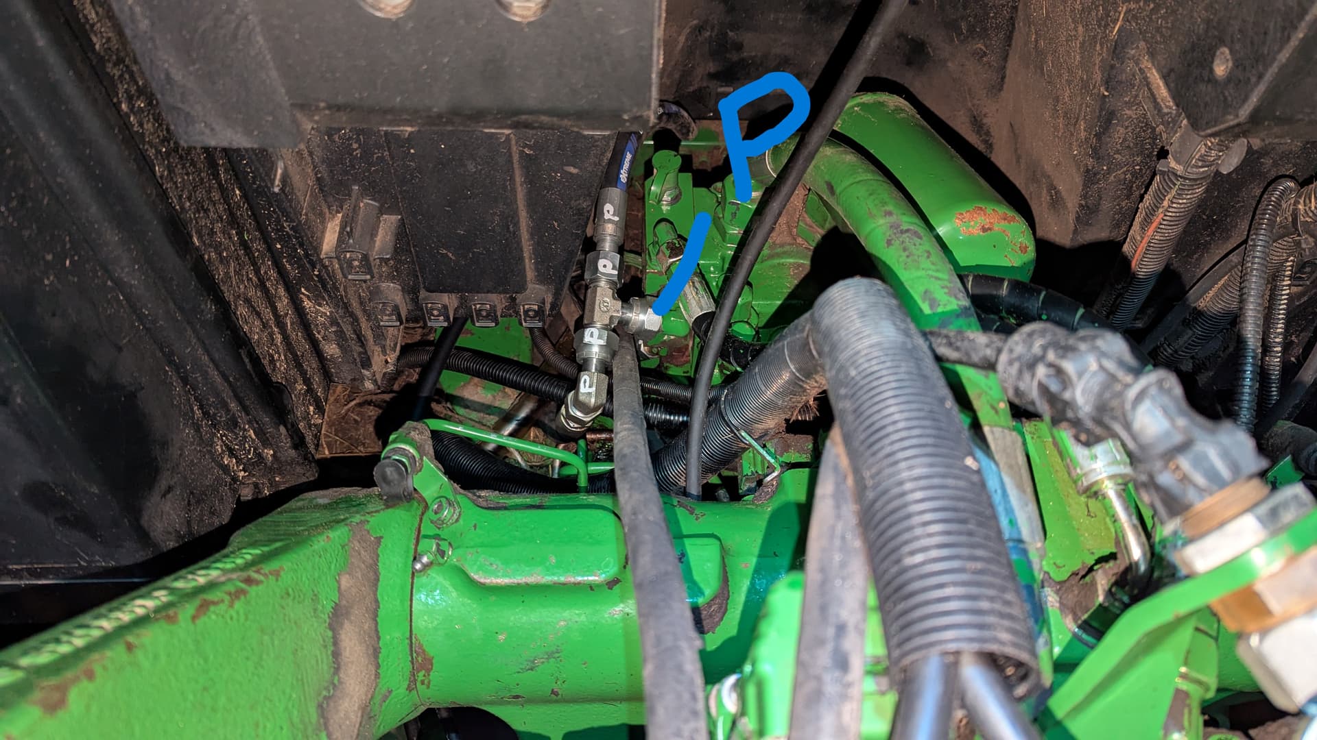

I installed ‘LS 30L baraki valve’ in JD6150M on the right side behind the stairs, above the battery (it’s simillar to 6920; probably you have more space). Also, installed JD W.A.S. on the front wheel spindle
Check e.g. navisklep.pl for parts
Some pictures below
Interesting! Thanks!! I’ll have to study those pictures some. Can that system “feel” when you take back control by moving the steering wheel, or do you have to turn off Auto steer to keep it from fighting you?
Yes there is a pressure sensor on the valve, you can adjust cut out pressure in the software
