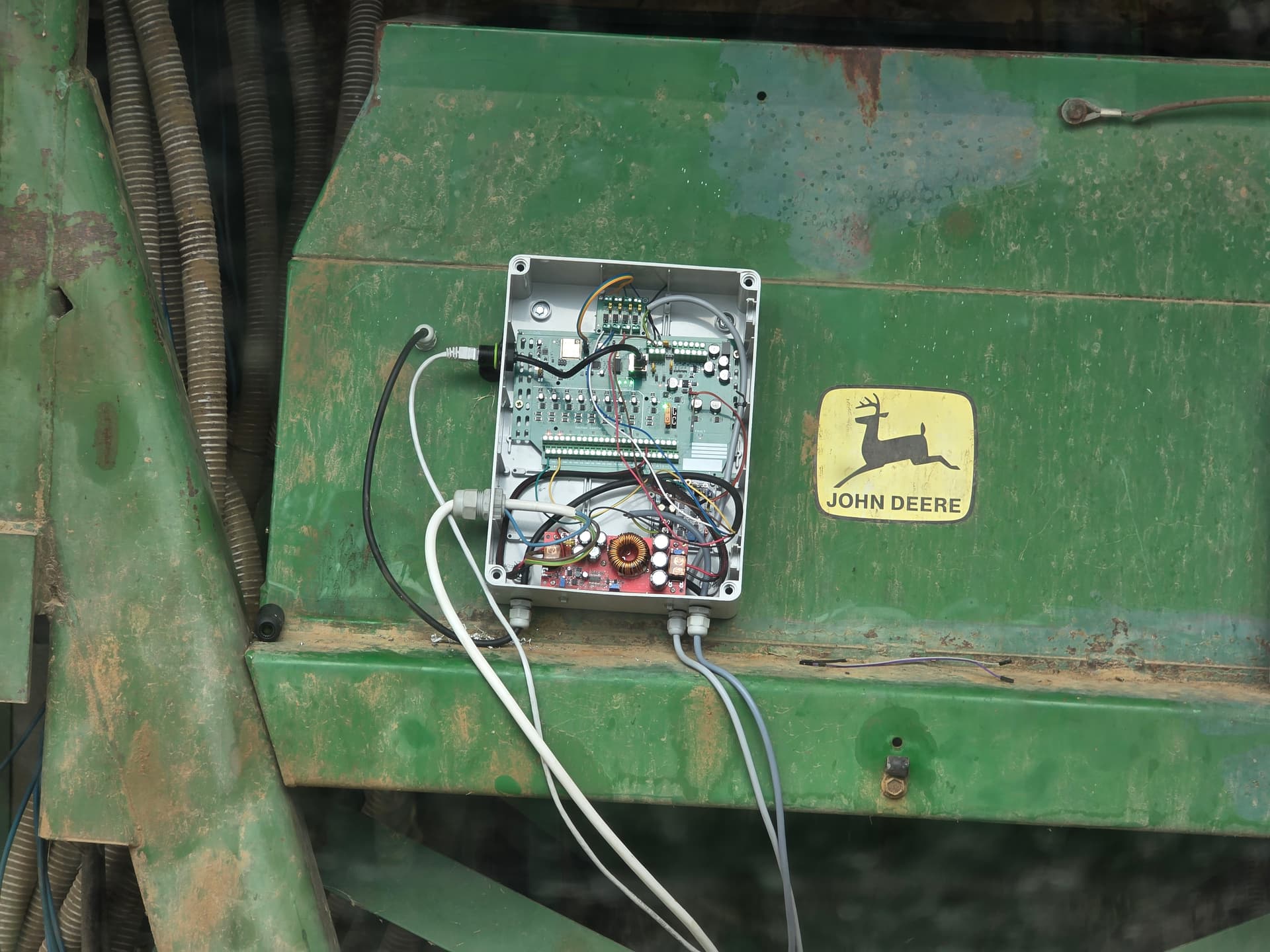

Although we need to stress test it but I’d like to share the progress on the seeder conversions. Maybe we get more insight.

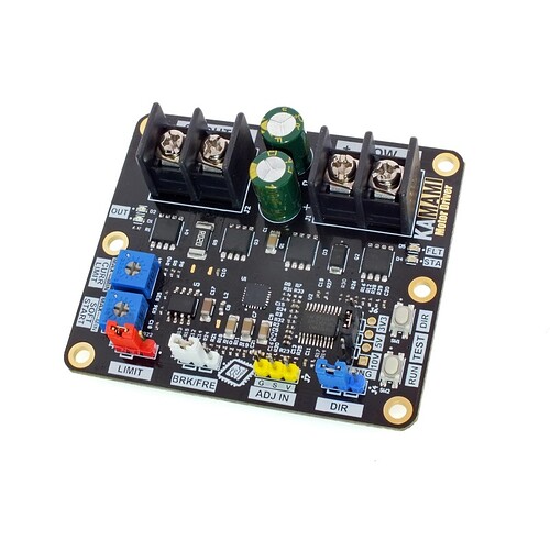

Controlled by a Kamami motor driver. Which is like cytron but has a few key differences:
Screws to connect wires. Soft start (although I had this almost at fully off).

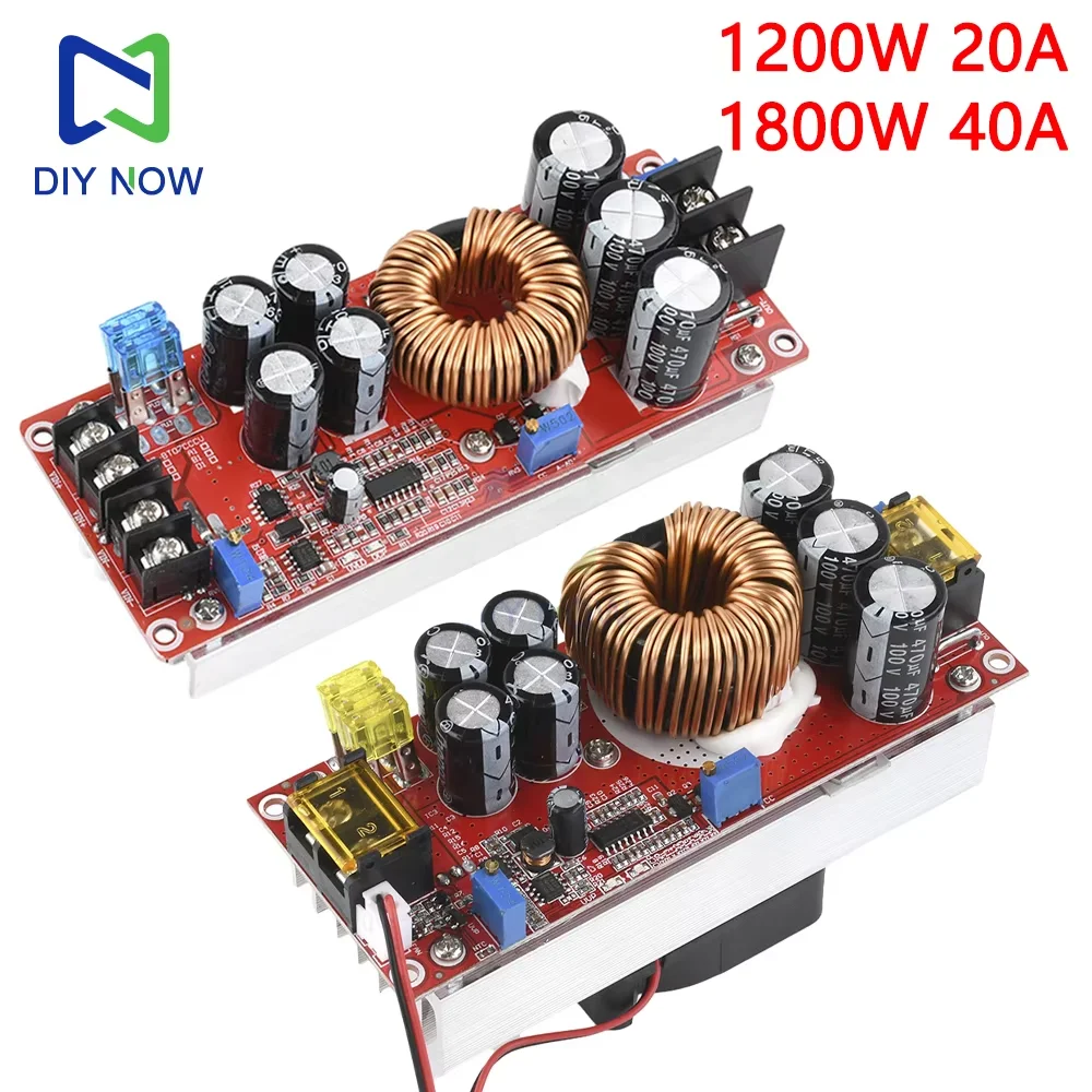

Power comes from a high-power step-up converter; it’s critical to check and set the output voltage before connecting anything. We’ve seen units set as high as 70–80V.

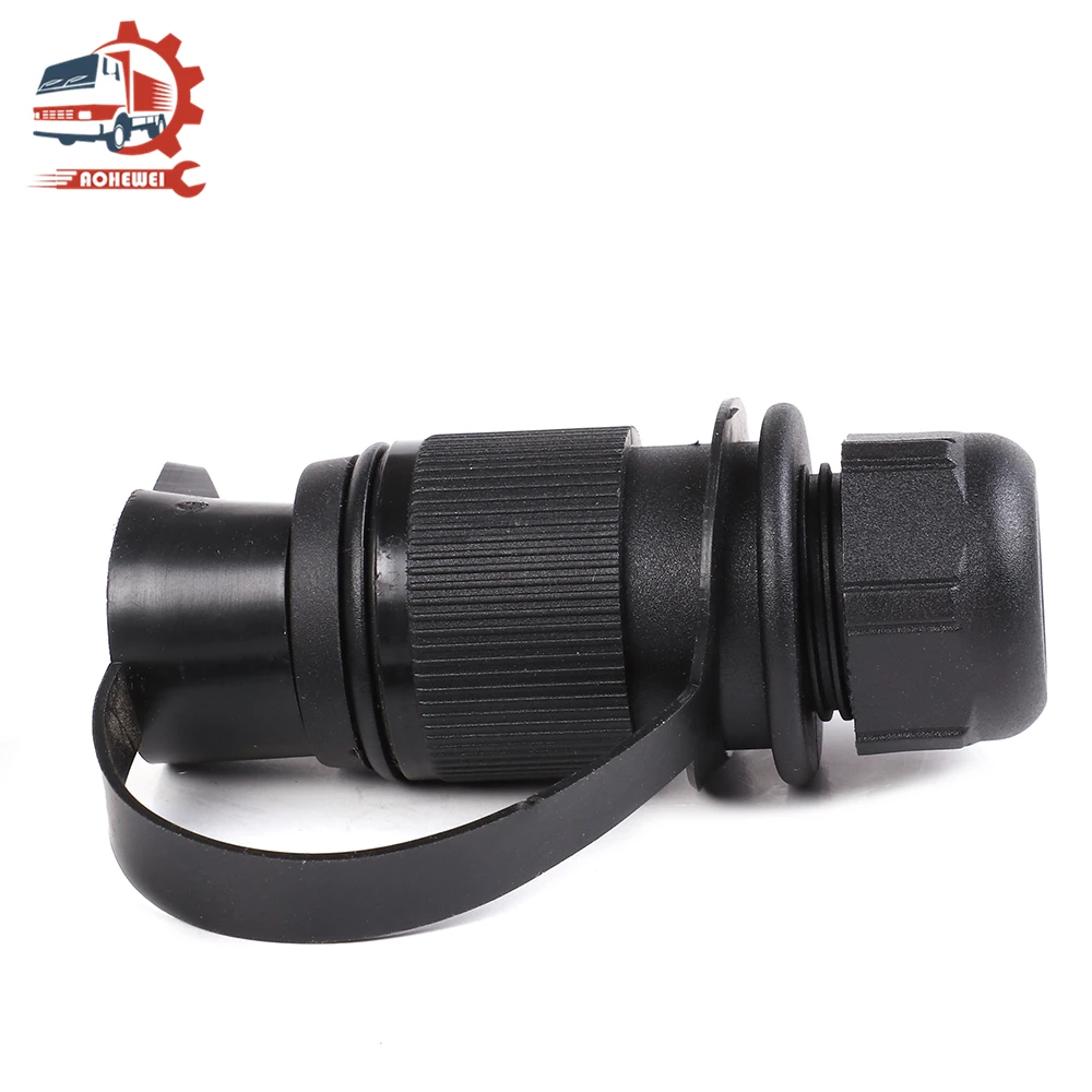

Power connection I think this is the only seller who has a proper cable gland:

It’s my own board that I plan to expand with more optos based on what I’ve seen.
Also would be nice to have a motor driver FET on board.
