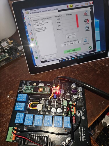

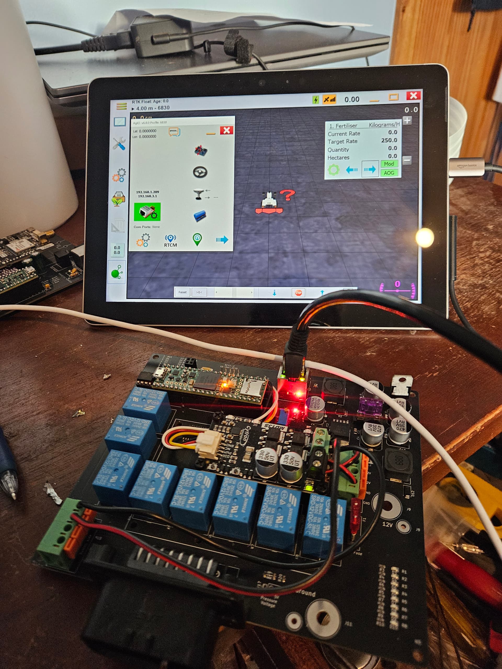

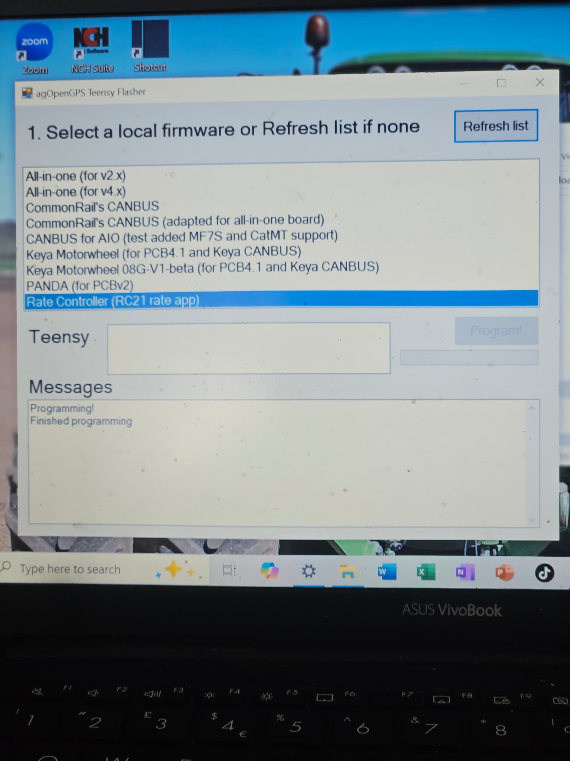

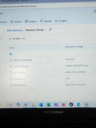

I am currently trying to set up a RC11-2 i am in the process of trying to connect it to agopengps but as is shown in the picture above it is coming up as a network on the left hand side of the tablet screen but is not turning anything green, is this to do with what i have flashed the teensy with i have tried what is shown in the 2 pictures below or is it something to do with the physical board itself?
It needs to be flashed with this app: GitHub - SK21/PCBsetup: Setup software for AgOpengGPs rate control and steering modules.
Thank you for the reply i falshed the teensy with the Teeny rate firmware, i am getting the green Mod light on the rate control app should the machine light be green on AgIO
No it doesn’t use the machine light.
