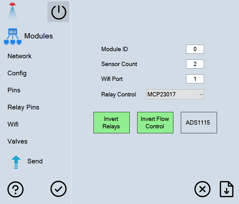

The firmware hasn’t changed in awhile.You can set up the board on the module page:

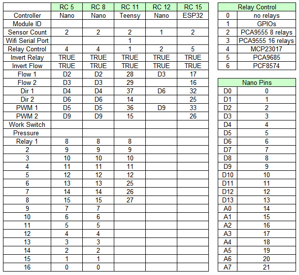

The pins to use are here:
If using pin 2 for flow the nano has to mount on the board first with stacking headers. Pin 2 on the ethernet shield must be removed before mounting on top of the nano because it interfers with the signal. You could just use pin 3 to avoid that problem.

There is a setup program here: GitHub - SK21/PCBsetup: Setup software for AgOpengGPs rate control and steering modules.
It has default hex files that may be the newest. If not you can select those hex files from the release.
