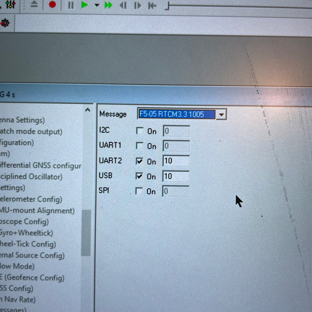

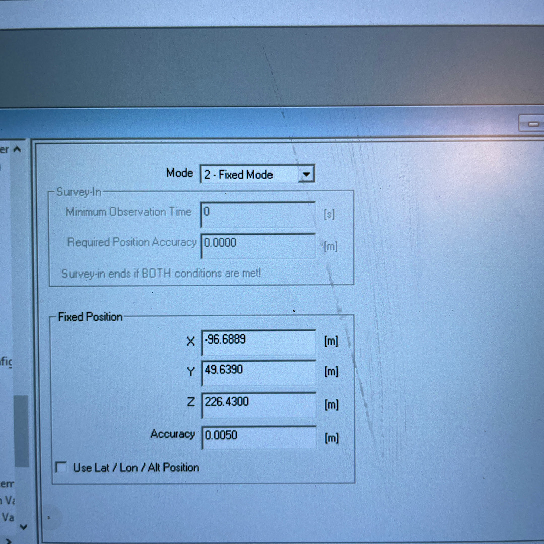

I have tried that but it doesn’t seem to send the 1005 msg and it “seems” that AOG needs the 1005.

Fixed mode on. See below.
1005 enabled.

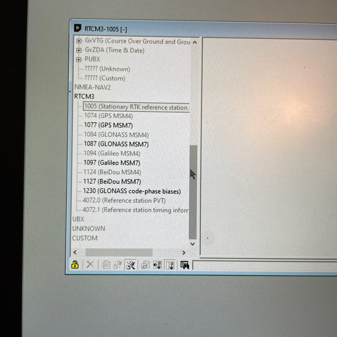

1005 not sending

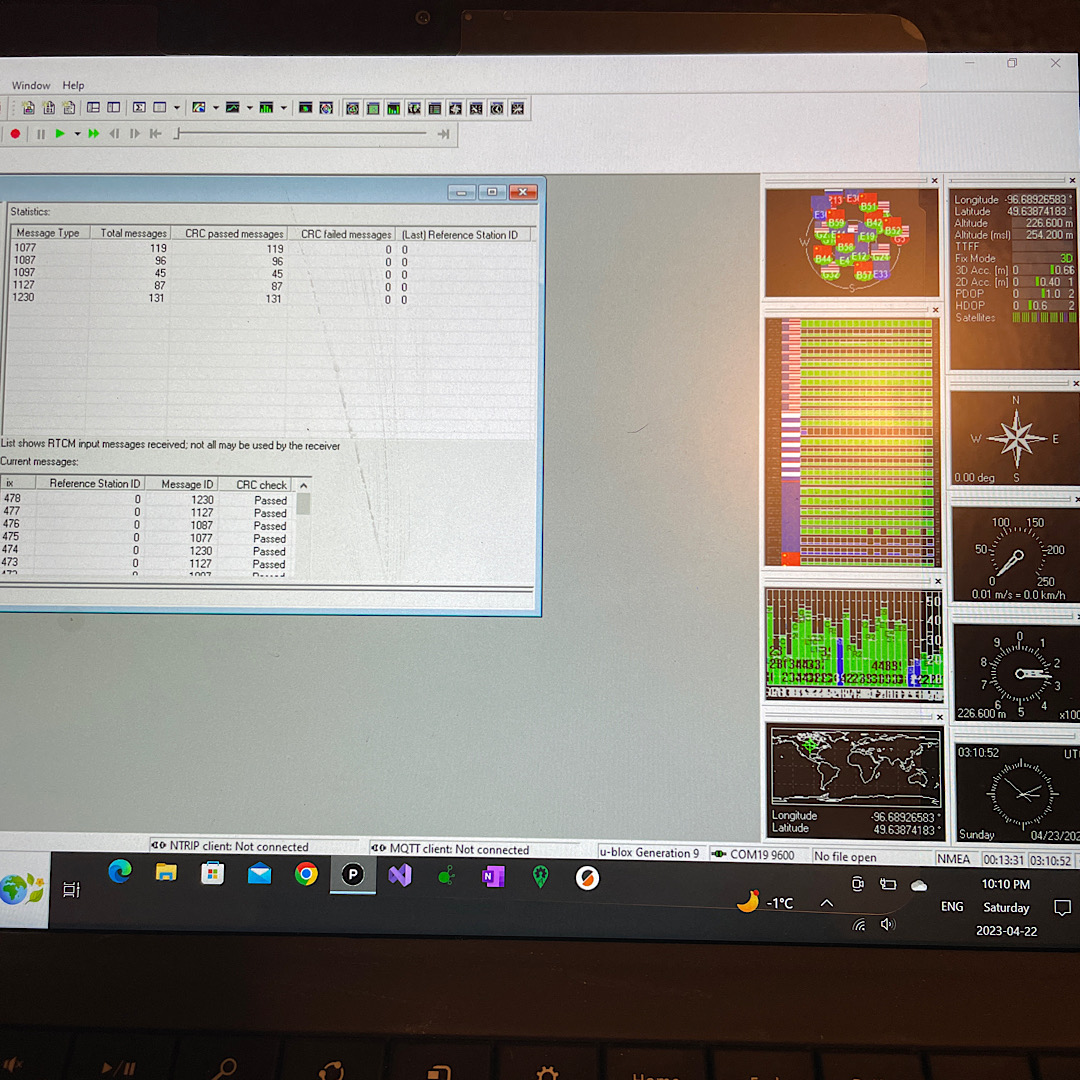

Below is rover receiving all messages but the 1005
Why does it say 3D?
AGO just says single GPS if I enable the receiver COM
So does AGO require 1005? To my knowledge that is the only difference from the working survey in station vs the fixed station.
You have entered base coordinates in an incorrect format, not x,y.z but rather latitude/longitude figures.

Yeah to use normal latitude, longitude, and msl altitude just check that little box that says "use lat/lon/alt.
Is 1005 a msm7 message?
@NorthernFarmer and @torriem Not sure how to mark this as the solution but this seemed to fix my problem! Thanks
No, it’s not part of MSM7, but it is required by all rovers, including the F9P. Can be every 10 seconds or more.
