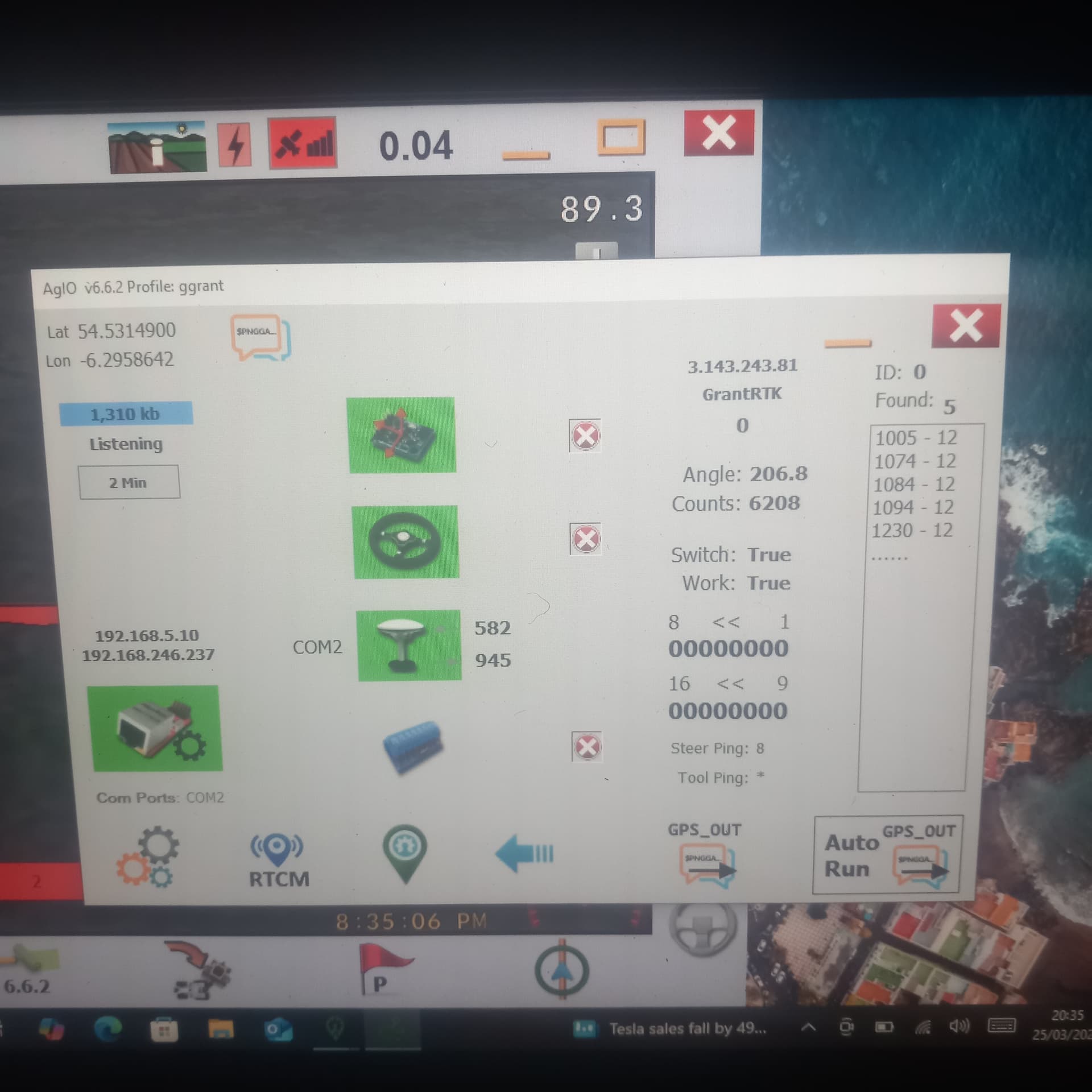

I have set up a new all in one board with single antenna. I am just looking to use it for basic guidance for now so i have no was fitted. I have followed all the instructions for setting up the ntrip but still cant get rtk. I have filled in the email address and password. Also when i drive straight in single gps it doesnt move properly on the screen, as if its trying to move sideways. I have configured the f9p and teensy is it possible this hasnt worked properly? Thanks
Something surely isn’t right… are you parked underneth some building? You only receiving 5 messages from base, not enough for rtk fix… should be 12-15

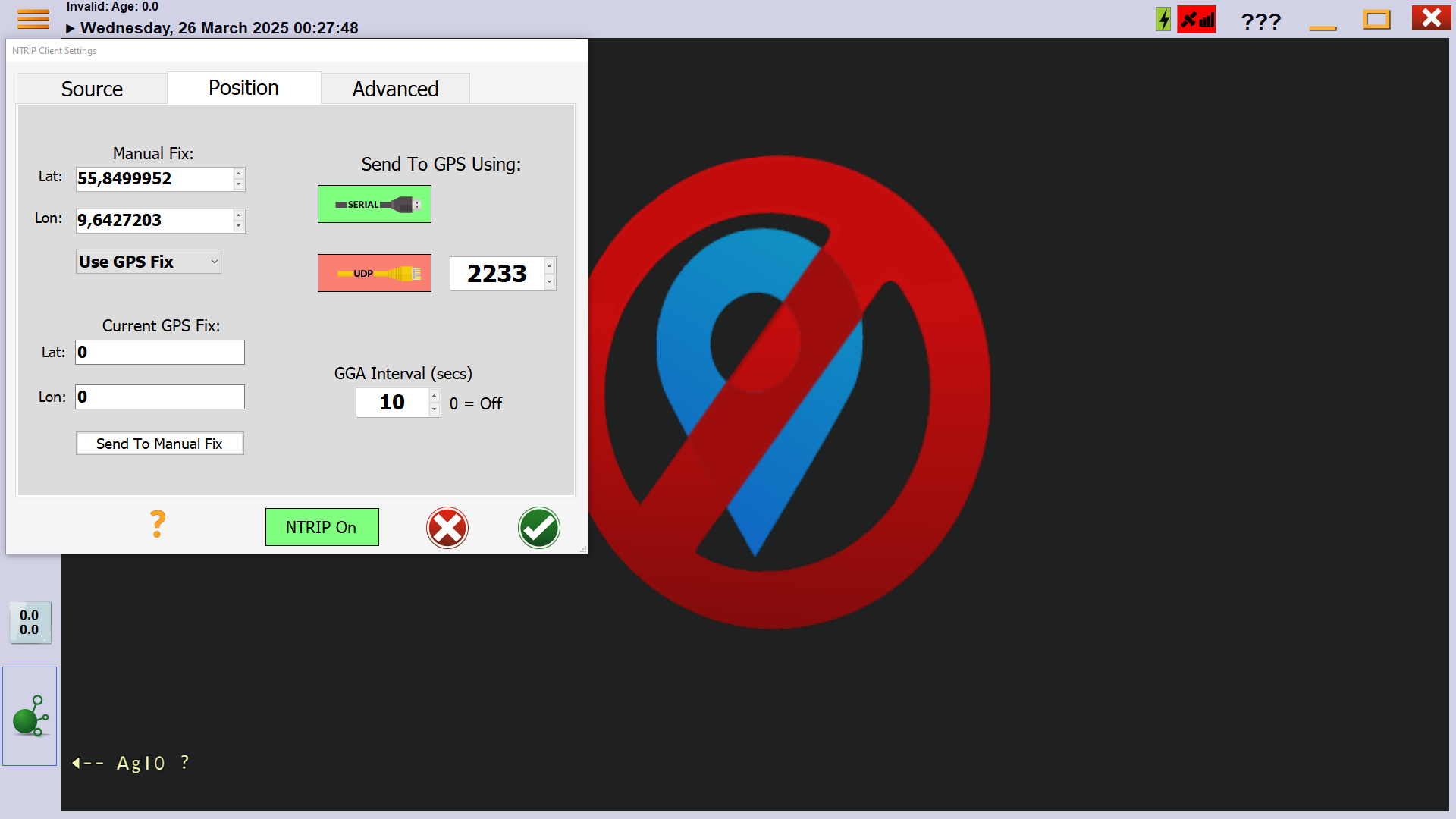

Also, why using both serial and udp communication? You have usb on com 2 and udp connected.

We are not talking numbers of satellites here, just different constellations. I use 4 constellations which means I also added 1124 (Beidou) to NHman´s list. I get 6 messages in Agio but I believe you could do with only 2 , the Base position (1005) and GPS (1074) as long as both Base and Rover can see minimum same 8 GPS satellites.

I think you have missed the setting of sending messages over UDP !
So change UDP to green could help.

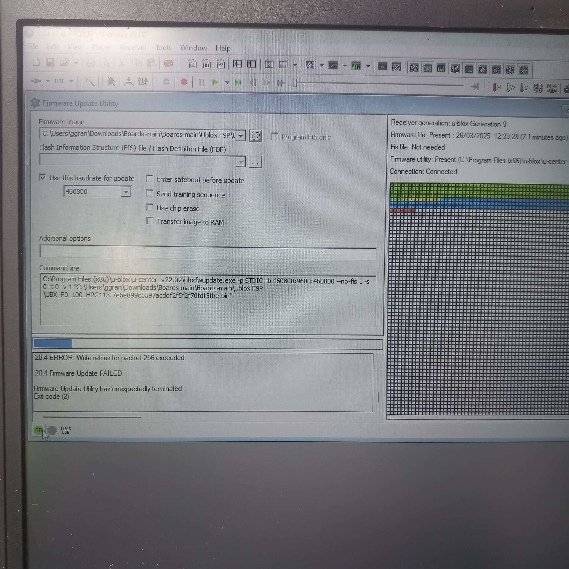

So i still cant get rtk to work and i dont think the gps is right either it seems jumpy. I tried to update the f9p firmware again with the configomatic, this didn’t work so i have tried the u centre and it wont work either
All seems to be working now. My f9p musnt have been configured correctly. Turns out the usb cable was faulty i was using to configure it. Difference cable, configured properly and rtk working now. Thanks for your help everyone.
