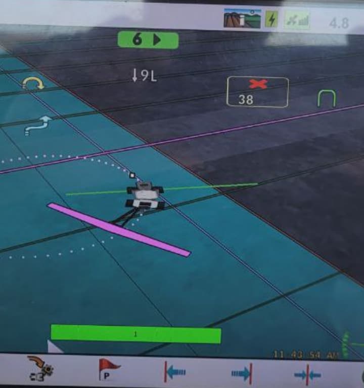

I have an implement with single section control using a 6 second look ahead. I recorded a boundary half a width to the right while driving the headland. Every time I turn around at the end, my green trigger line crosses the boundary and turns my sections on. I’ve tried turning the coverage % down, but too low and it doesn’t act proper in the rest of the field. Also tried the boundary toggle but didn’t seem to make any difference. Is this a bug? Can’t it be set so it never applies outside the boundary?
Here is the picture
Surely it would help if the look ahead line followed the curve and don’t just extend straight ahead.
As was suggested on the telegram chat, I created a headland and as long as the toolbar fully crosses the headland, my section remains off. Thanks!
Oh yes. That’s a nice workaround.:+1:
I didn’t thought at that last year spreading fertilizer, I was just switching the master off each time.
Oh that was my problem, as I make only one pass around, the tool is in the working area a long time, so I had to use the master switch.
