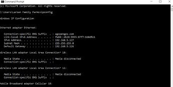

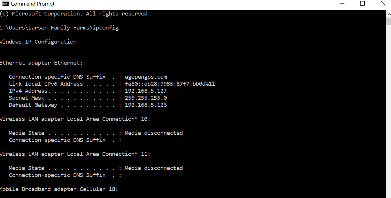

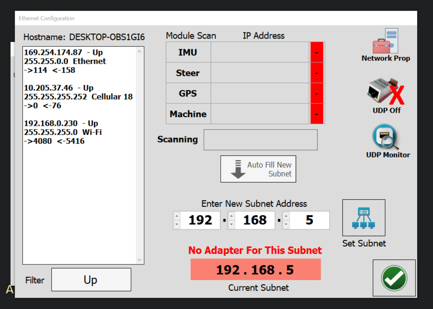

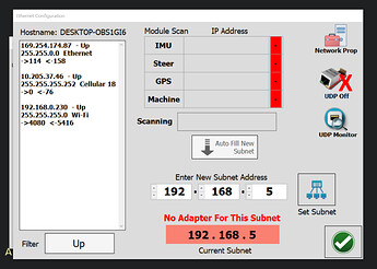

Before the AIO board is connected the ethernet interface is using its self assigned IP address.
Within a few seconds of connecting the AIO board the computer will be assigned an IP address (the next address after the one the AIO board has been configured to use).
ipconfig shows the IPv4 address, gateway, and subnet mask. The custom DNS suffix confirms it got this configuration from the AIO board.

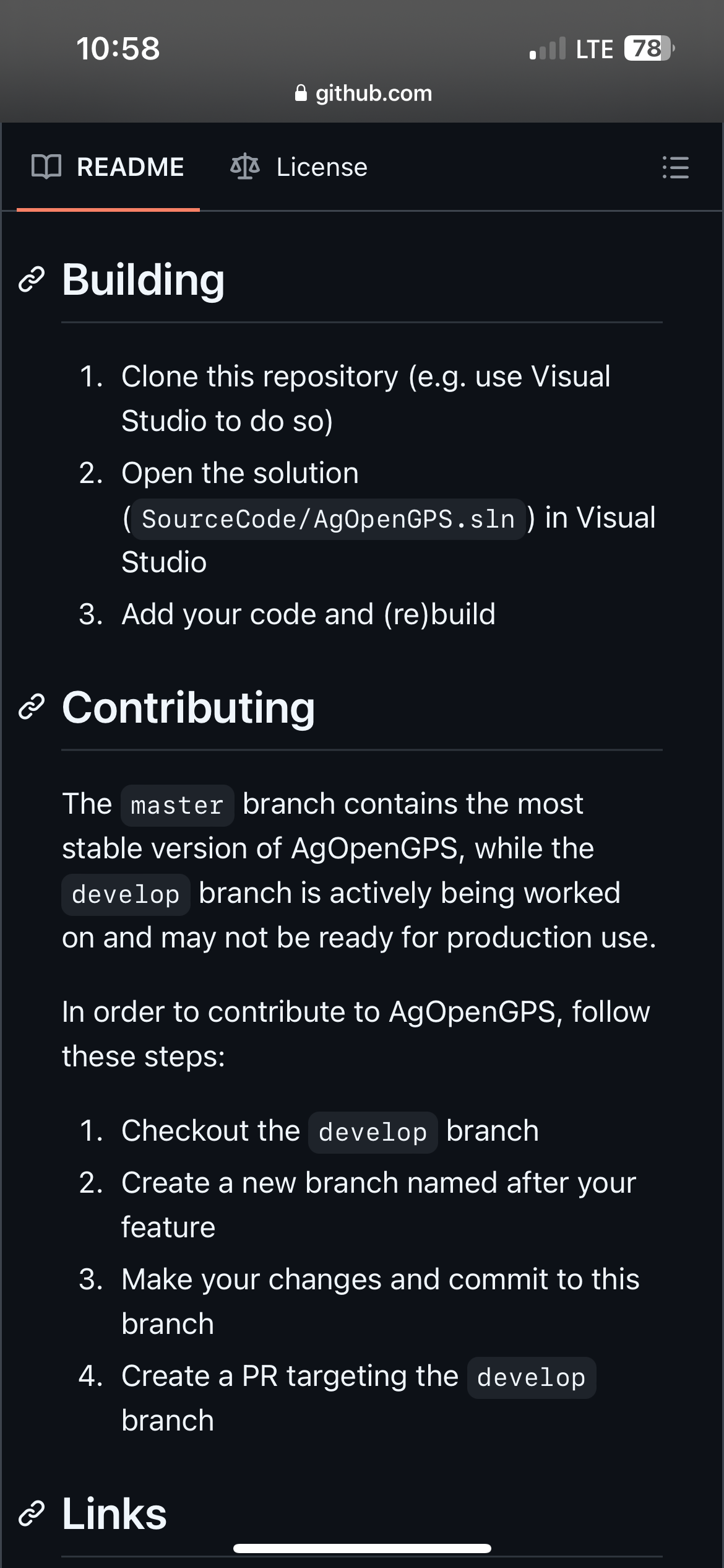

Is there a process for testing / merging a new feature?
Please do a PR on the Boards repository
That’s for the AgOpenGPS program, not the related firmware. But the approach is almost the same except there is no develop branch in the Boards Repository

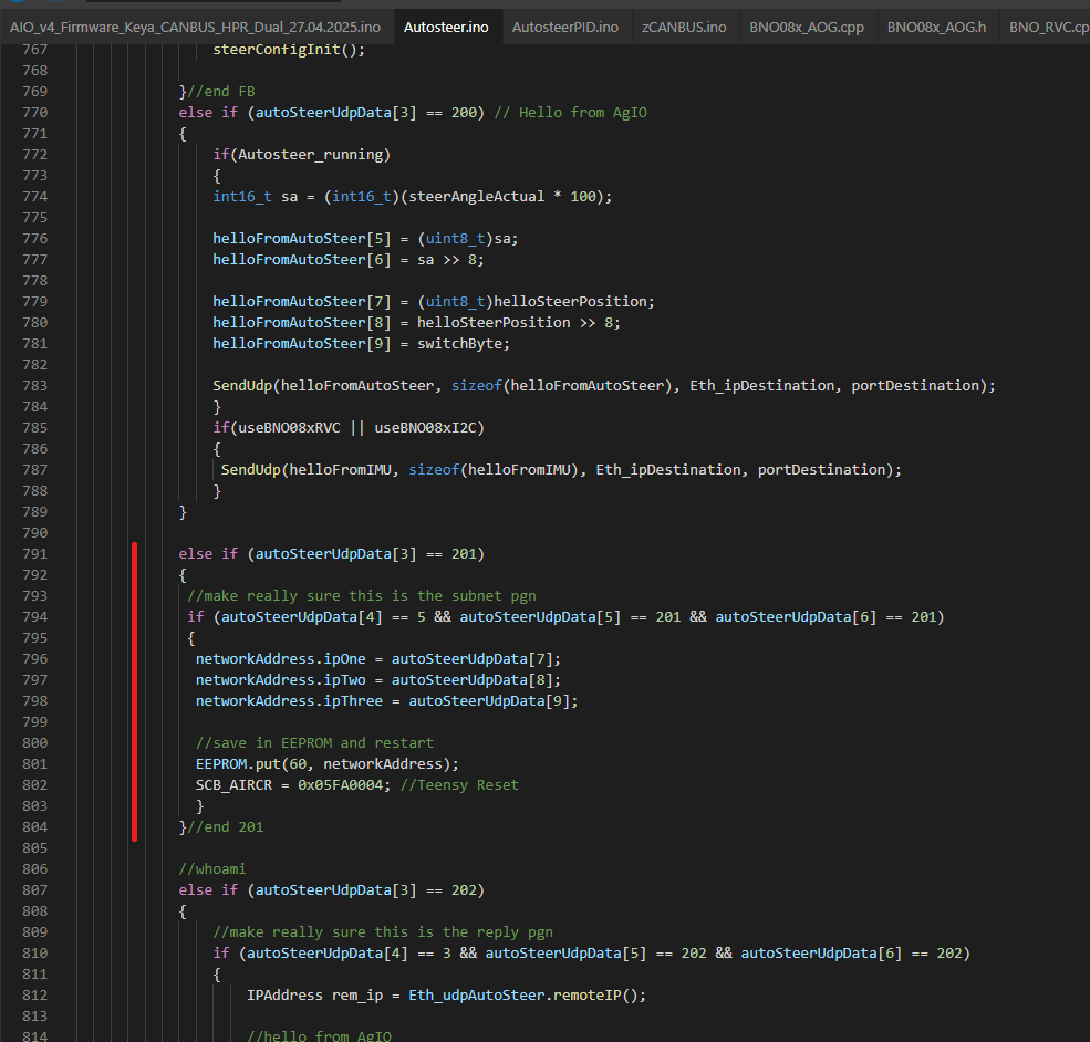

The way the DHCP code works presently is that it starts with the IP address stored in the variable Eth_myip which the comment in the code says is “set via AgIO”. The first IP addressed assigned via DHCP will be Eth_myip plus one. I don’t see any way in AgIO to set the IP address of the AIO board, but perhaps I just missed it.
It looks to me like the machine board uses 192.168.5.50 as its IP address by default? I think eventually it would be ideal for the machine board to get its IP address via DHCP as well.
Let me know what you think is best. I am happy to adjust the code as needed.

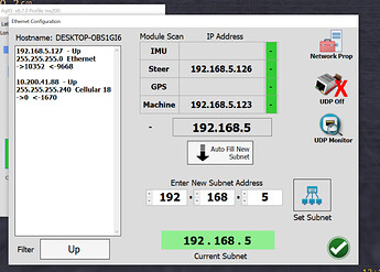

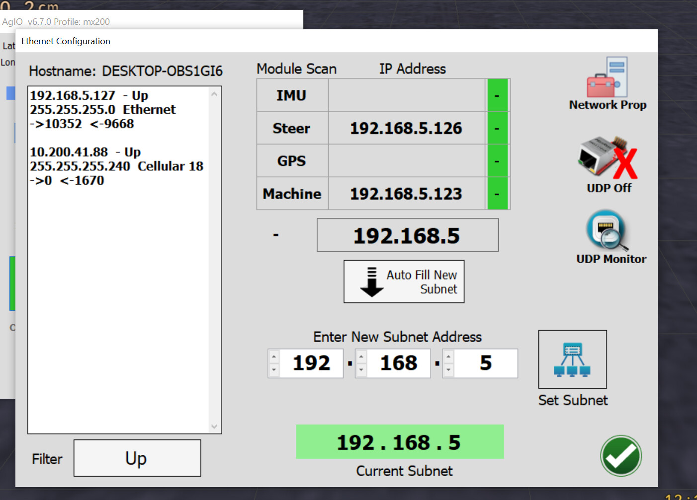

in post 9, the “set Subnet” button

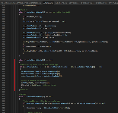

Here is in the firmware:
