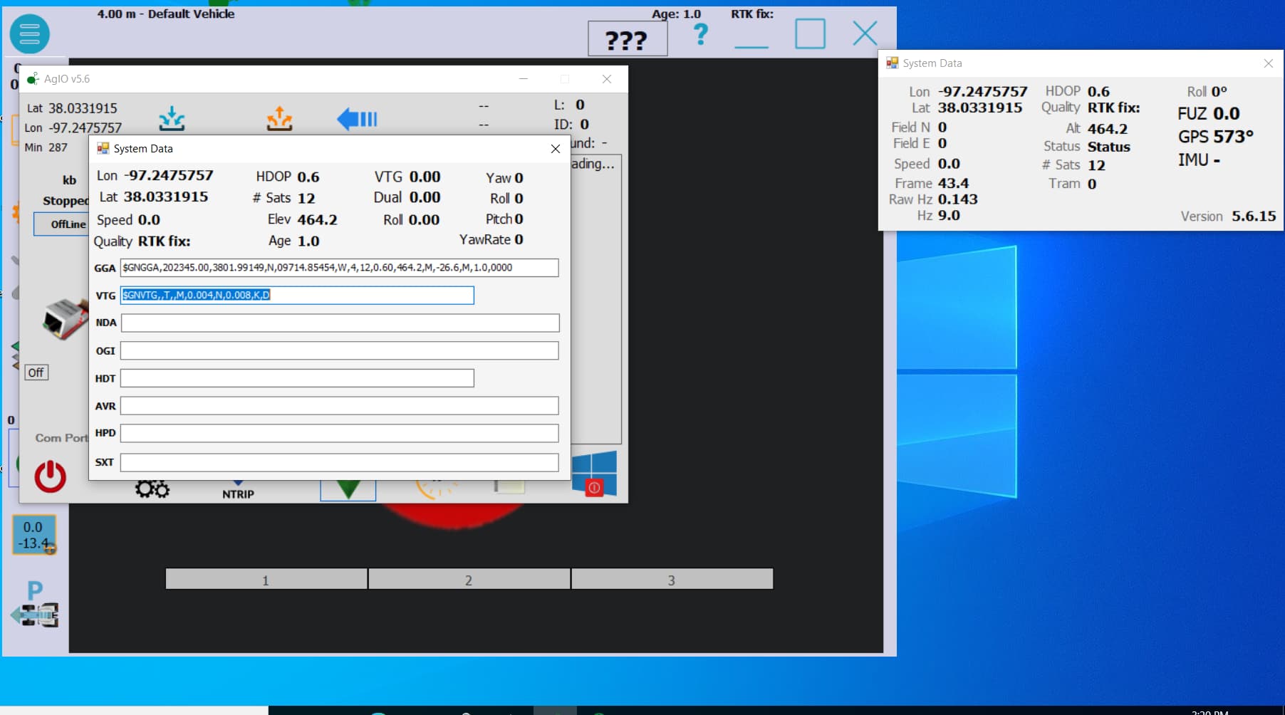

It comes up with the red circle/line through the location dot. The entire tractor/guidance screen is replaced by this. Its the same screen if you open AOG and turn your simulator off with no guidance hooked up. When it does work it says RTK fix in the upper right hand corner. Here’s a couple snapshots I took, upper picture is not working lower one is when it does work. Showing the GNSS information coming through the F9P.

I see your running 5.6.15 pre release.
Try 5.6.2 Stable release

Used the ‘correct’ AOG version and like magic no more dropout. I also noted the GNSS signal is updating much more often (signal age never gets above .8) and the signals are shown in AOG much faster. I do greatly appreciate the help! Would it be beneficial to report this into ‘bug’ category?
