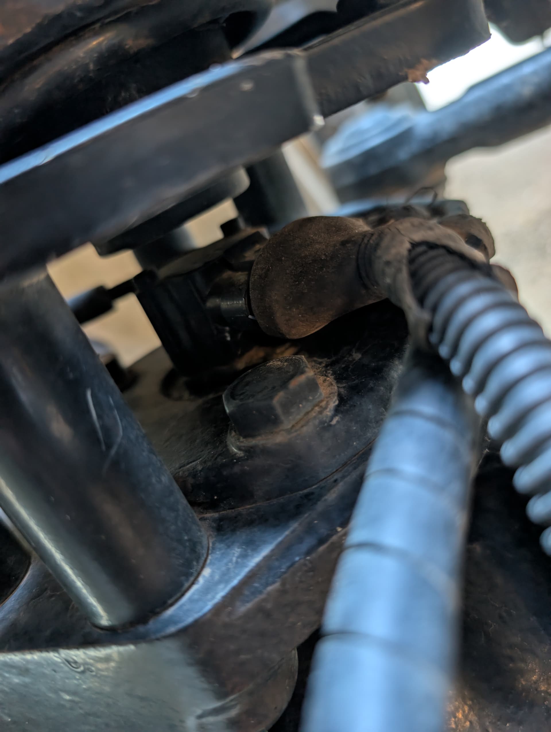

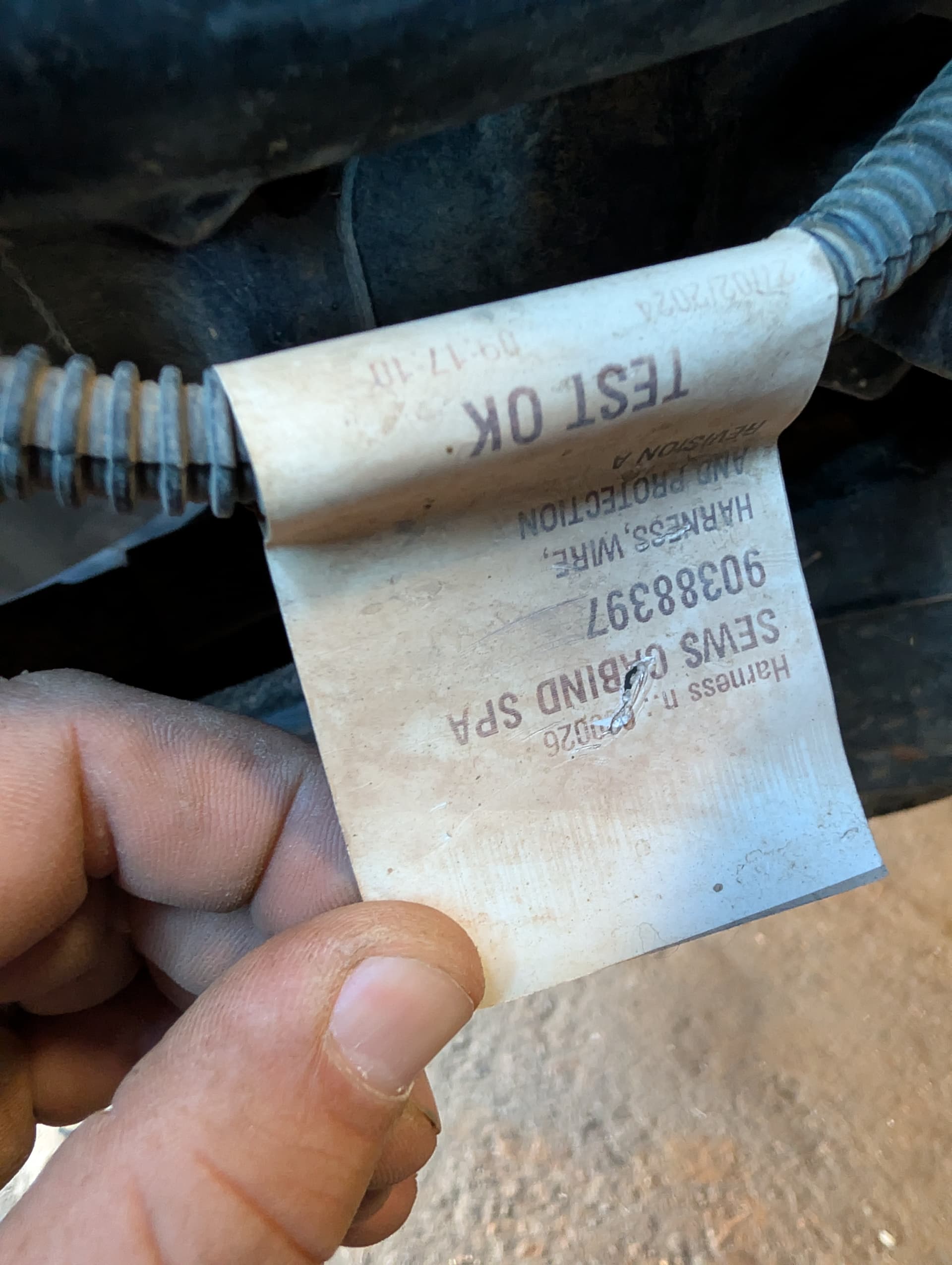

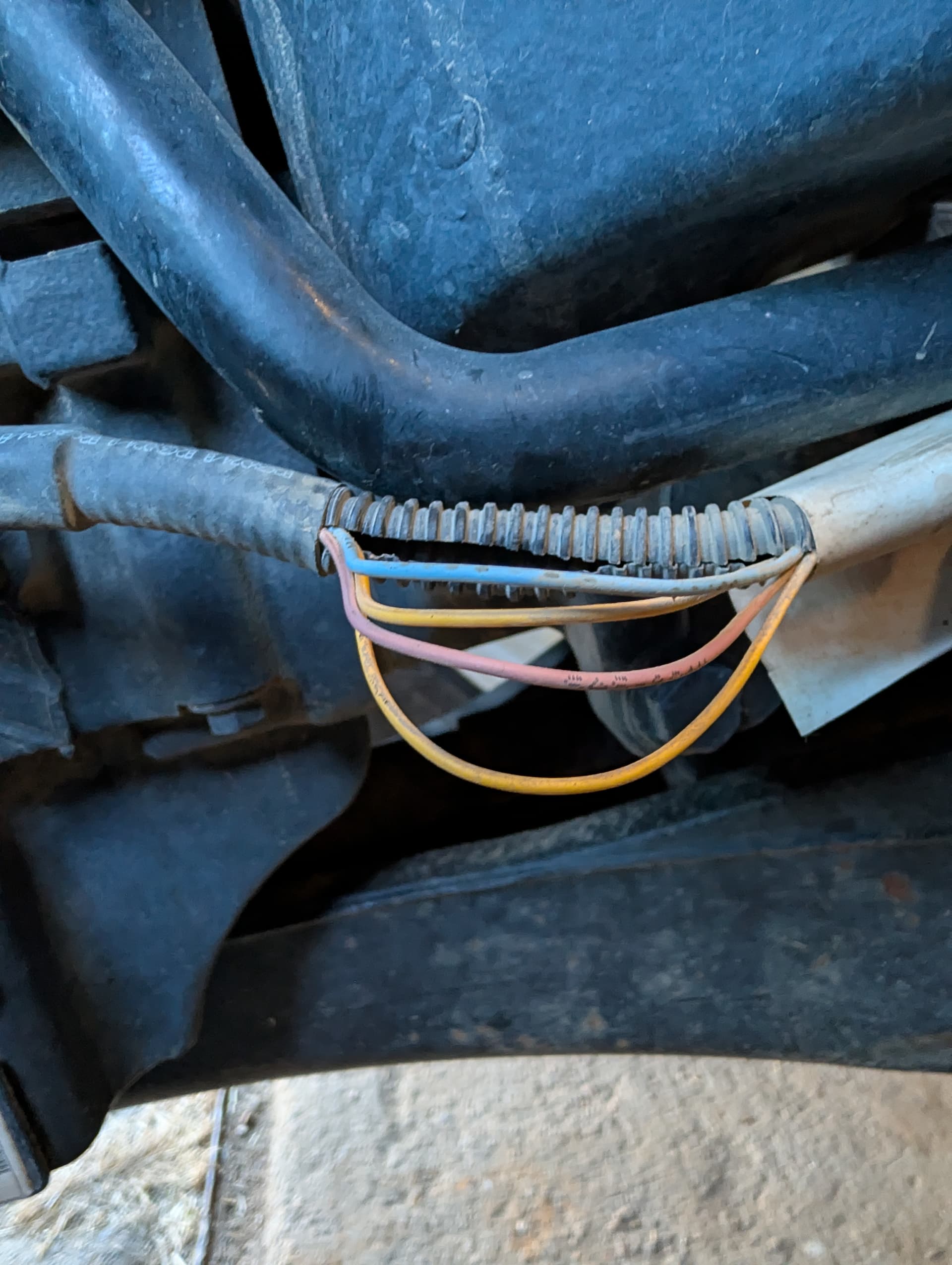

Tractor with wheel angle sensor
Hi guys I am just adding another agopen to another tractor but this tractor seems to have a was on it does anyone know if I can just tee of this wires to go to the agopen board ?
Yes but will depend on what type of sensor it is. I have wired into mine on a nh T6030 feeding 5v, earth and signal from my pcb. And sending the signal back to the tractor from disengaging diff lock or 4wd.
Check if its supplied with 5v, if so than you can. I did it on NH T6080 but sometimes agio doesnt recognize it and you dont get all green lights there, but restart helps.
