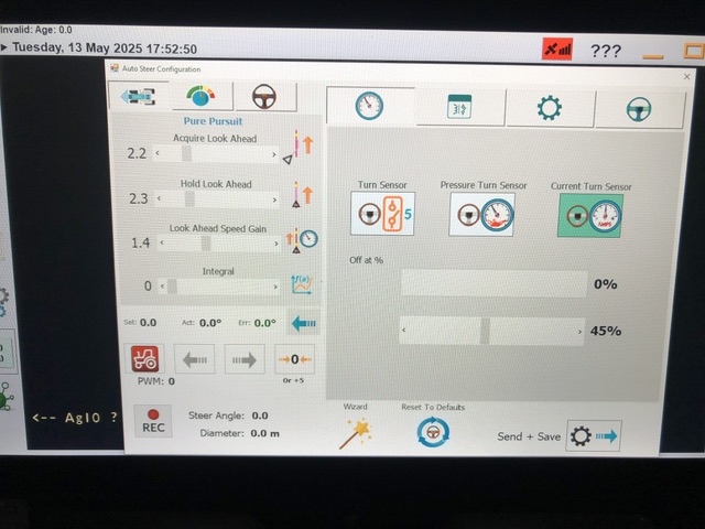

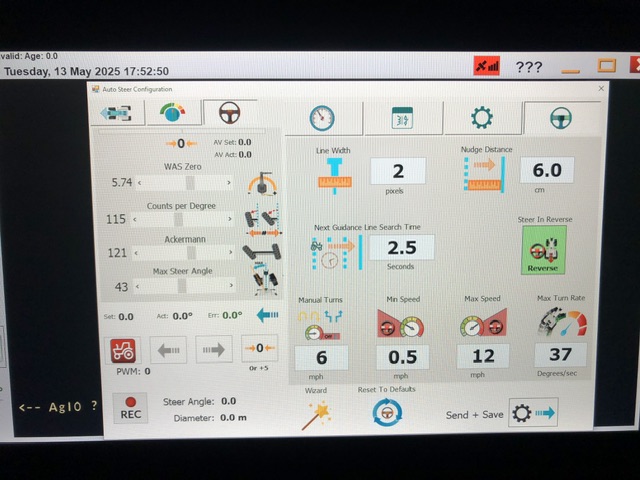

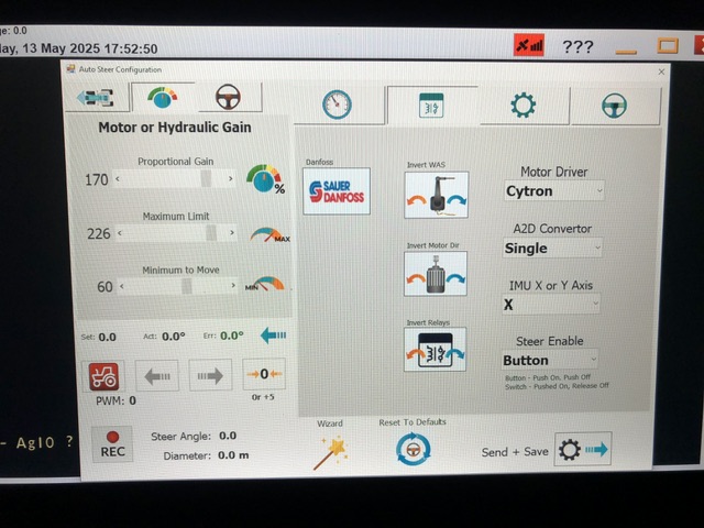

Here are my settings for an ez steer motor with AIO in a John Deere 8100 (similar ish size tractor).
I think the main difference is that my p gain is cranked wayyy up compared to yours and compared to most other setups. The ez steer is a slow motor and it needs that p gain to react.
I have my min to move set quite low for this motor because I like it to have a little dead spot around 0 xte. My ez steer “quite low” is much higher than for a phidgets motor.
Turn up minimum to move until the motor is (just barely) always moving. It should not be stopped half the time like in your video. The system is badly lagging in your video, you need to crank everything up. Once you have it working well you can back minimum to move down a hair just to stop the annoyance of the always moving.
It’s a slow motor. I can do U turns, but only if I slow down to ~5mph or less. No issues at all on straight lines and gentle curves.
