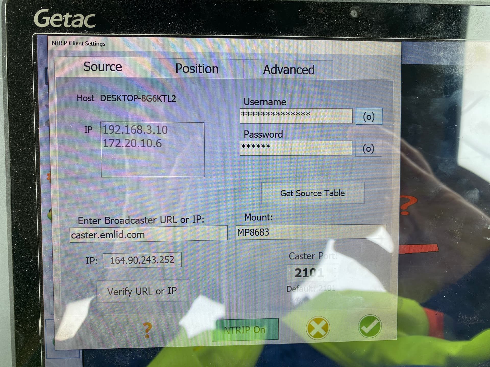

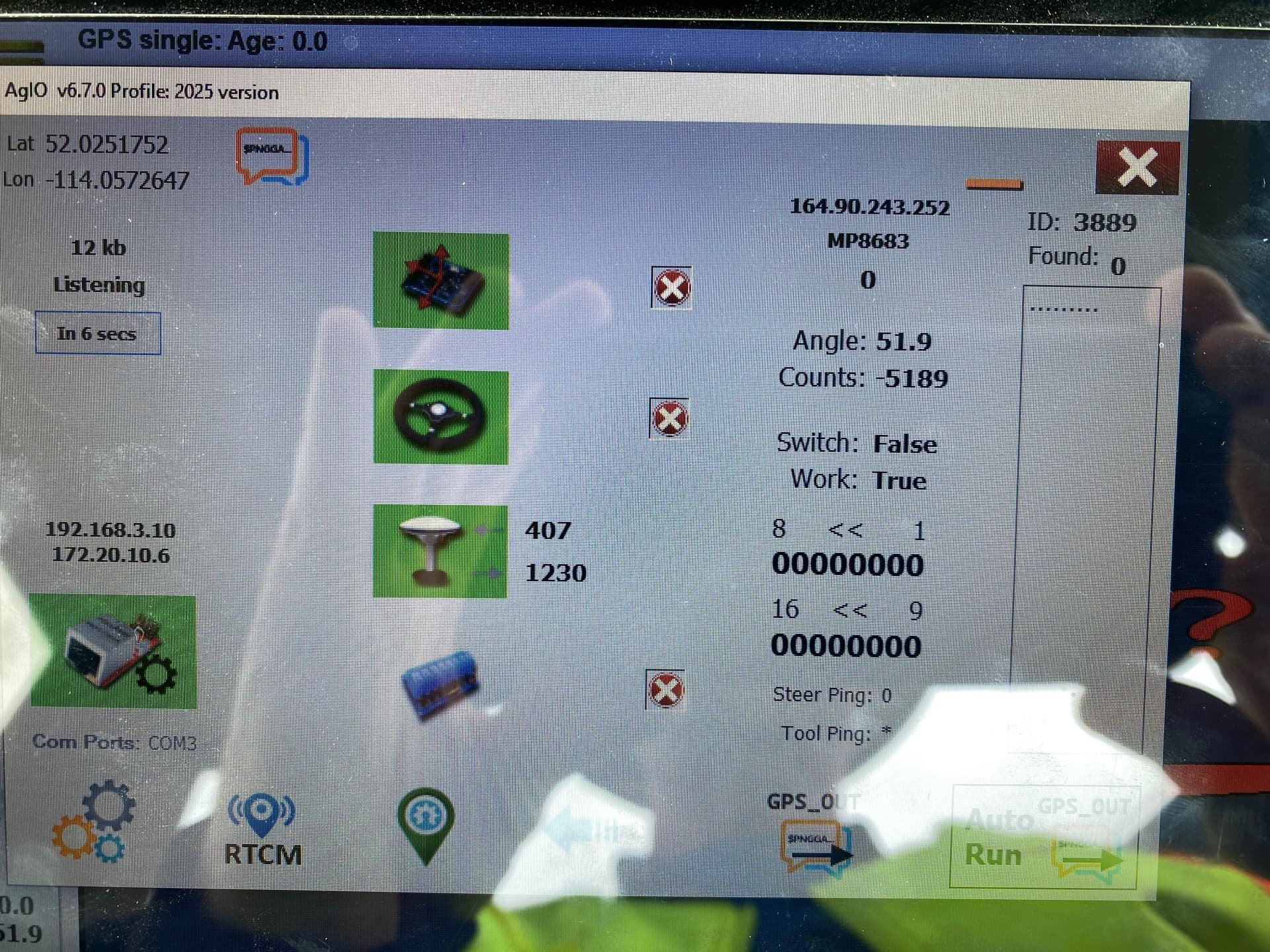

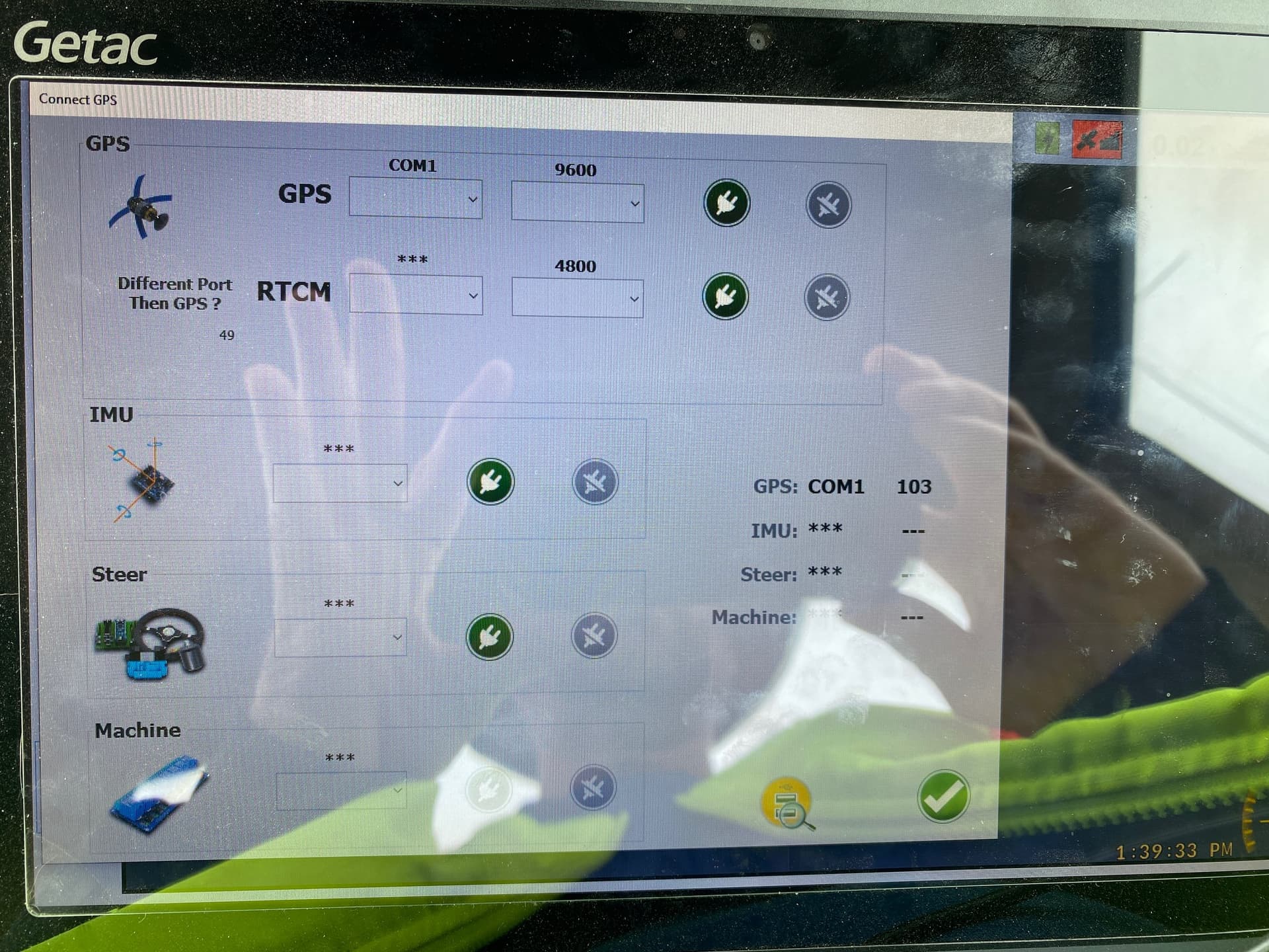

I have nothing showing in my NTRIP info box except dots. The top of my screen says “GPS Single”. I’m using an Emlid base station and have reset it once and upgraded its firmware. Any tips or guidance would be appreciated. Does anyone know how to confirm my user name and password are correct for my NTRIP?
Thanks for any suggestions.

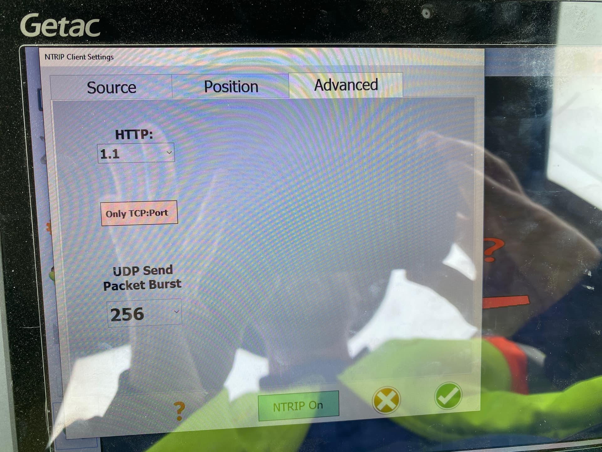

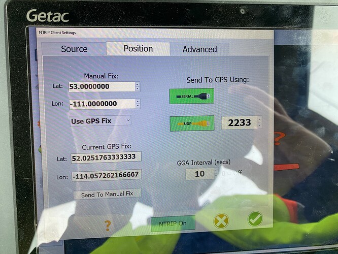

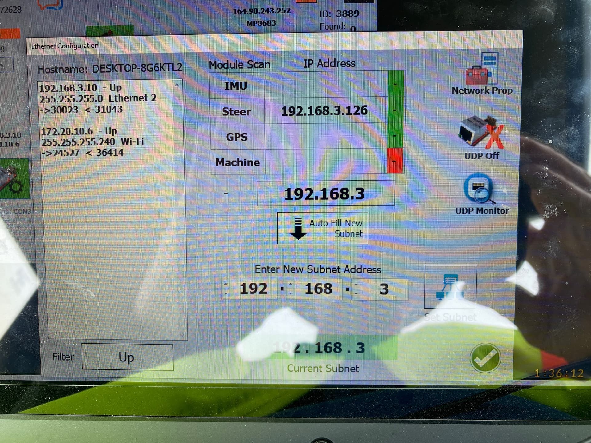

Select UDP in send, after that only one of those will be green (usb /UDP)

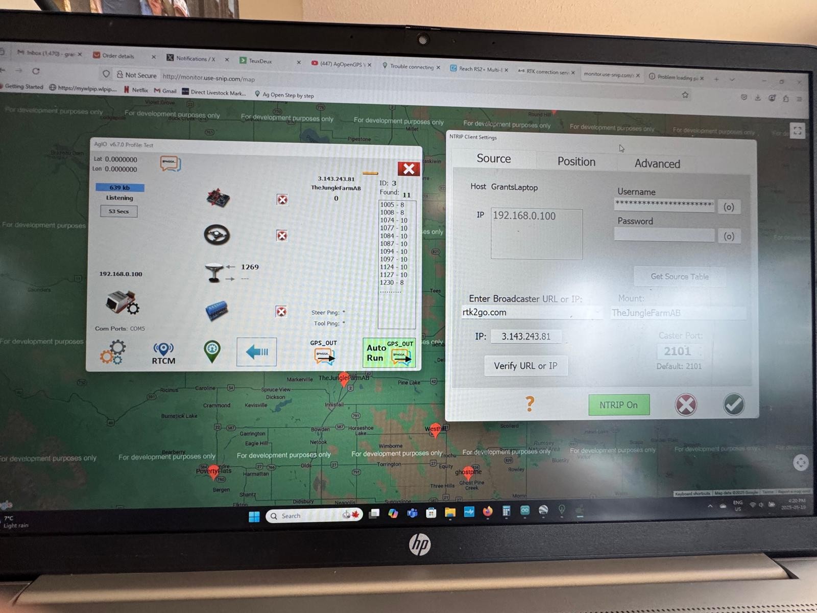

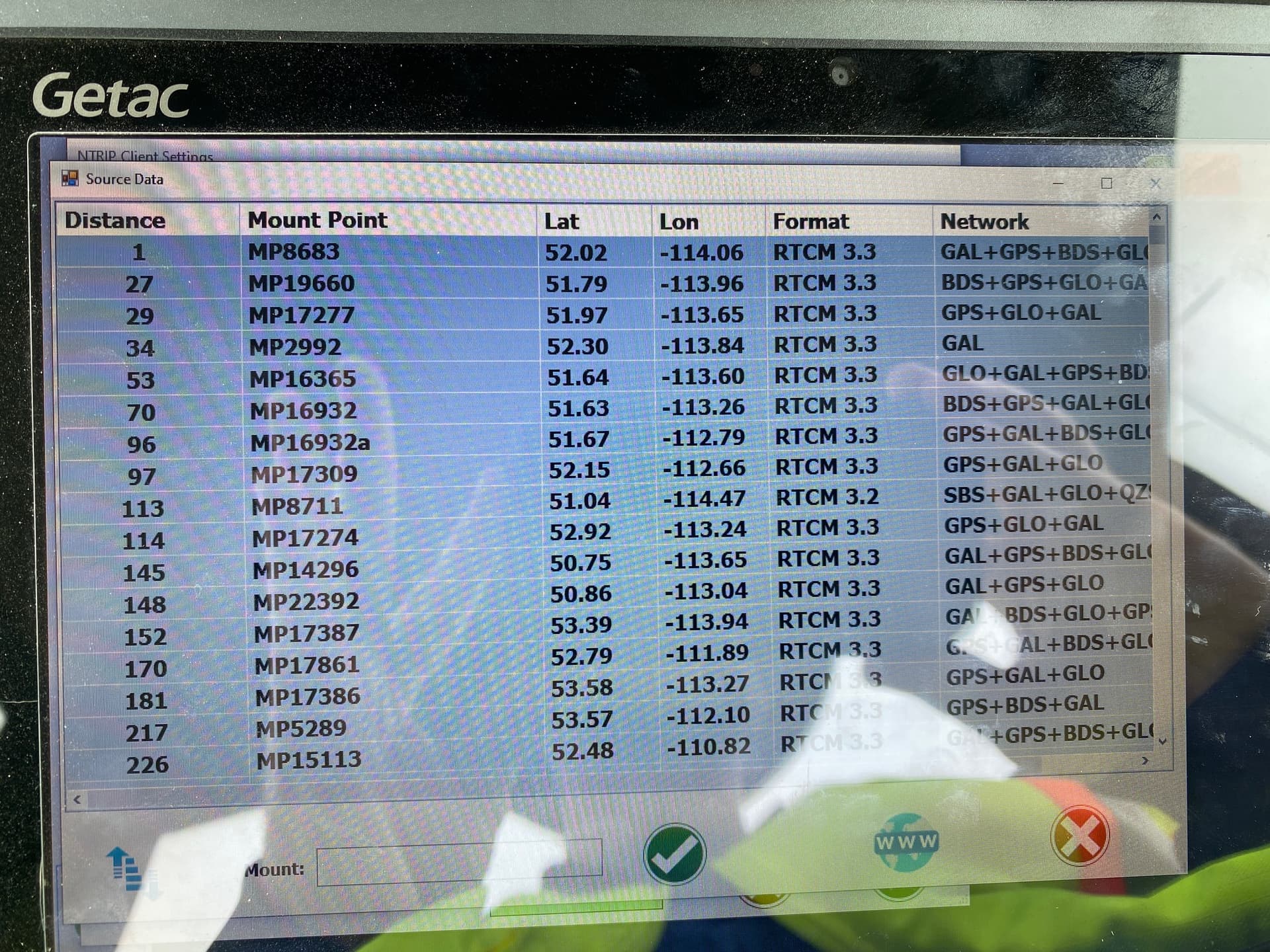

try connecting to the Jungle Farms caster just down the road from you. Yesterday I could not get them to communicate this afternoon no problem. I had to manually find the profile because I cannot get my source table to look locally. I still don’t know why. Could it be because I’m in demo mode on a lab top and not hooked up to the GPS receiver ? I am also in Central AB.
Here is a list of casters, click view all on the map for a list. This isnt a solution but a exercise to check for other possible problems
I changed the UDP to be the only one sending.
I couldn’t connect to TheJungleFarmAB (they weren’t in the table and manually entering them didn’t get me any results).

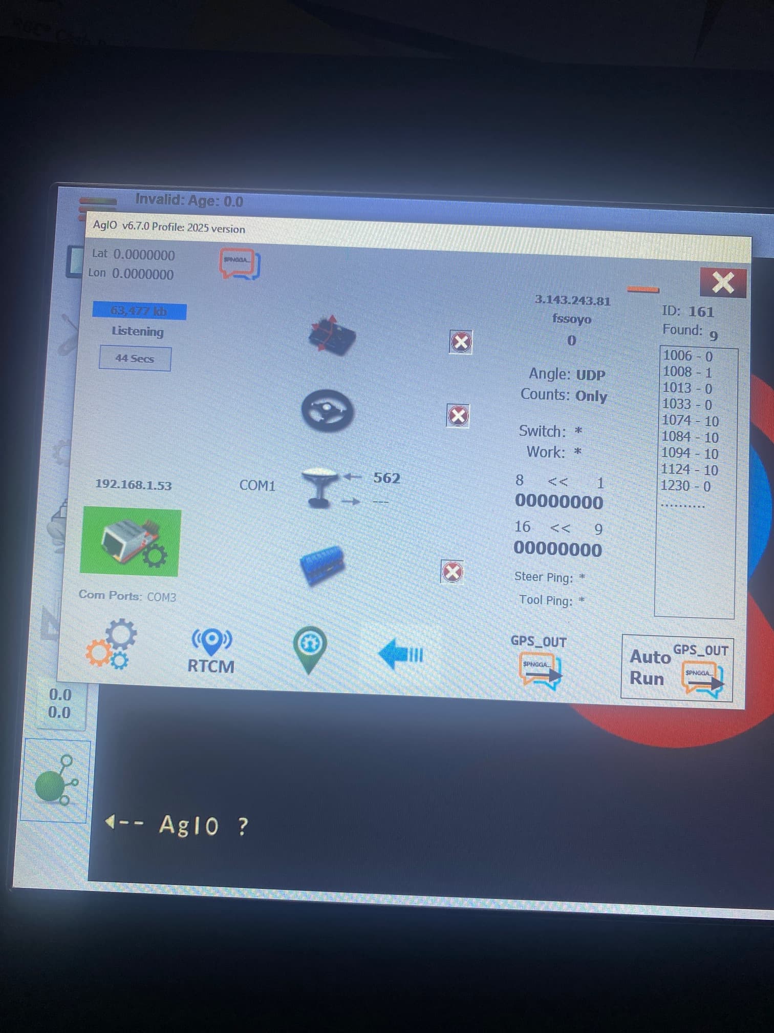

I picked “fssoyo” off the rtk2go table, as they were the top of the list, and now I have info in my NTRIP info box.
